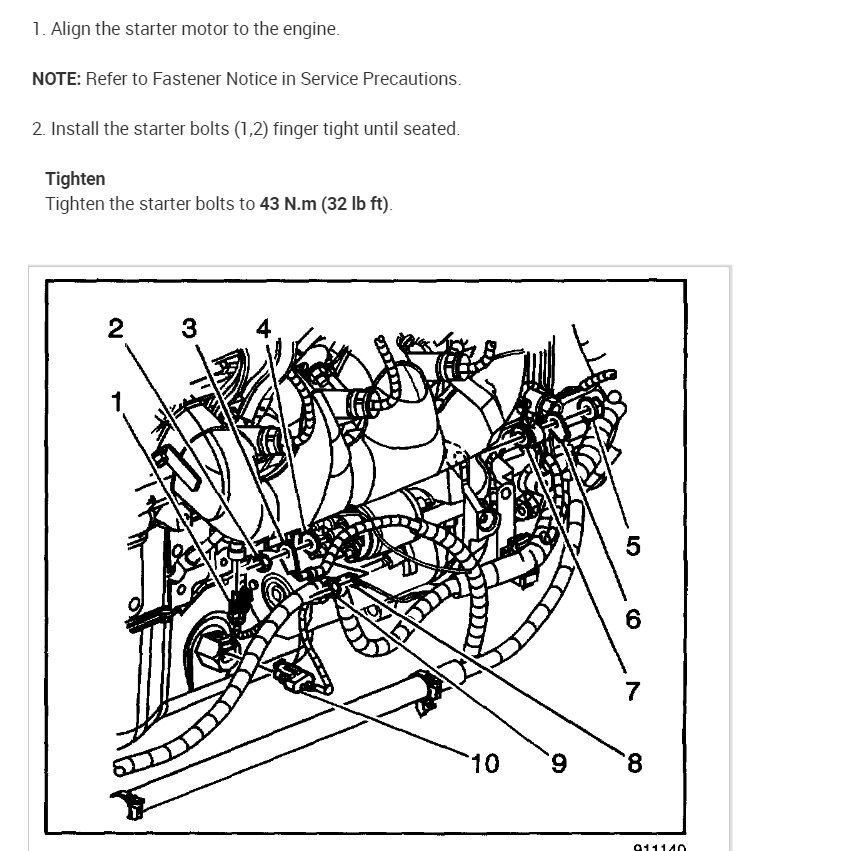

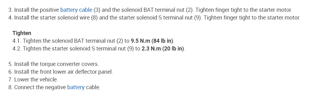

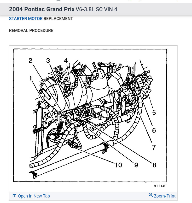

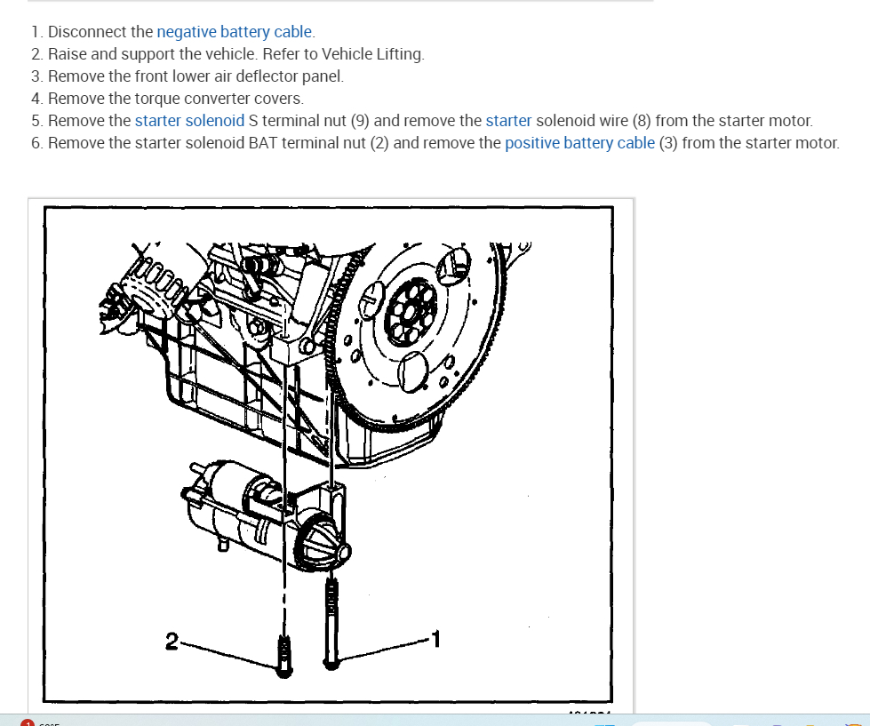

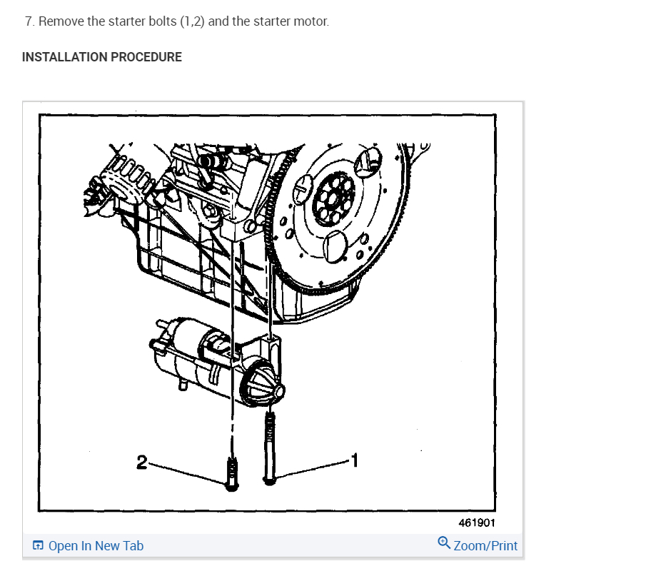

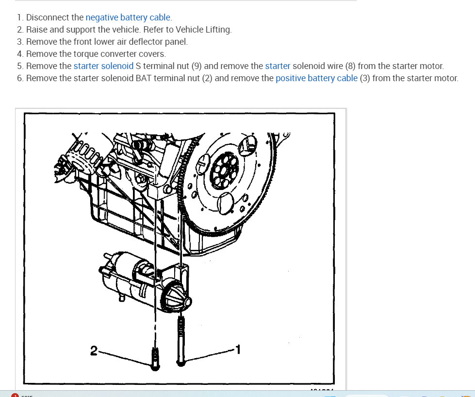

This looks like a classic bad starter motor which responds to more amperage which is why it works when another battery jump is added. to be sure you can use a test light on the starter trigger wire and if it lights up when the key is turned to the start position you know for sure the starter is no good, this guide can help, and I have added how to change the starter motor out in the images below.

I am here with an update. I bought a new starter and installed it. Car started right up and has started every time since. Amazing.
Thank you, Ken, and thank you to 2CarPros.com.
