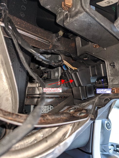

I've got a picture of what I'm describing. Hopefully this helps. Let me know if you'd still like a video.

Okay. That is great. Also to confirm, this is what you replaced correct?
If so, we need to remove those connectors and inspect each of the terminals for any spread terminals? Basically you simply visually inspect them and then do a drag test using a wiring test kit? You insert this test terminal in the female terminals and make sure you feel drag on each one. If not, you need to replace that terminal or connector.

That is what I replaced, yes. So you think the issue is in the harness that connects to the ignition switch? I will add that the ignition switch feels loose when it is clipped into position, as shown in the picture. Also it feels looser when it is warmer outside than when it is cooler.
I have never done a drag test before and dont have a wiring test kit, but it makes sense. What is the wiring harness above the ignition switch? It seems to attach to the lock cylinder.
When I removed the original ignition switch, a plastic plunger (my word) and a spring fell out of the back of the lock cylinder. I was able to replace them correctly but could the heat be causing a bad connection between the spring or plunger and the ignition switch body?

Absolutely. With that information, I suspect you are exactly correct. That changes what I am thinking as far as a connector issue so I don't think the drag test is needed.
The fact that this happens when it gets hot tells me that the contacts that are the issue is expanding and you pressing on it re-establishes the connection.

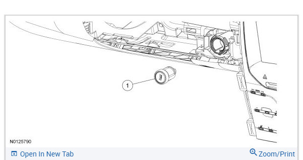

What I would suggest is try to narrow it down by pressing in very specific locations to see if you can find one connector or even wire. You may have to lay on the floor and look up behind there and have someone else operate the key just to see if you can isolate the issue. Again, when you say you replaced the switch, was it the actual key cylinder shown below or the black box that you are pointing to in that picture with the electrical connector?

I replaced the black box with the arrows pointing to it. I didn't do anything with the key cylinder.

The shop thinks that it is the ignition lock cylinder housing. They think it is loose which creates a loose connection between the ignition switch and the plunger/actuator. I'll try to remember to provide an update after I get it back and have a few days to test it out.
