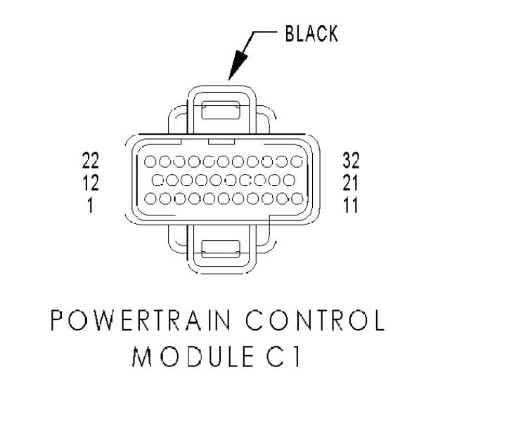

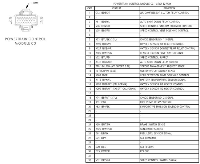

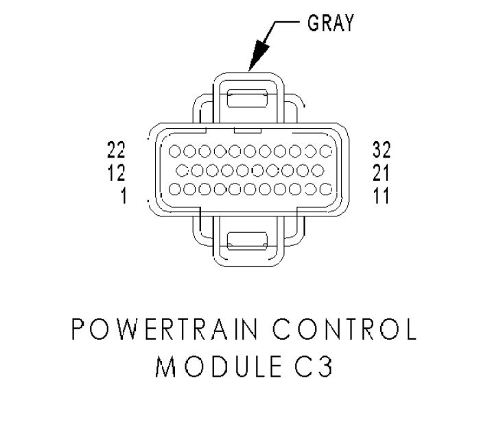

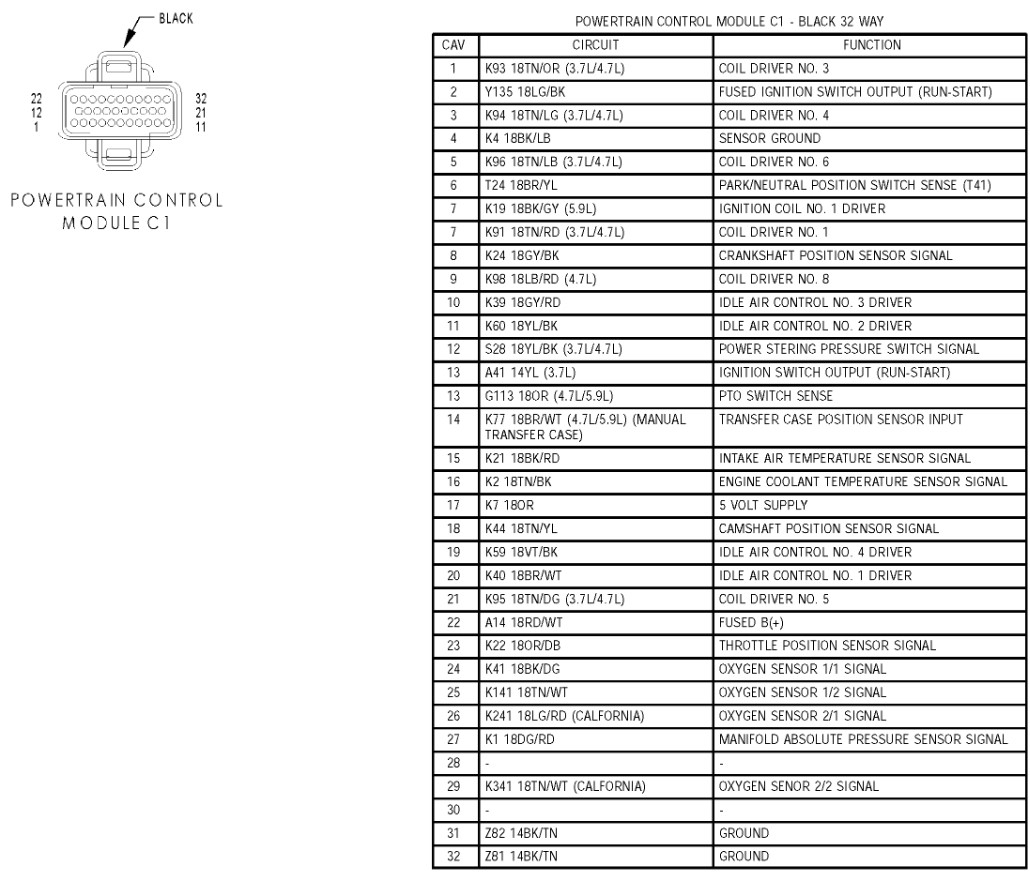

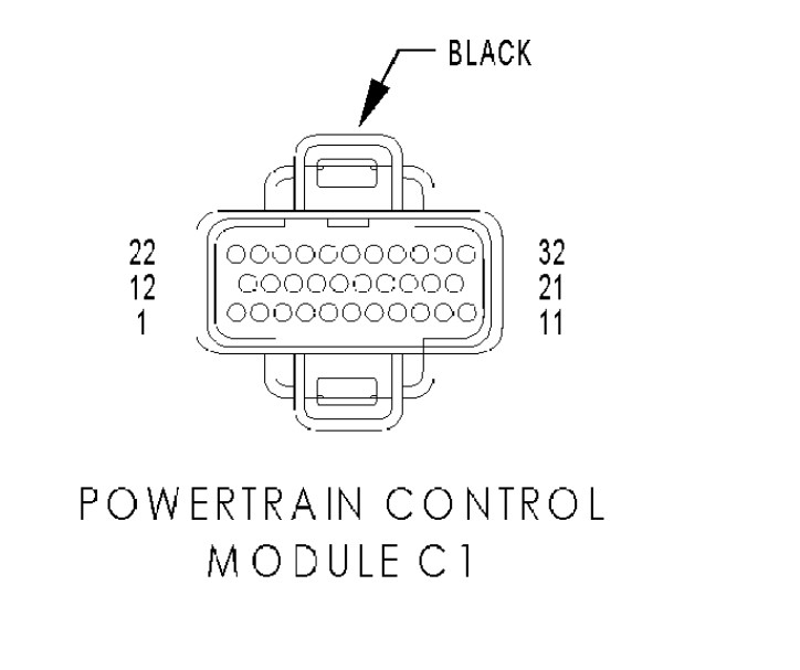

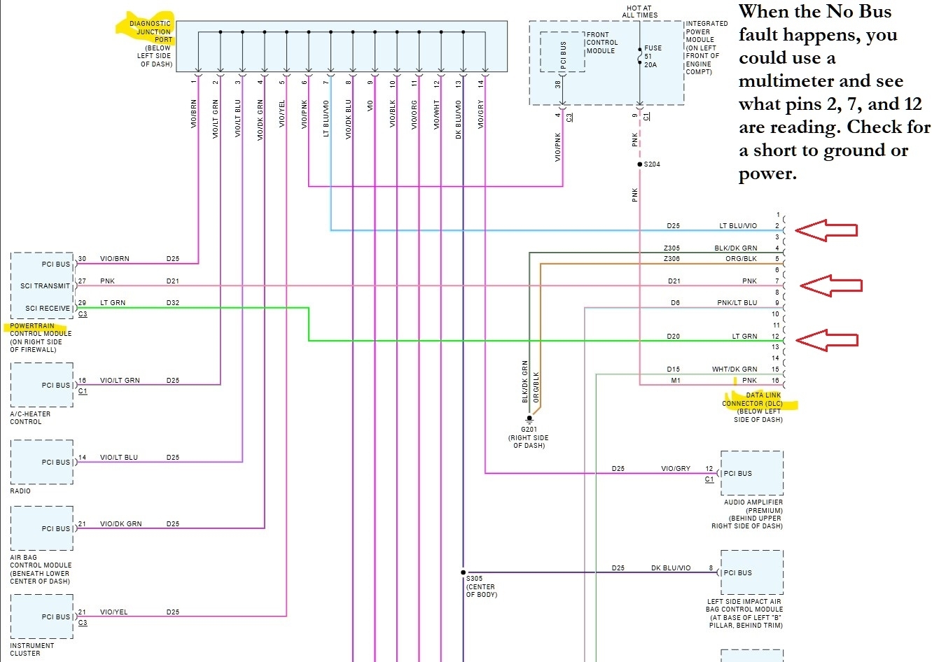

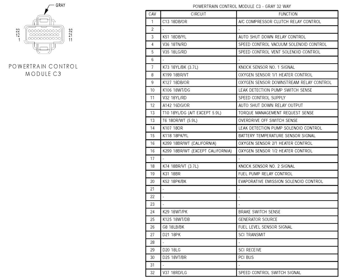

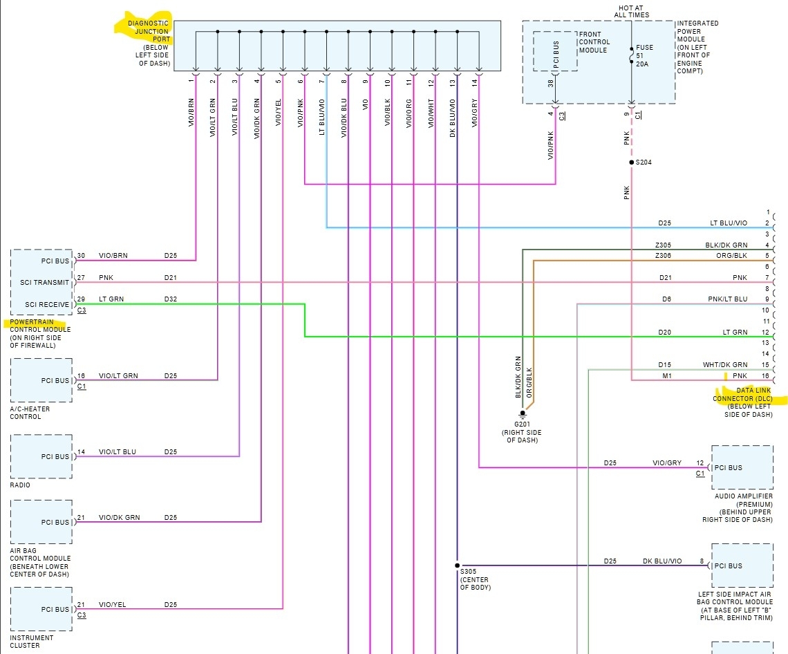

I have an intermittent no bus issue that stops me from getting fire to the coil packs. can i get the pin out for the PCM connections?

Hello, yup we can provide that, do you want the entire Powertrain diagram set?
Apr 11, 2025 at 3:50 AM
AL514
  • 5,610 POSTS

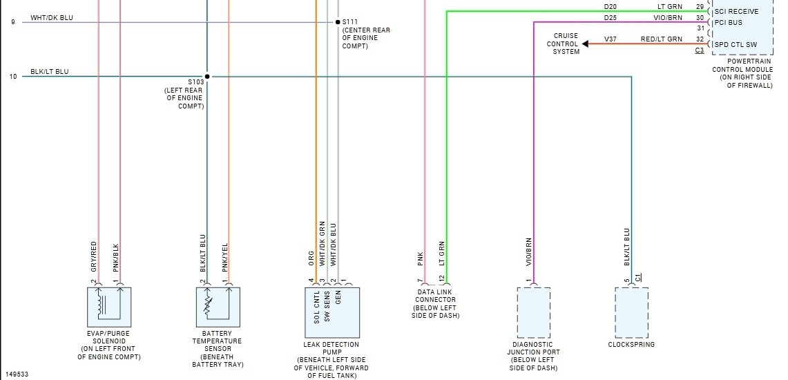

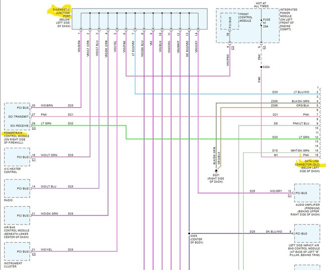

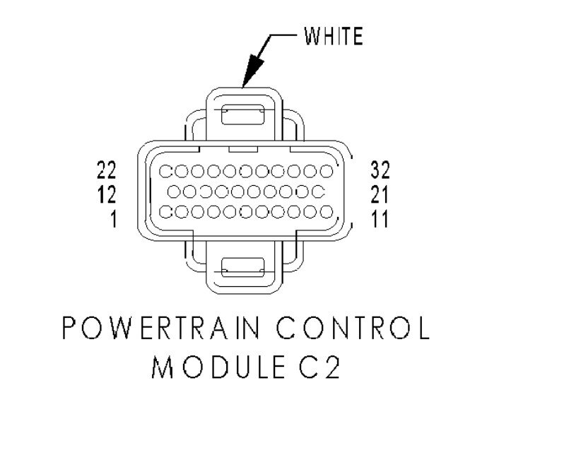

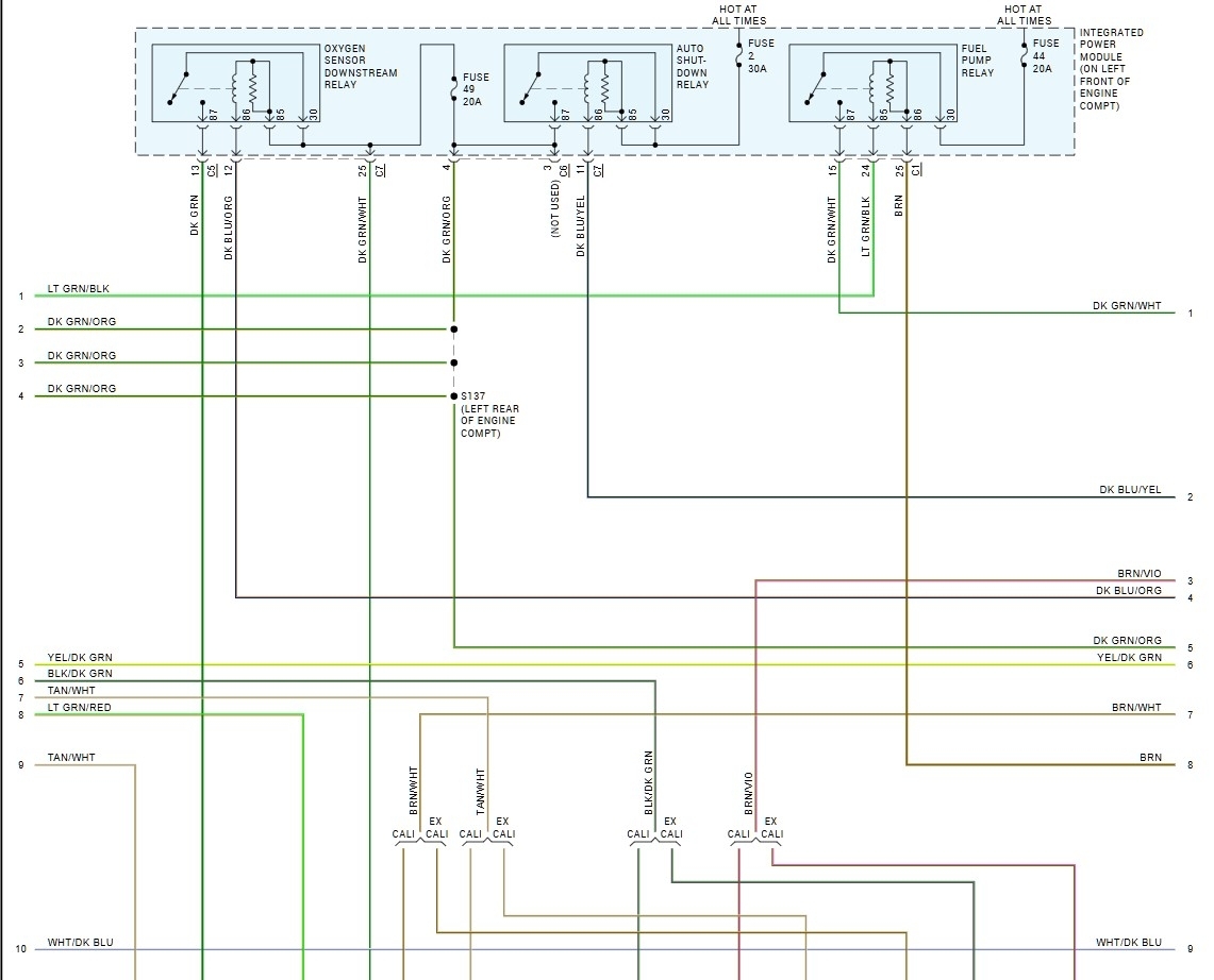

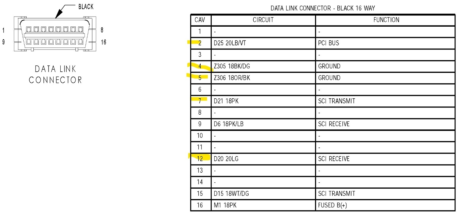

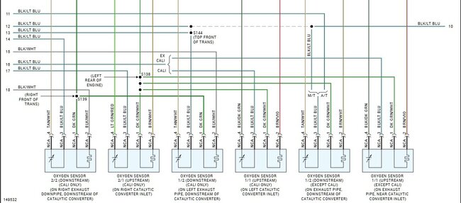

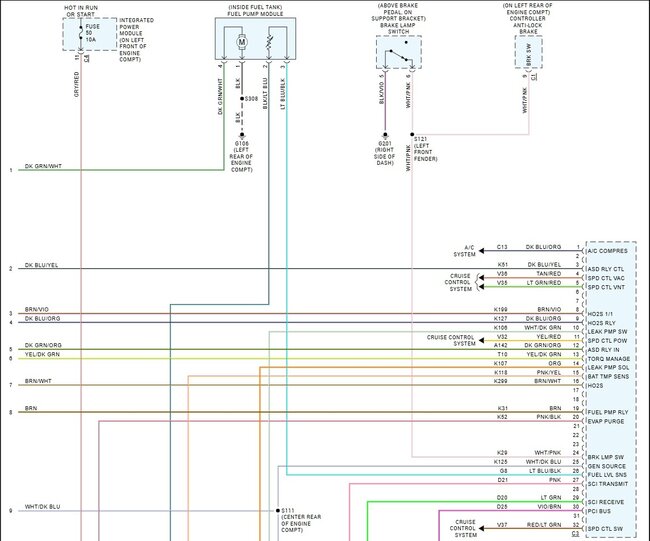

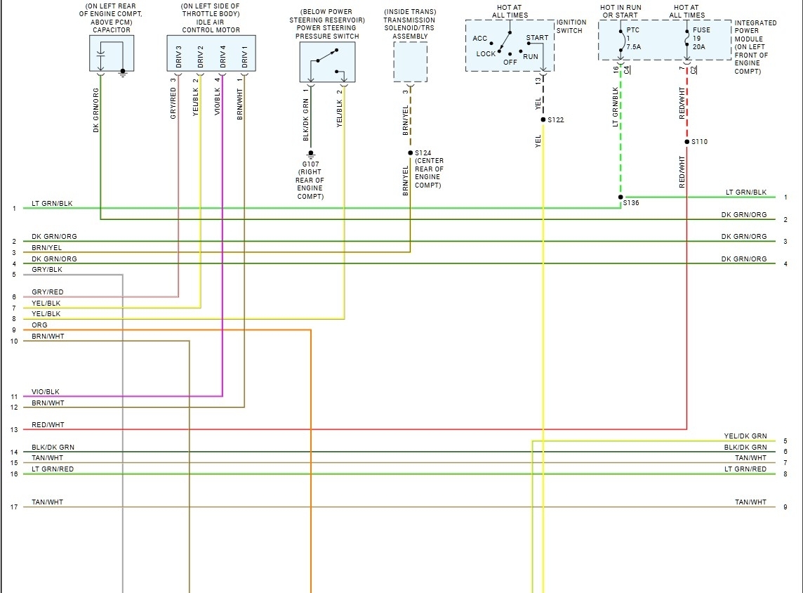

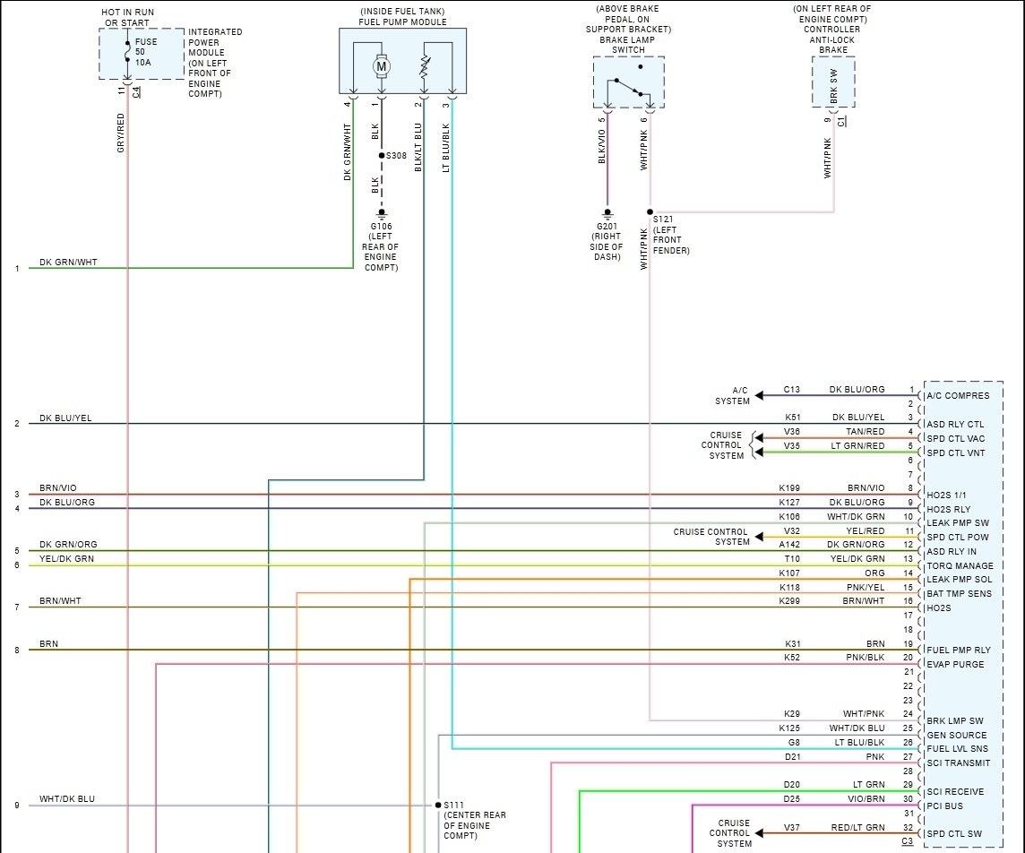

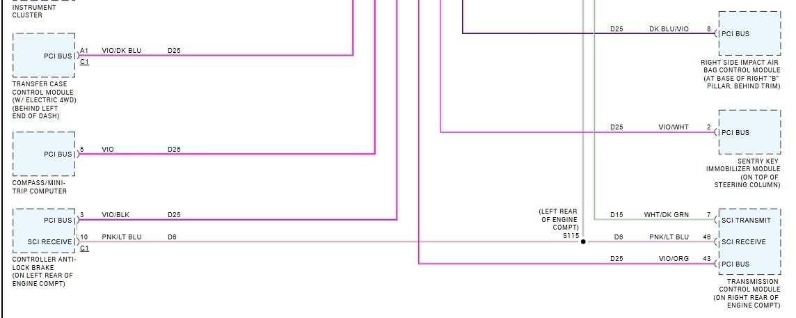

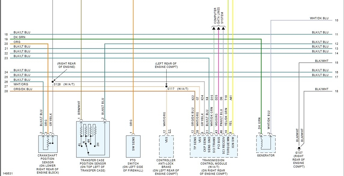

Here are the network (Data Bus) diagrams (1,2), the PCM connectors and pinouts. And I'll post the PCM wiring next. But on diagrams 9 and 10 you could check at the Data Link Connector when the fault occurs for either a solid 12 or 0-volt reading, meaning a short to power or short to ground.
Apr 11, 2025 at 4:27 AM

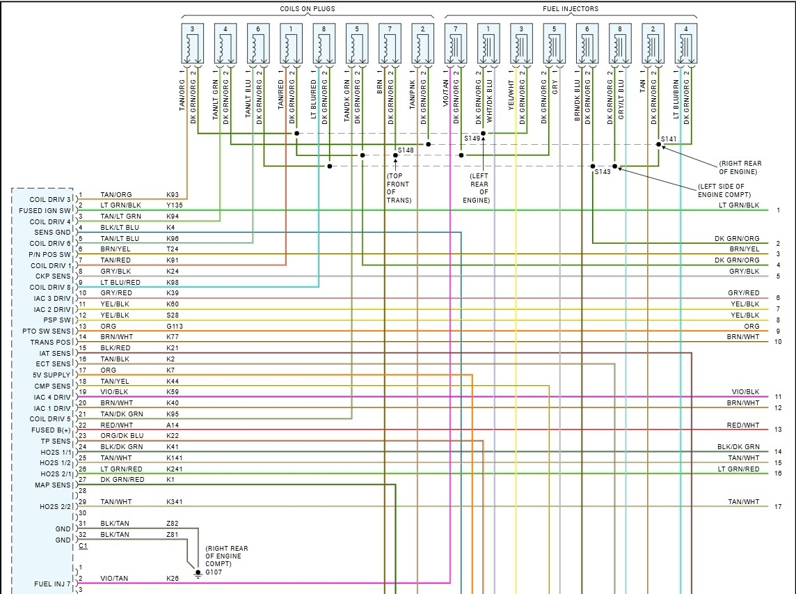

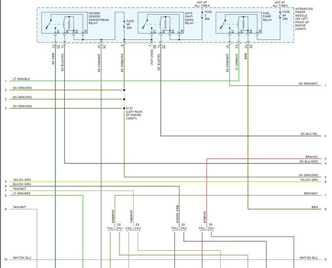

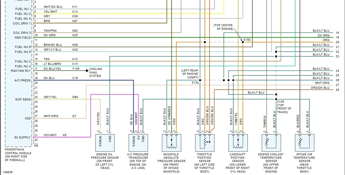

AL514
  • 5,610 POSTS

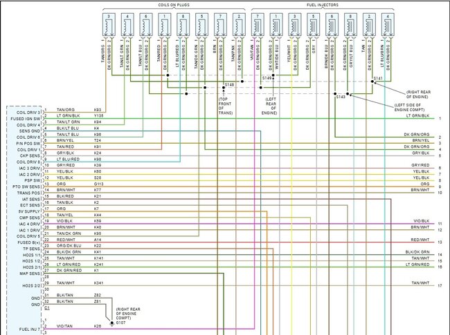

Here are the PCM wiring diagrams if needed, page 1 (diagram 1,2 top and bottom) and so on.

JAMES BERRY4
I have a intermittent no bus issue thats stoping me from getting fire to the coil packs can i get the pin out for the pcm connections

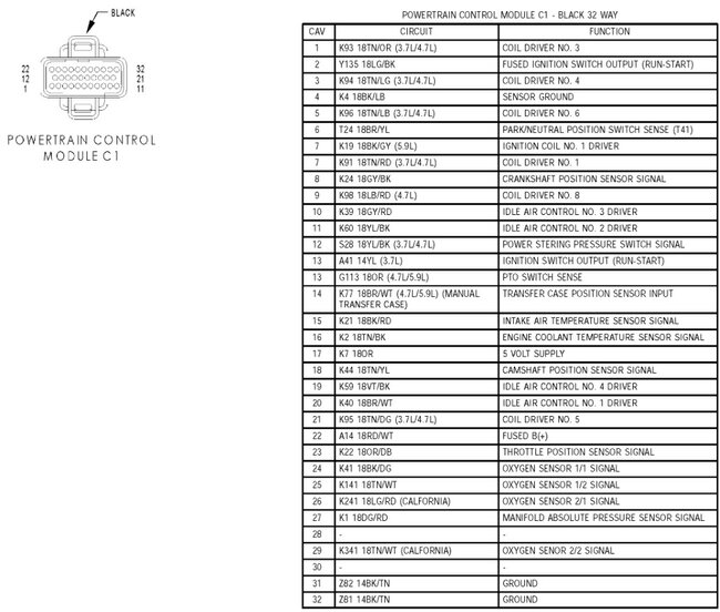

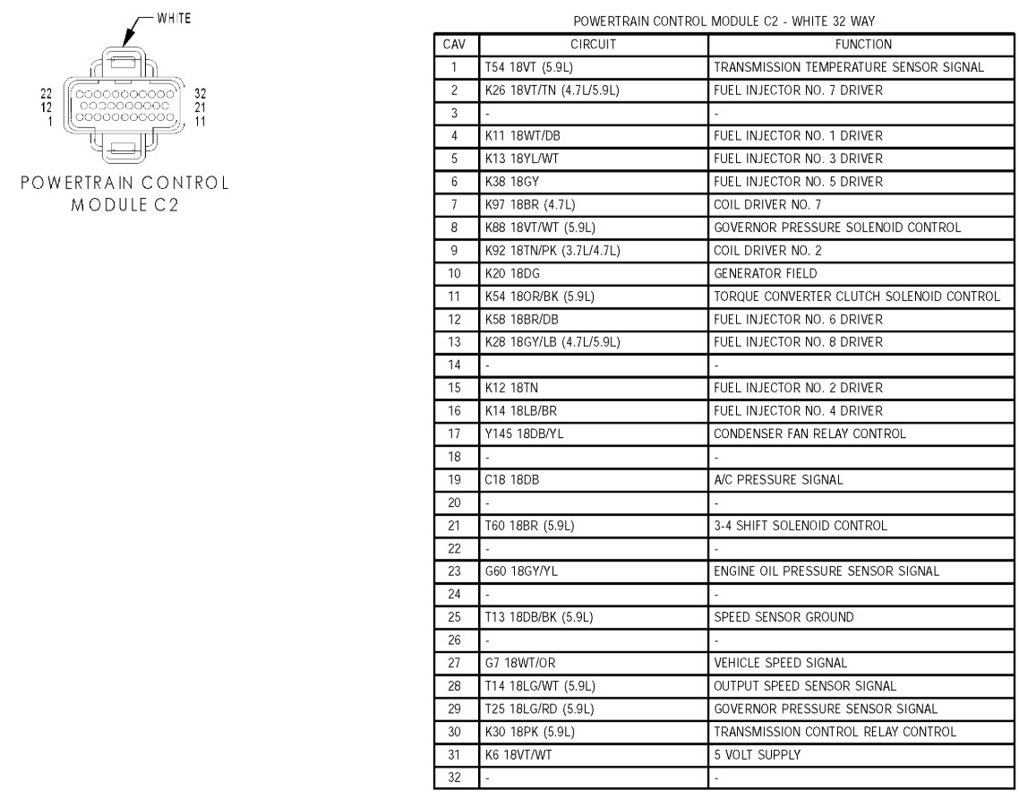

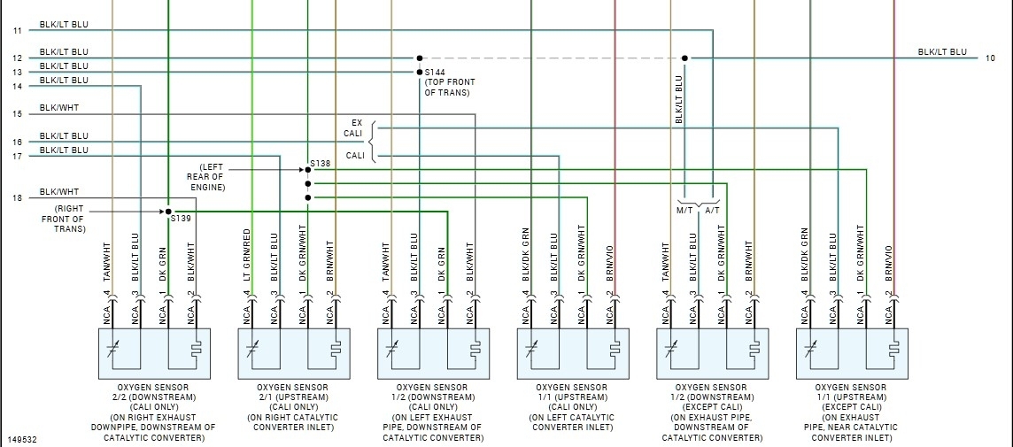

The PCM connector pinouts are in my 2nd post. Do you not see them?
Apr 14, 2025 at 2:03 AM
AL514
  • 5,610 POSTS
Here they are again.
