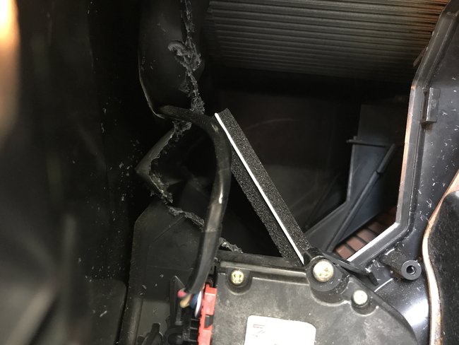

I do not have the kind of equipment to check the pressures, but I will have my mechanic check it since they did the original repair. I just put in the new blend door and the motor moves it all the way down (full cold) but not all the way up (full hot; see attached picture). Is it supposed to stop there?

It could it would still have air flow the fact that it only does it with the AC on after long time on tells us the evaporator is icing up. What happen to the heater box? Looks like you did a modification?

The only thing I have done is cut open the plastic to get to the blend door. So the blend door is supposed to stop only three quarters of the way up when the temperature knob is turned all the way to the hot side?

If the system is auto air then yes the blend door will go to the position and then adjust while in operation. It will not cause low air flow. The tube should be at the fire wall down low on the passenger's side.

That is a manual system so the door should go all the way over. Can you remove the blend door actuator to see if you can move the door by hand?

It moves fine by hand and will go all the way up; got a new actuator on the way.

New actuator is on and it takes the door further up. Of course, now it’s too cold to need the AC but I’ll get the pressures checked this week.
