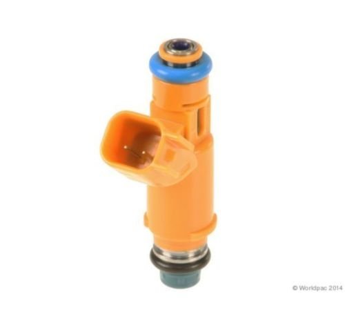

Installed a check valve in the fuel line a couple nights ago. Next day a little hesitation before starting. This evening, I got home from work at 5:30 and had to leave for an appt at 6, cranked it for about 10 seconds twice in a row, no indication it was even attempting to fire, jumped out and took a different vehicle. Came back 4 hrs later, jumped in and it fired right up, no hesitation whatsoever. Does that sound like injectors still? First time I've ever had an issue on a warm start. I did only drive the car a couple of miles home from work though. Can I just replace the upper and lower orings to resolve or is there more I need to do? The orings are stupid expensive! Any one know of a cheap place to get them if that's what I need?

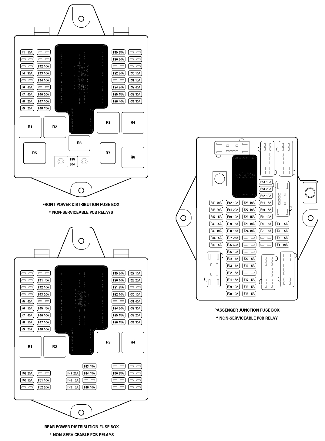

Have you tried a different pump relay? Your initial post doesn't mention it but an intermittent relay could cause the pump to run then not run on initial start.
Should be R6 in the front relay box.
That car also uses the same pump control system that Ford used on many other vehicles, it varies the pump output pressure by switching the pump on/off rapidly. If it was failing it may not get the "start up" signal or not respond to it.
I would try the relay first, it's cheap and easy.

The relay is a common one should have a part number right on it. Injectors wouldn't cause this issue. Each one is driven by a different control transistor so they would all have to fail at once to cause a no start, and they wouldn't repair themselves.
