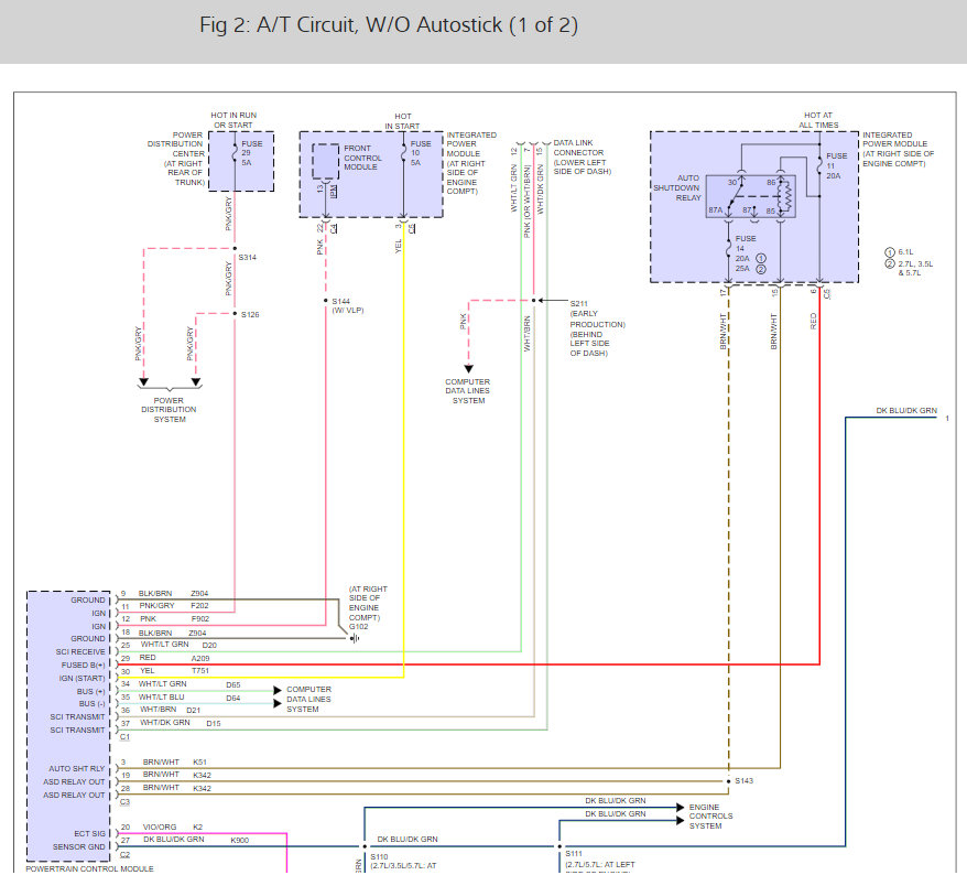

The computer sometimes when it is hot outside will not send voltage to the electronic relay Which send voltage to the solenoid pack and voltage back to the PCM. When I push in and out the c4 connector I restore the voltage and the transmission shifts what could be the problem.

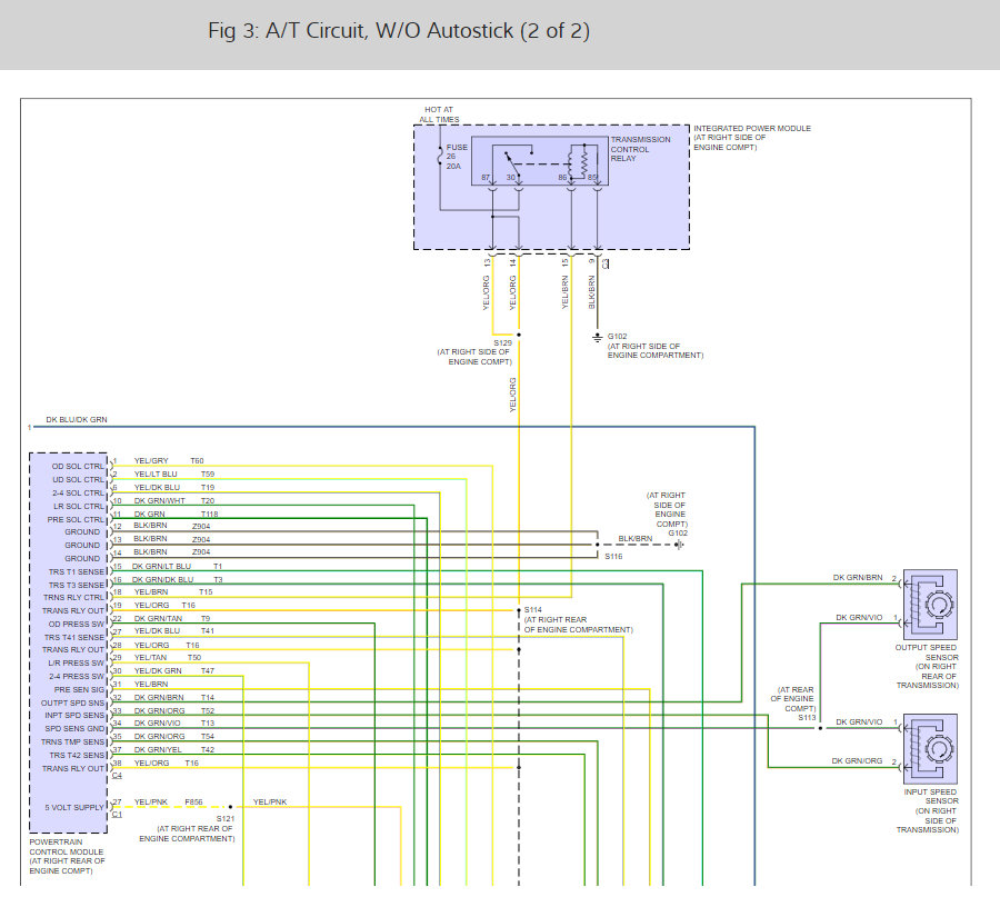

The code is p0882. It send voltage to electronic relay in the TIPM. The relay is transmission relay when I wiggle the far right connector I see voltage on the control relay wire and the car shifts normally after I turn it off and let it seat for a while after start the car it will not shift and the voltage is missing on the control relay wire.

It is the PCM connector I am talking about precisely number 4 what I heard is the one for the TCM.

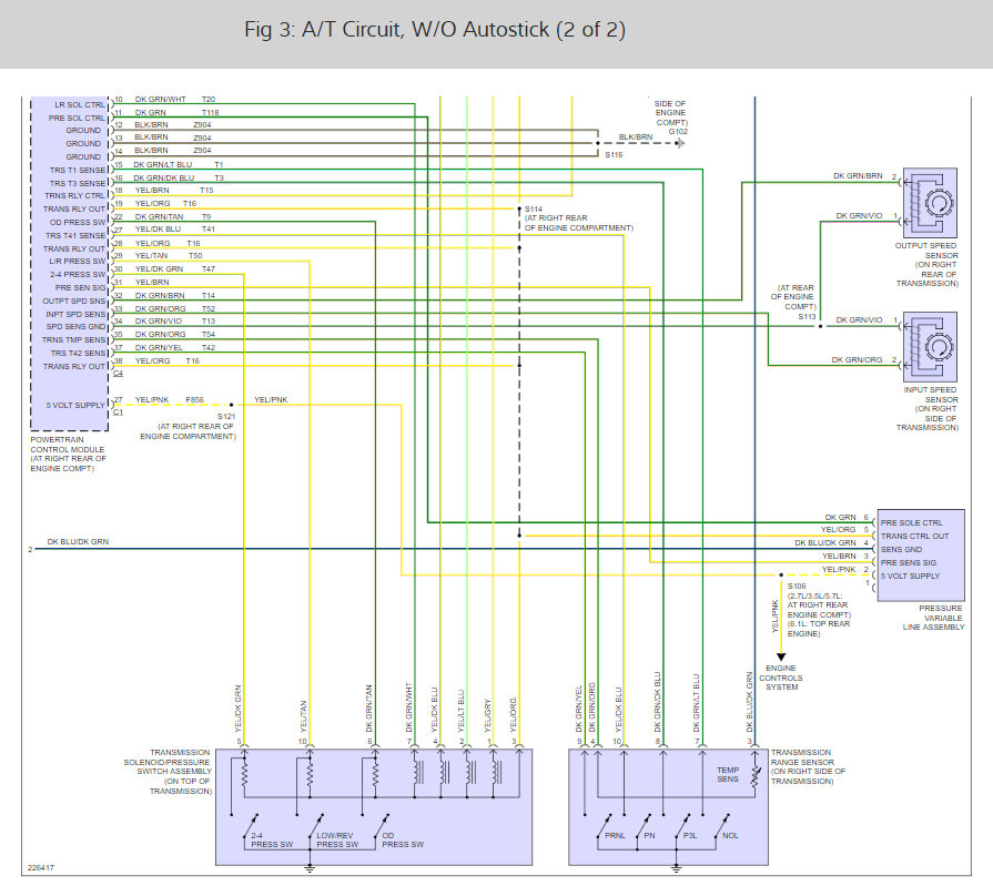

I replaced connector same problem, however when I unplugged the the transmission range sensor the TCM sent voltage to the transmission aka solenoid pack but the car did not start. How to make sure it is the TRS the culprit?
Aug 23, 2018 at 6:39 AM
  • 55,748 POSTS
You are going to need to test through the switch while checking for a connection to ground. Here is a guide to help along with the transmission wiring diagrams:
Aug 23, 2018 at 1:29 PM
JR9261018
  • 49 POSTS
Sometimes the car goes in limp in mode. When it does and when key is in run position engine off the security light flashes, battery light on, airbag light on, also reverse light not light. So I suspected the TRS. When I unplugged the TRS battery light, airbag light not on and security light off. So I checked the four sense wires of the TRS at the PCM t1 t3 t41 t43 .t41 and 41 matches the charts and t1 and 3 they do not, however they do not match the charts neither when the car is in limp mode or not.
