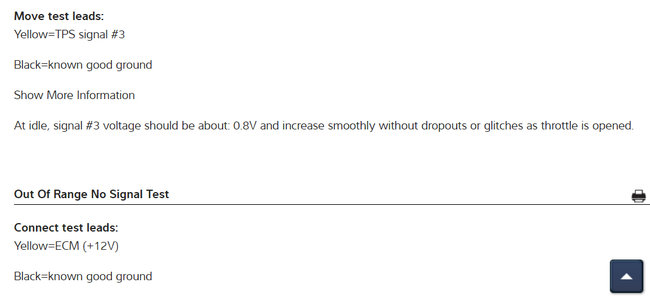

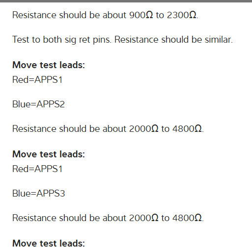

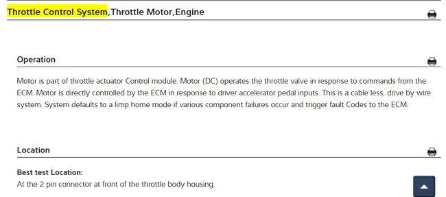

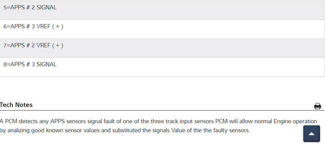

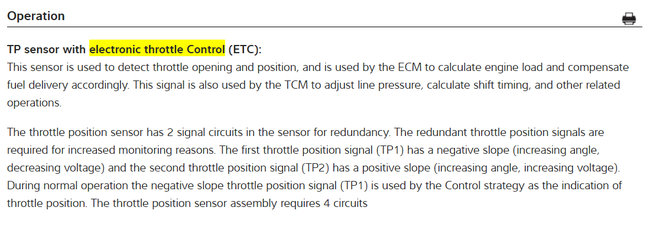

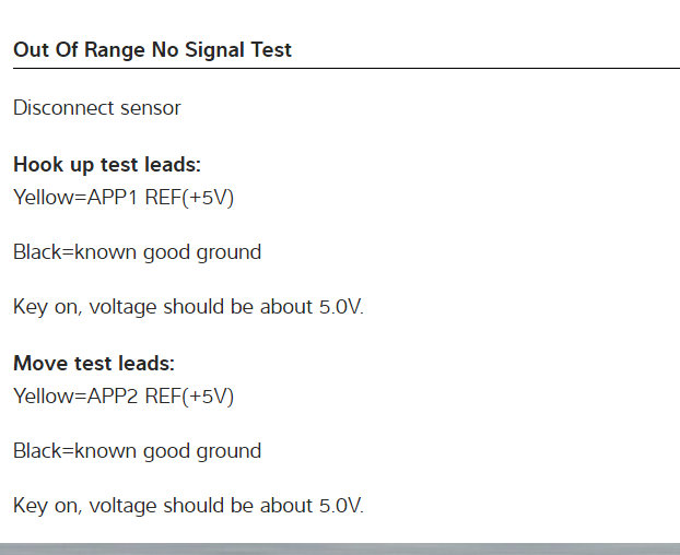

SCGRANTURISMO
  • 4,897 POSTS

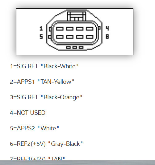

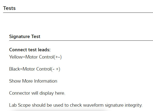

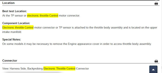

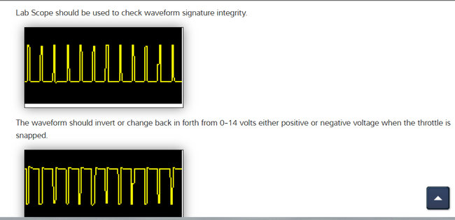

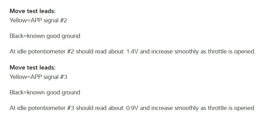

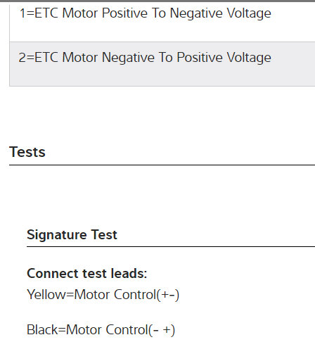

Hello again,

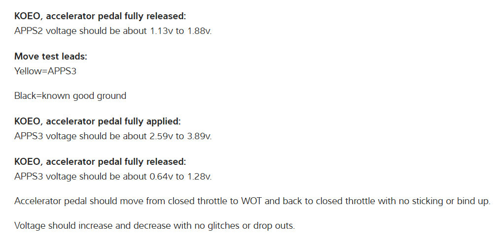

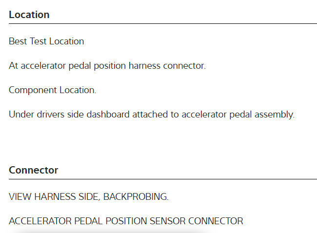

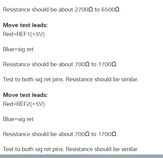

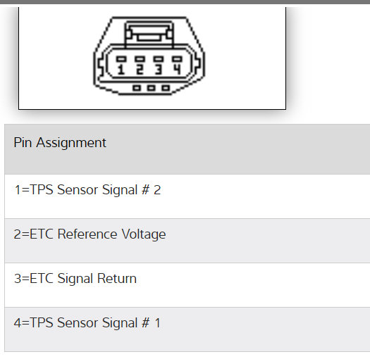

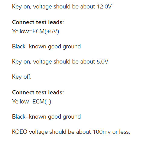

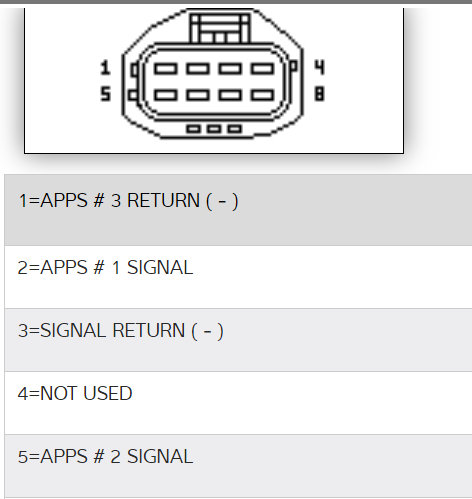

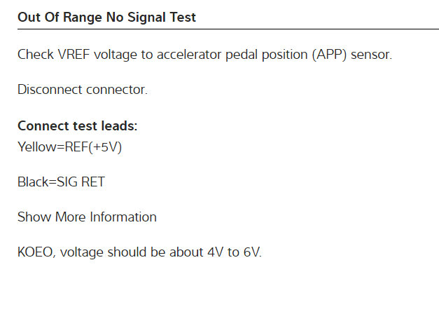

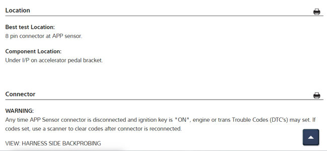

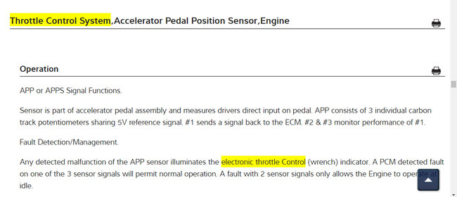

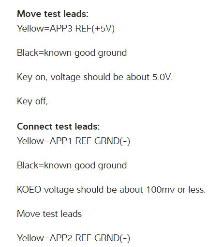

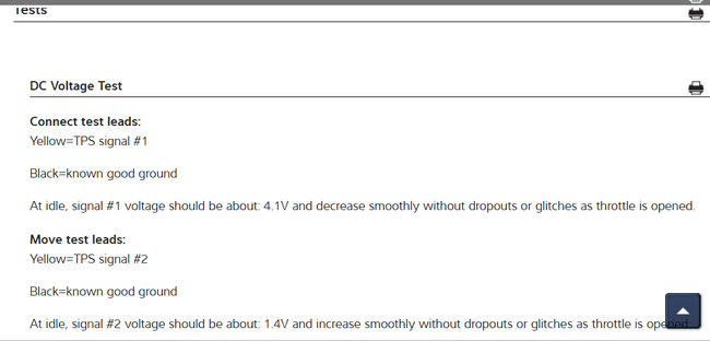

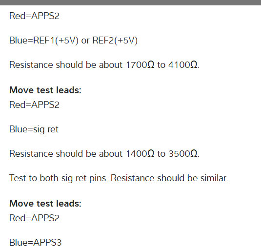

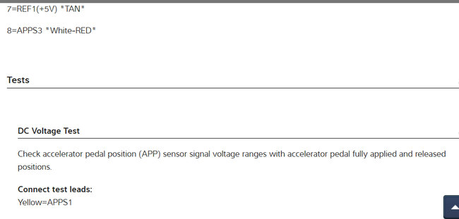

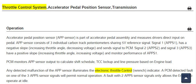

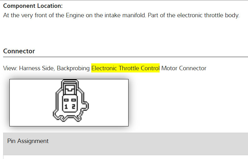

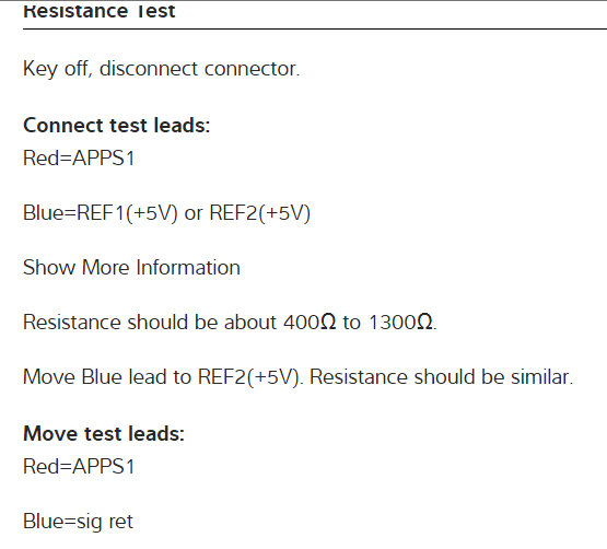

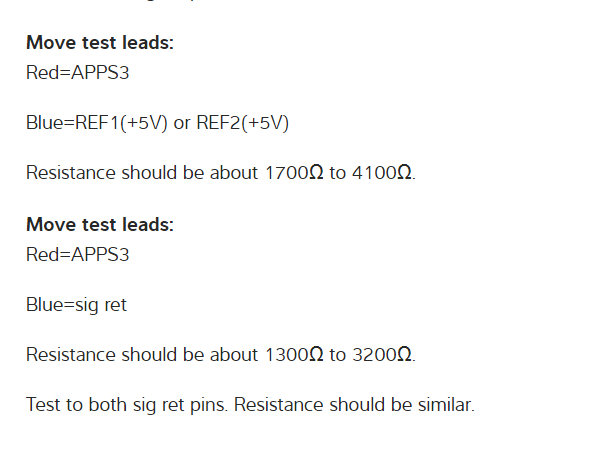

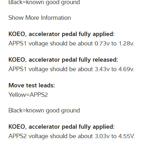

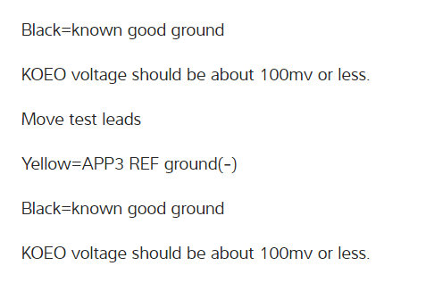

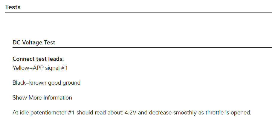

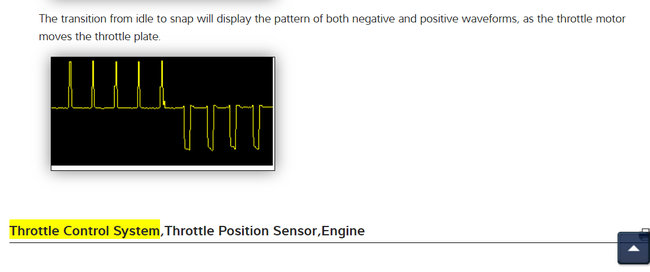

No, a vacuum leak would not be intermittent. I have included for you a diagnostic troubleshooting guide for your vehicle's Electronic Throttle Control System in the diagrams down below. It will call for you to use a multimeter, so I have included a link below if you are unfamiliar with how to use one.
Please go through the troubleshooting guide and get back to us with what you find out. This is probably going to take care of the whole ball of wax as well, because your original complaint would also be caused by this system malfunctioning.

Hey Alex, sorry it took so long to reply. I was able to finally get to a friends house to diagnose the problems. I pulled the throttle body off and cleaned it and re-calibrated it as per video instructions. I found out with Fords, if you disconnect the battery the throttle body needs to be calibrated again.. so continued on trying to do the testing you sent but it didn't make sense between the instructions and application. also my truck is drive by wire, no cables or linkage, so I am at square one. checked the vacuum, cleaned the PCV, which was rattling,not clogged, couldn't find the EVAP canister, ran around the engine block, no leaks. it still has a miss with no code, frustrating. .any better tests for the sensors? is key on or off? where can I find information for thorough tests. Haynes manual says refer to electrical diagnostic manual for this truck?
any help is appreciated. thanks

The E and F-series in that generation in particular have a known issue with the TPS on the throttle body failing. There have been multiple updates to them over the years with the latest ones supposed to fix the problem. They are a bolt on replacement with the newest version being a box shaped part. When they start to get glitchy they can cause limp mode as well as running issues.
The miss with no code should be visible if you have a scan tool that can view mode 6 data in the generic OBDII mode. IE you just use the machine in generic mode, not using the vehicle specific mode. Fords are kind of quirky that way on many scan tools.
