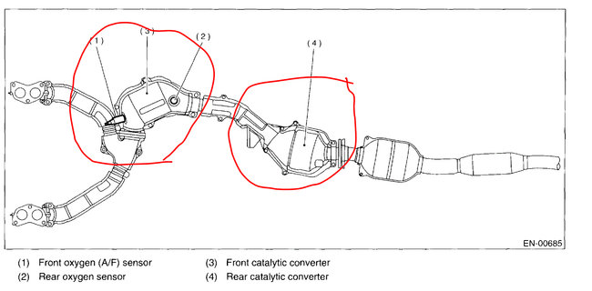

Tyler, if it helped, the converter is the issue. Now there are two converters (front and rear). I like the idea of the camera tool to confirm which one is the issue. Also, there are two sensors. One for the front and the other is for the back. Based on which sensor you removed can also answer that question.
Also, often times the converter will come loose internally and intermittently cause a blockage. Usually you can hear it rattle. You can tap on the system with a rubber mallet to see if one sounds loose.
I attached a pic. Let me know what sensor was removed or let me know what you find with the camera.

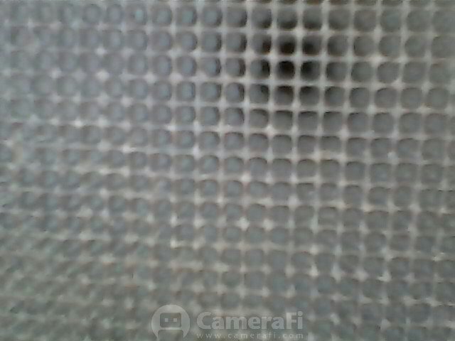

I took off the sensor before the first converter (number 1 in the diagram). I put the camera in the sensor port (it only let me attach 1 picture) What I can see there seems very clean. I haven't been able to get the number 2 sensor off yet to try and check the second converter. At this point, that doesn't really matter correct? The diagnosis is still a converter is bad. I tried to go in from the tailpipe with the camera but I couldn't get around in the muffler so that didn't happen.
From what I have found parts wise and my inability to be able to weld it would be easier and most cost effective to replace both of them. So either way, a converter is bad so I should replace this?

That does look good. If it ran good when you removed the oxygen sensor, something is causing too much back pressure in the exhaust. Most commonly, it is a catalytic converter. Please understand, I can't be 100% sure without seeing it. however, that is my first suspect.

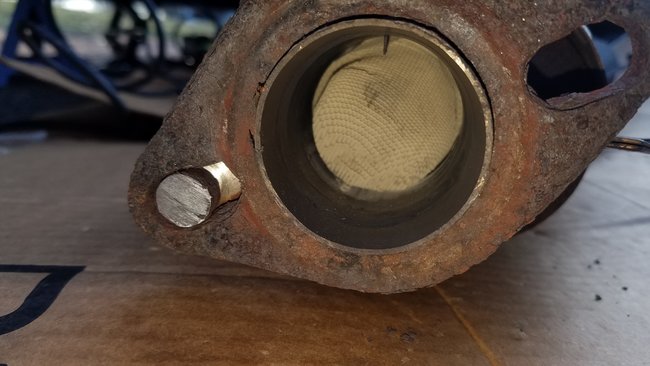

Thank you very much for all of the help I learned a lot from it. I was finally able to get take the pipe with the converters off of the car and got a good look inside the second converter (picture attached). This is definitely bad.

Glad to help. Yes, that doesn't look too good. Chances are the insides were moving around plugging the system. Regardless, I'm glad you got to the bottom of it.
