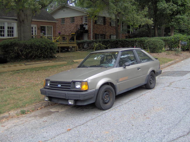

I have a 1983 Ford Escort, 1.6L, EFI, 2 door hatchback GT.VIN # 1FABP0752DW203308 For years I've had a problem with intermittent hesitating (in gear) or stalling (with clutch in) while driving. The symptom will eventually go away, until the next time it occurs. Otherwise it runs well. Got 33 mpg on last trip. No mechanic has been able to solve the problem. We have replaced the idle control valve, distributor, cleaned air intake, and much more.
Could it be the EGR valve, oxygen sensor, heat sensor...? Finding a solution may determine the future of this vehicle. Thank you.

This would seem like an arduous and costly means of diagnosing the problem. During a normal diagnosis, however, the symptom will not occur. It is only while driving, and is intermittent. Sometimes it can be driven for a long while without a problem. Yet, sometimes it happens shortly after start up. I would be discouraged to think that this can never be resolved. I could be willing to just replace a part here and there on an experimental basis.... EGR valve, oxygen sensor.... etc.
Any help or suggestions are greatly appreciated. Thank you for taking the time to respond.
