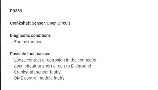

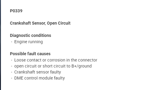

Intermittent hard start with backfire
VASSZ
  • 2006 PORSCHE CAYMAN
  • 4.0L
  • 6 CYL
  • 2WD
  • MANUAL
  • 90,000 MILES
Happening more and more frequent now.
cranks but won't start. After you keep trying, it backfires.
sends a p0339 code which is crank sensor.
changed it but same problem.
Monday, October 5th, 2020 AT 3:53 AM
Have you replaced the crank sensor? More then likely this is starting to fail. If not then we have a connector or wiring issue. However, due to it being intermittent this sounds like a contact issue in either the sensor or the connector.
Let's start with this and go from there.
