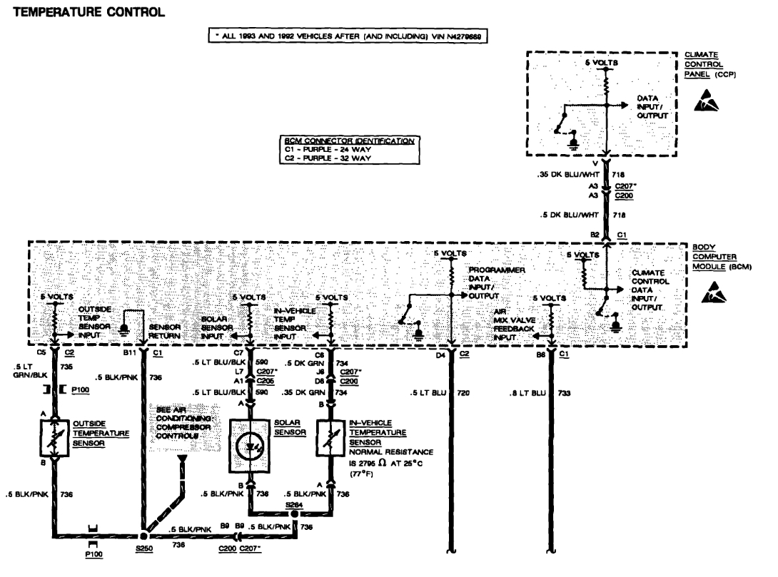

It sounds like the HVAC programmer is bad, I would try to find a used one on Ebay.
The fact that you've already replaced the BCM (Body Control Module), checked the power supply, and verified the connections is a good start.
Check out the images (below). Please let us know how it goes.

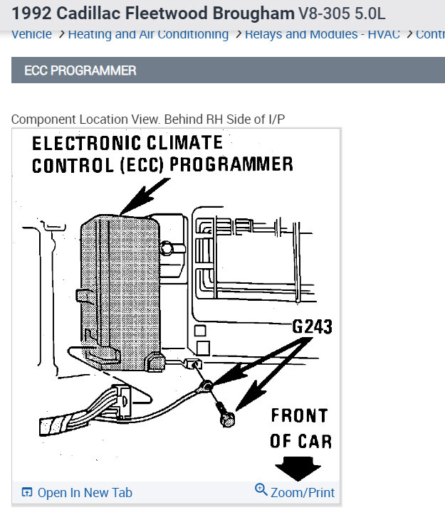

Is HVAC the same as ECC Programmer? If it is not, what is it?
From what I can understand and gather from the Cadillac service manual, it directs the vacuum to the dampers and the motor that controls how much hot water it should send into the heating element in the car.

(My car is a Fleetwood FWD 1992, the picture you sent was of a Brougham -92)

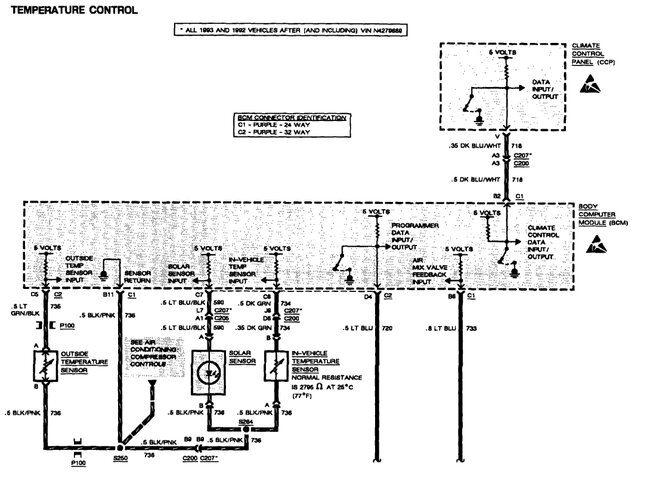

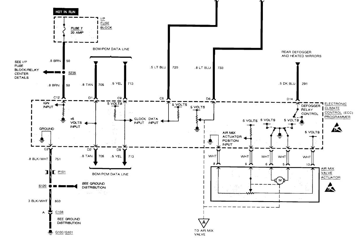

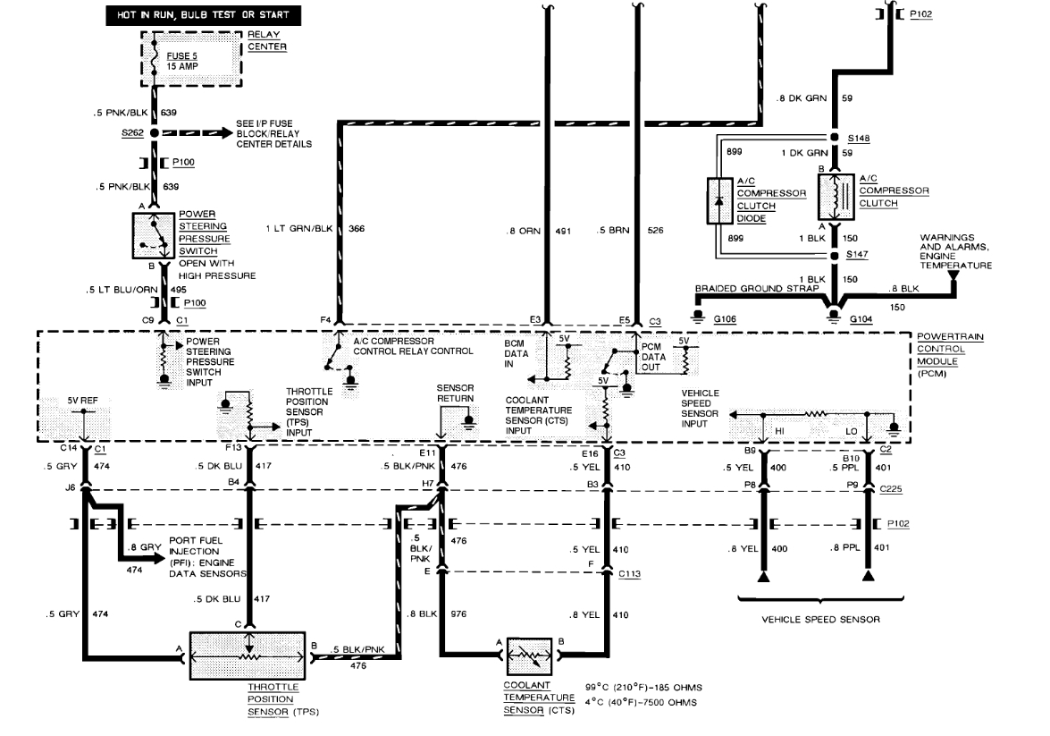

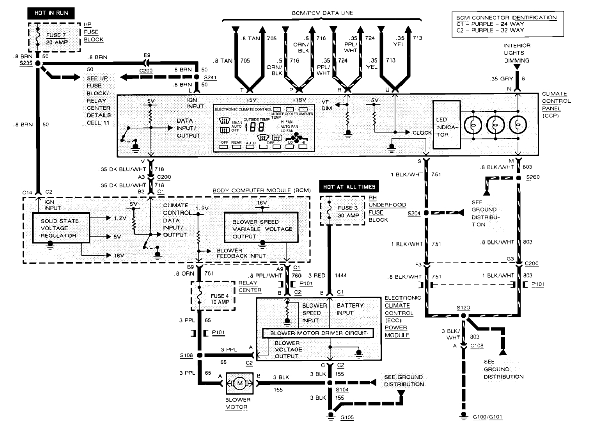

Here is the HVAC and programmer wiring diagrams so you can see how the system works and a guide to help you check the connections.
