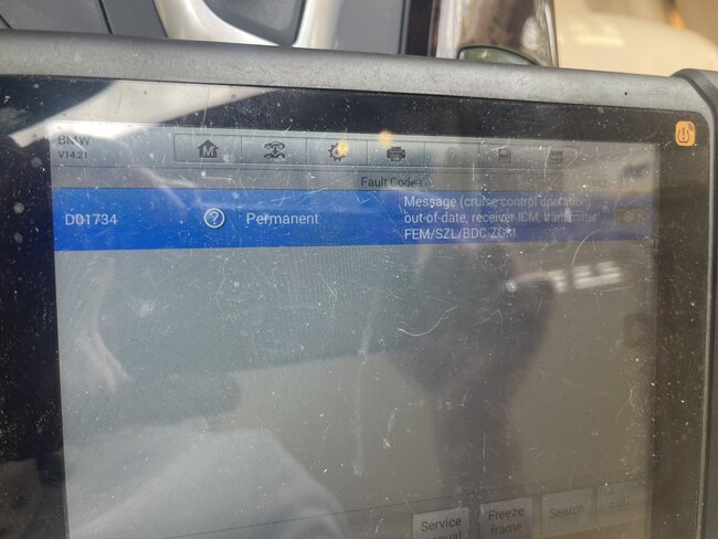

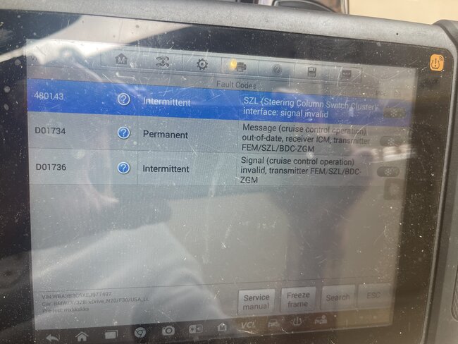

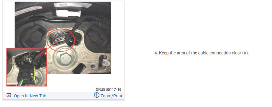

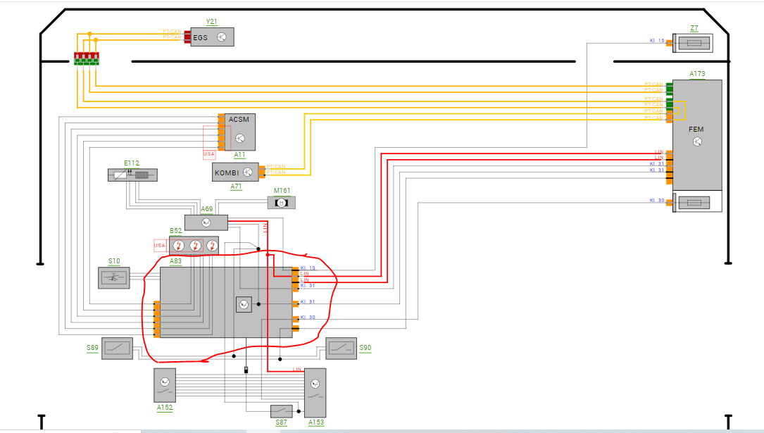

Scanned it and found 3 codes then deleted them and one stayed which is this one. Basically, cruise works then randomly says malfunction and steering buttons don't work but horn works.
Apr 18, 2024 at 3:31 AM
  • 110,240 POSTS

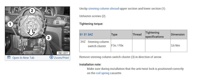

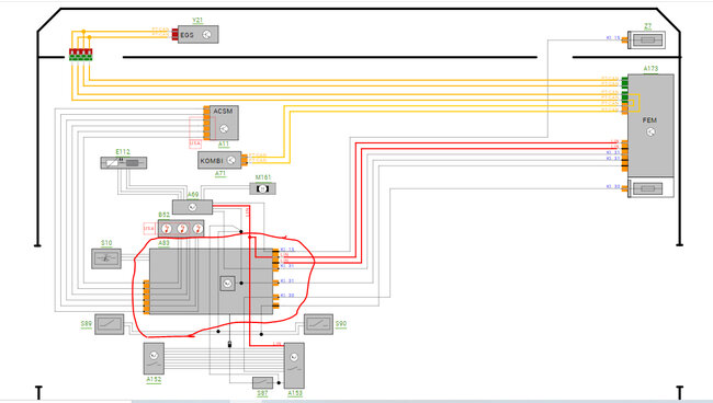

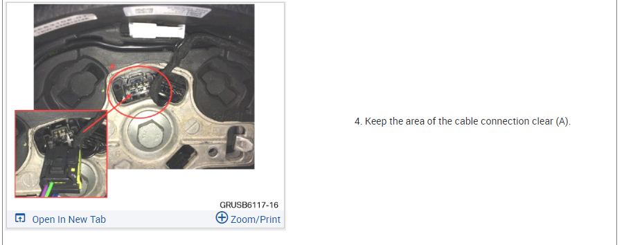

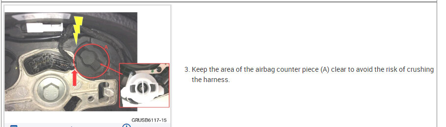

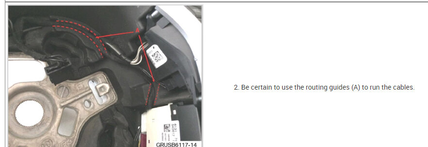

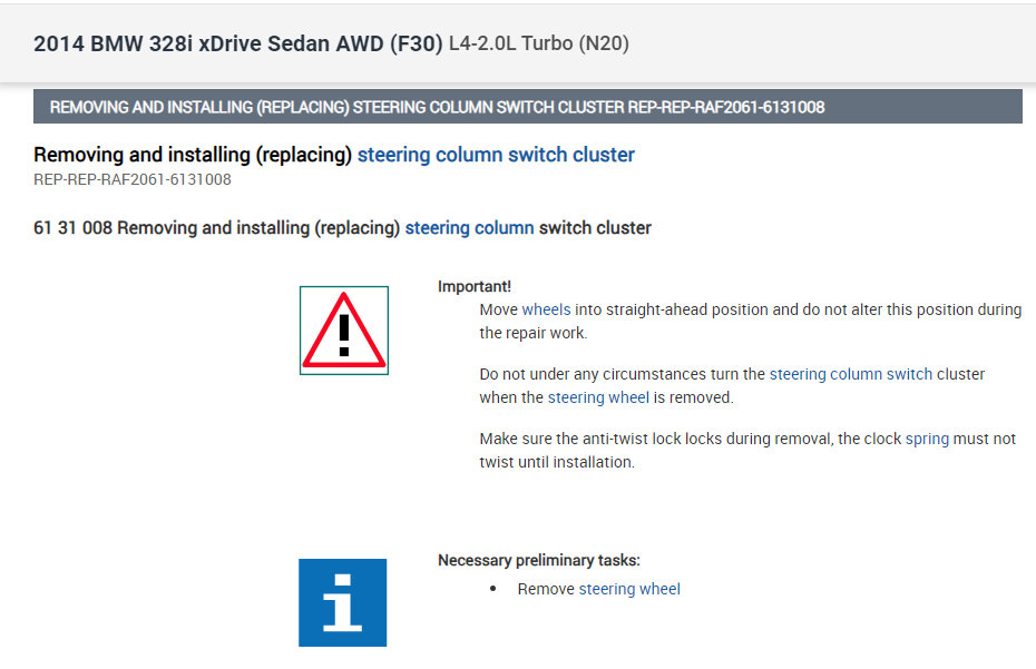

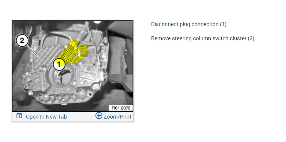

I suspect it is related to the steering column switch cluster. There were issues in the past where the wiring would corrode and cause intermittent issues. That is where I would start checking.

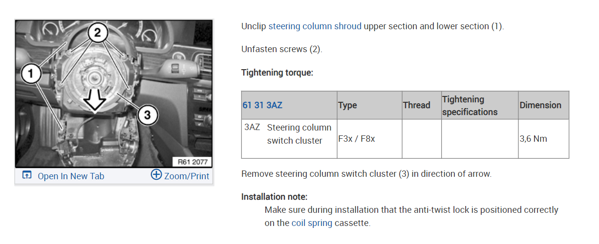

I attached the directions below for removing and replacing the part. The steering wheel will need to be removed to access the switch. The directions are for the replacement. I would check connectors for corrosion or other issues.
See pics below. Note: Pic 1 is from the wiring schematic. The remaining pics are the directions for removing and replacing the switch.

You mean what they call the clock spring?
Apr 18, 2024 at 11:53 AM

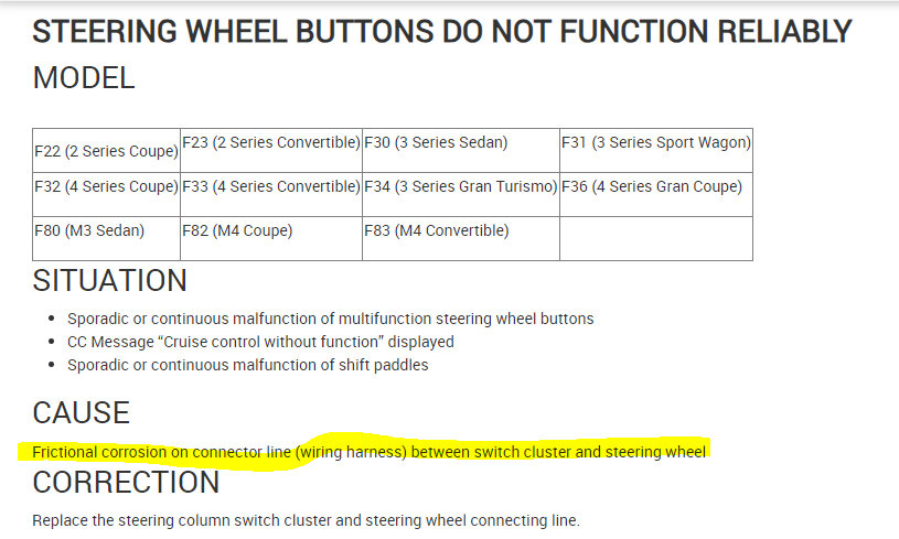

  • 110,240 POSTS

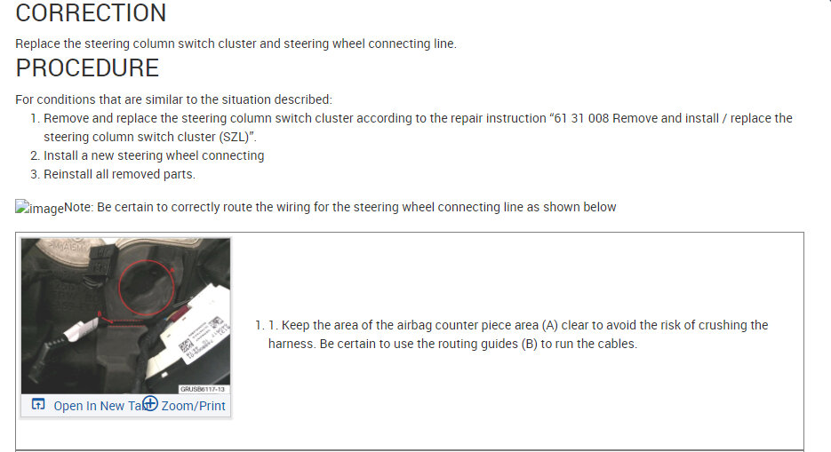

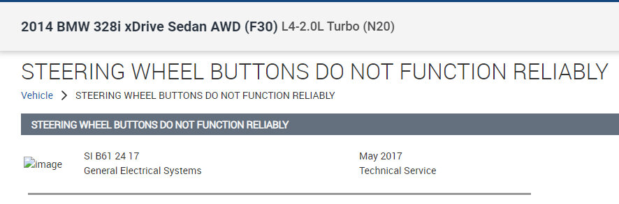

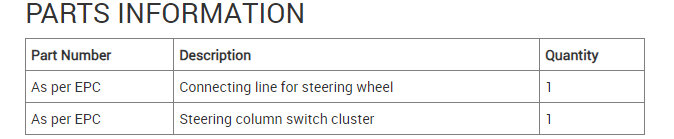

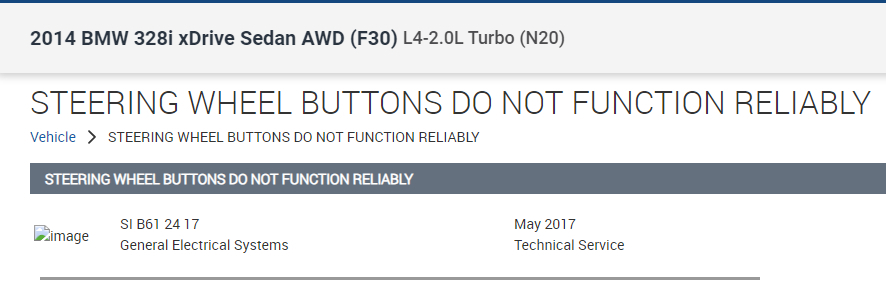

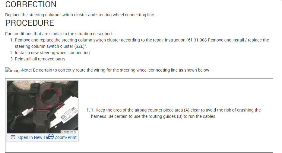

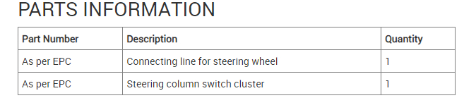

Yes. I was able to find some older technical service bulletins on the topic. I attached one below that seems to be specific to what you are experiencing. Take a look through it and let me know. Also, this TSB indicates to replace the part and not to focus on the connectors.
