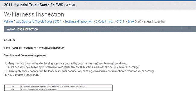

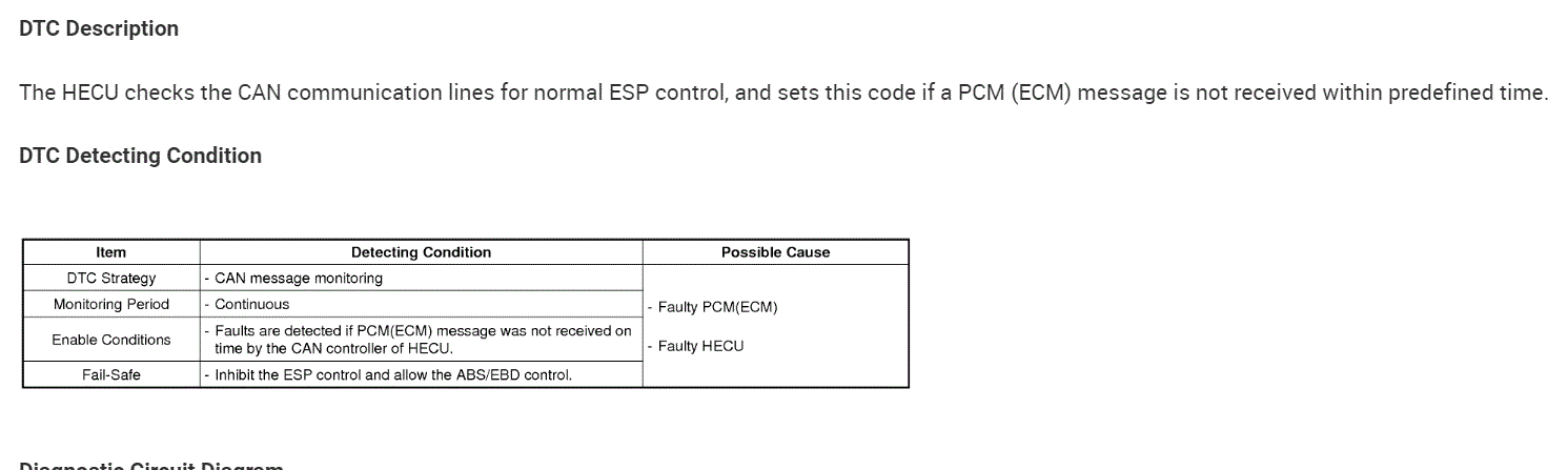

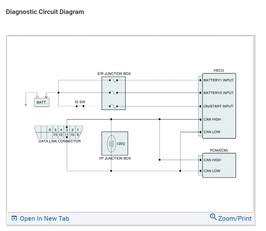

The C1611 is related to can-bus communication between the HECU and the ESP.
The HECU (hydraulic electronic unit) checks the CAN communication lines for normal ESP (electronic stability program) control and sets this code if a PCM message is not received within a predefined time.
Based on your description, I would start by checking wiring. Do me a favor. Take a look at the diagnostics below for testing the relevant wiring. Let me know if you are comfortable doing it.
The ECM is likely available online. There are people that rebuild them and based on your vehicle's VIN number, it is programmed and plug and play when you get it.
Let me know about the wiring.

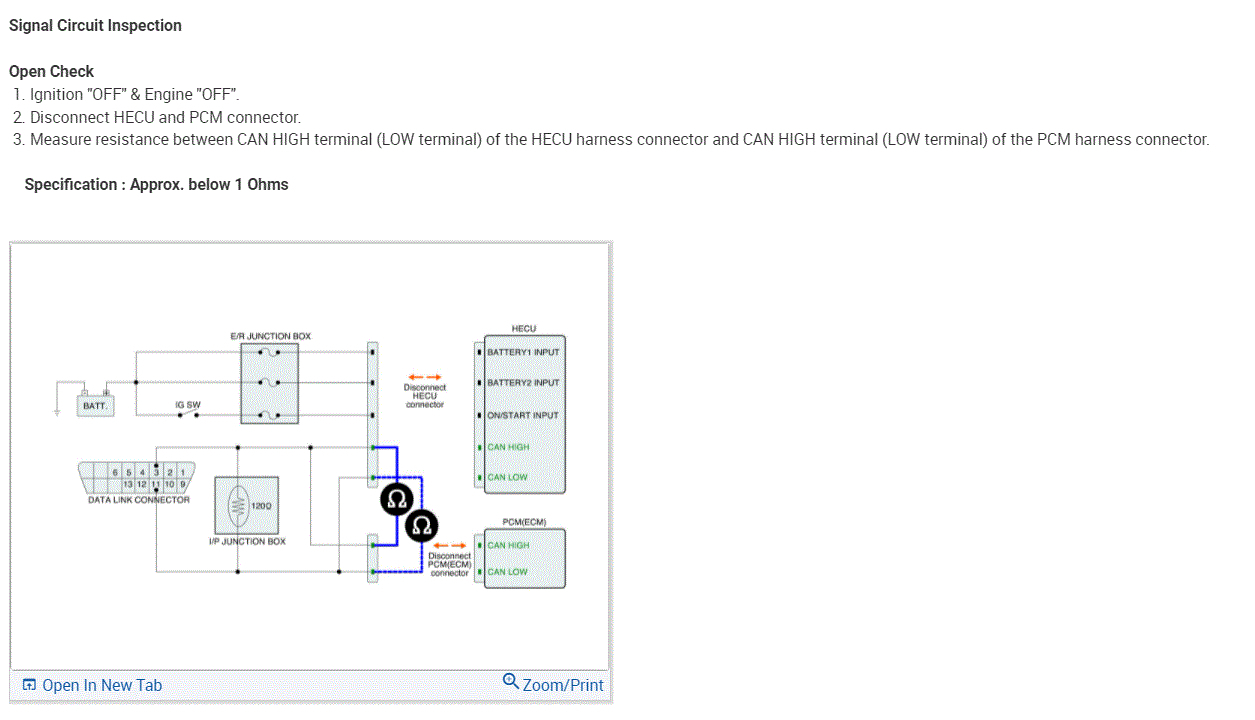

Conducted voltage test with outbreak box from pin 4,5, to 16. read normal 12.3 volts
Conducted ohm test while car was off and asleep between can low and high 61.2 ohms
Conducted voltage test from ground to high can 2.7 v, low was 2.2 and 2.3 v

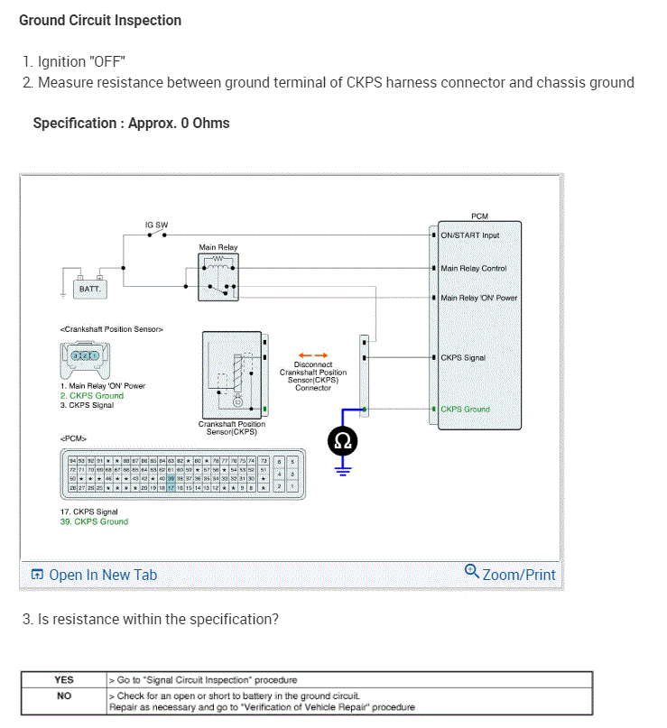

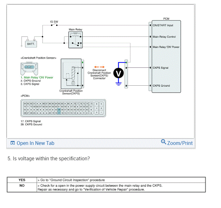

Tested connector for crank sensor with key on ignition off ground lead on ground battery post/ 12.2 volts, 4.93 volts for signal and 0.1 for ground is this the same test you provided me with? my next step is the PCM connectors
Took for test drive for about 10 mins no problem. However, sitting in front of house at idle for a few mins all of sudden rpms went high then back to normal. Let run for a few mins. raising idle to about 2400 rpms and back down. no problems front reading lights are flickering, do you have any diagram for that?

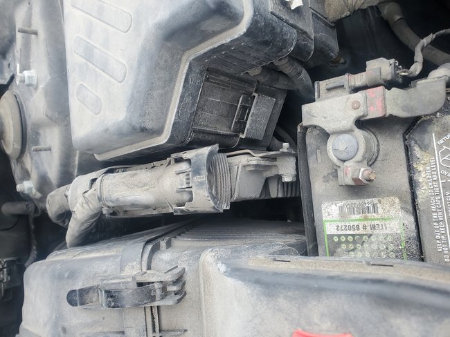

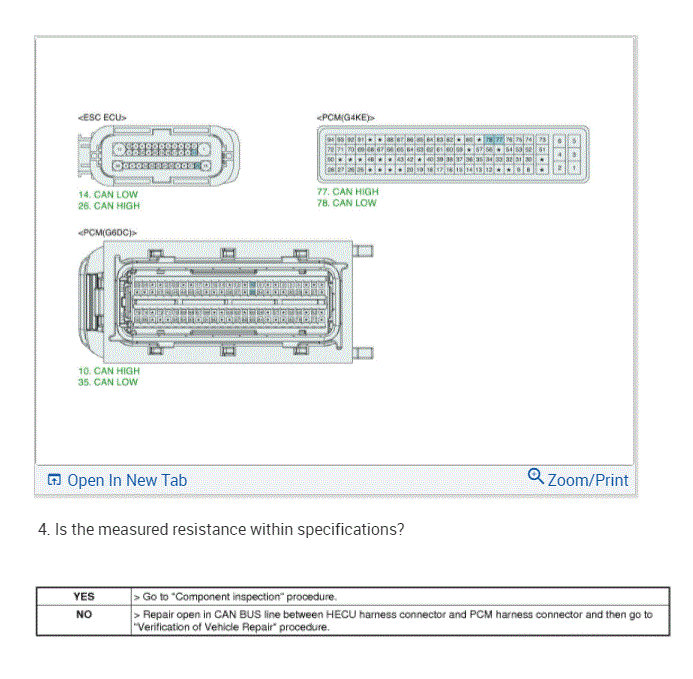

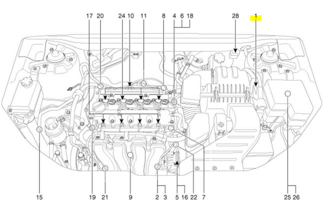

Should i still disconnect PCM and test for 1 ohm between connectors the ECM and PCM is the one located by battery box correct. (Pic below)
Any other suggestions?
Thanks, in advance.
Mar 28, 2022 at 11:05 PM
  • 110,240 POSTS

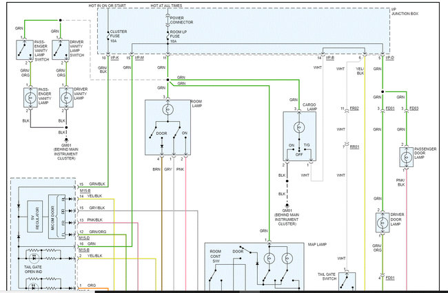

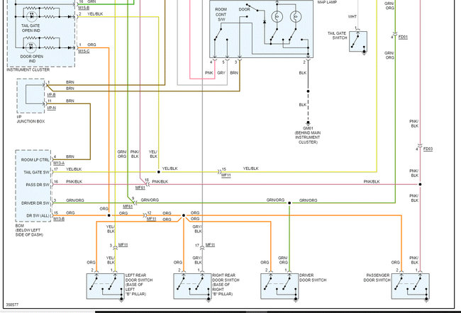

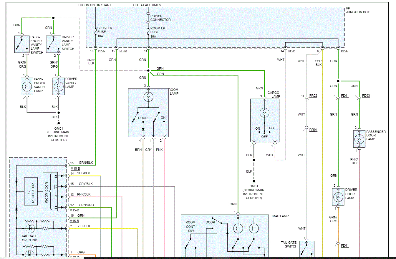

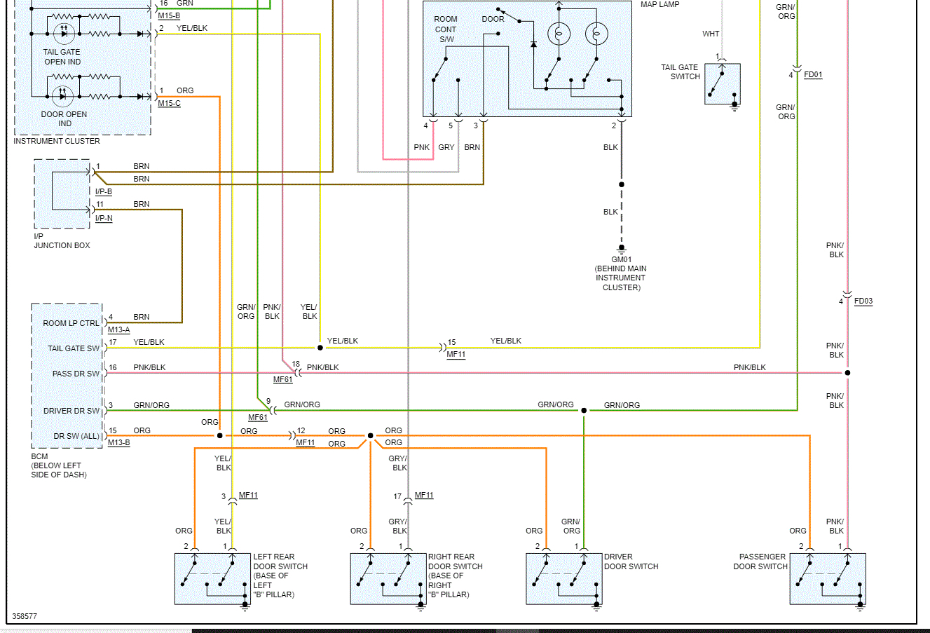

By chance, did you notice if any of the other lights were flickering? Also, the ECM is located under the hood. See pic 1 below.

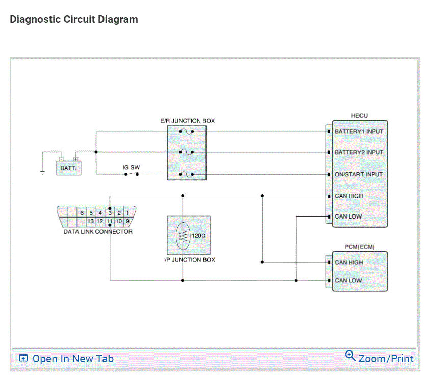

Let me know about the light issue. Pics 2 and 3 below are the wiring schematic for the interior courtesy lamps.
Let me know if this helps.

I don't want to damage anything and am rusty with electrical. When testing PCM and connector, do I have to unplug the battery or follow any extra steps before unplugging PCM for the ohms test. what other test can I perform to diagnose or rule out PCM since I performed your other suggested test?
What's the other module on my vehicle that has the resistor? ABS?

The only lights flickering were the reading lights. I changed the lights back from led to right bulbs for the reading lights and is not flickering. I just didn't know if that was tied into my problem.
Thanks again for all your help.
Mar 31, 2022 at 5:35 AM
  • 110,240 POSTS
Before disconnecting the PCM or any module, I always recommend disconnecting the battery. When you plan to reinstall the connector, make sure the battery is disconnected as well. Once the PCM is reconnected, then reconnect the battery.
I didn't realize you had LED installed. That was certainly the cause.

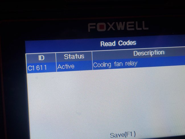

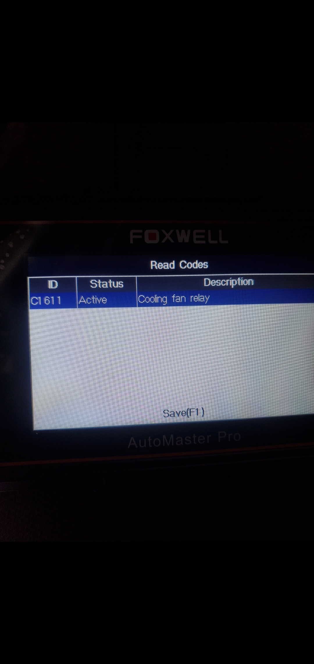

tested cooling fan relays high and low, both relays work. turned A/C on after a few minutes. The low cooling fan relay clicked, and the fan was on. switched high and low relays, performed the same test, and it worked.
c 1611, cooling fan relay.

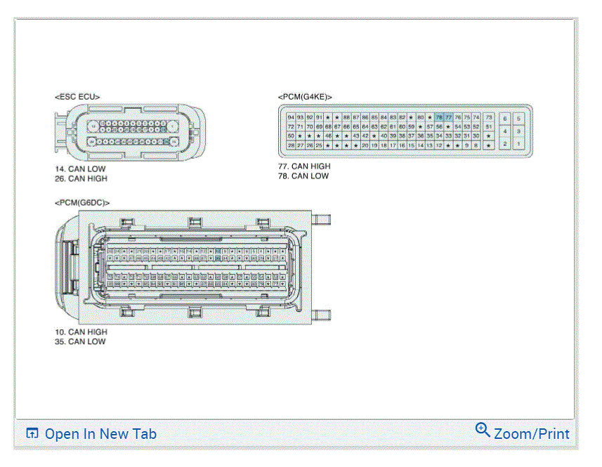

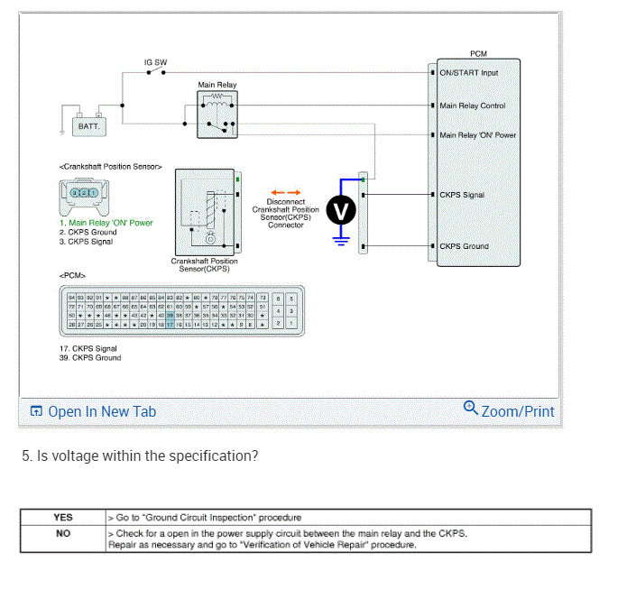

As far as disconnecting the battery, yes it will reset the PCM/codes, so it is a good idea to write them down first. Also, you should be okay if you wait a couple of minutes after disconnecting the battery. However, when it is time to reconnect the PCM, make sure the battery is still disconnected. Once the PCM is connected, then reconnect the battery.

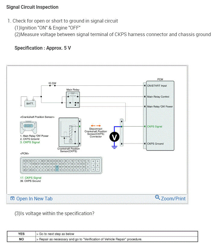

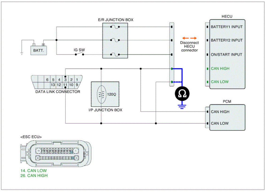

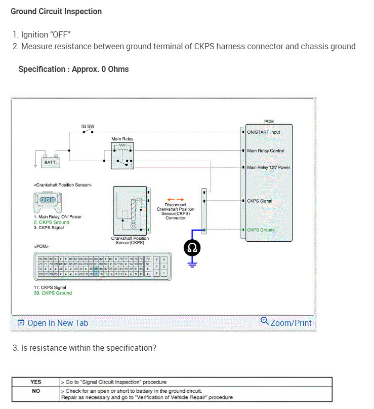

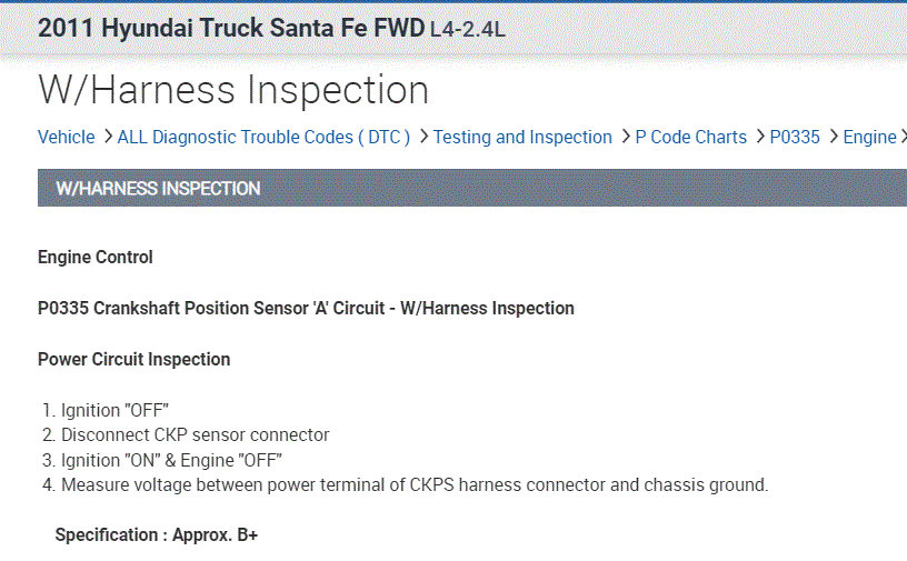

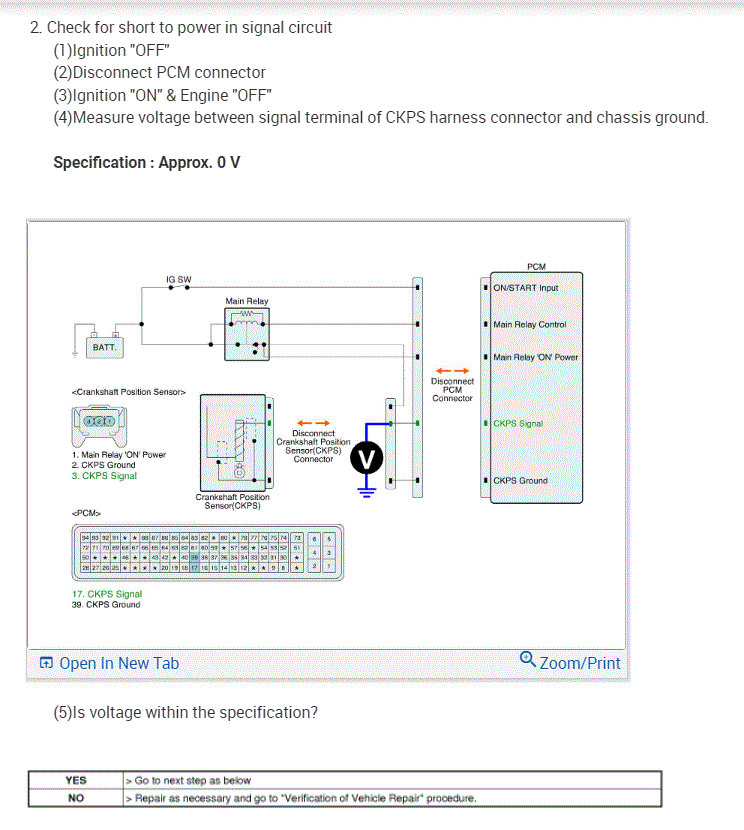

If you look below, I uploaded diagnostics for the P0335. The last pic is the only schematic I have for the CAN.
Apr 3, 2022 at 12:11 PM
SANTA FE 11
  • 13 POSTS
Thanks for the diagrams and quick response. I tested with key on the crank sensor harness connector from battery ground and had 4.93 v at signal, .01 at ground and 12.2 v at hot wire. I also tested resistance from battery ground and 2 of the chassis grounds near fuse box by air box both .01.
I will perform the same test from chassis ground tomorrow.

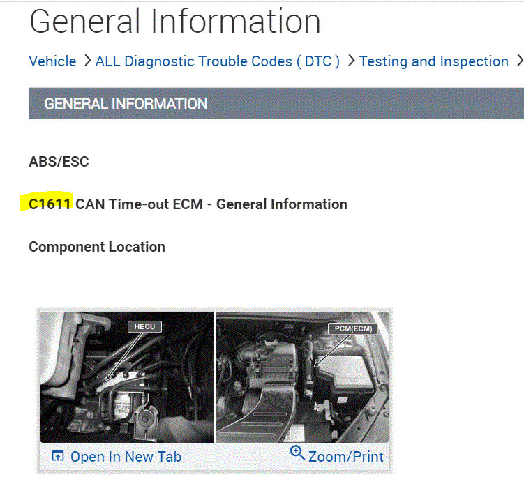

Also, why would the c 1611 say it's a cooling fan relay? When communication is lost, does it throw the code to with any sensor on that connection? First it was the steering angle sensor, then lost communication with ECM. now cooling fan relay.
thanks
Apr 3, 2022 at 1:33 PM
  • 110,240 POSTS

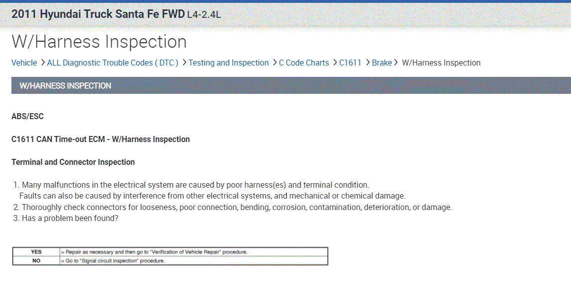

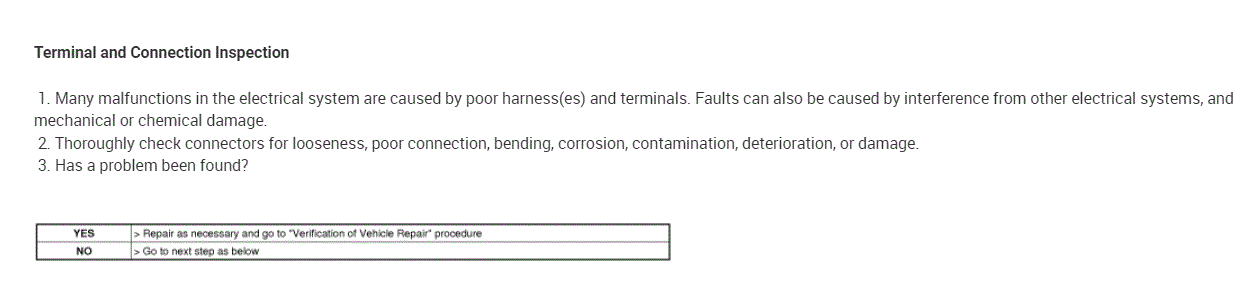

The C1611 isn't for the cooling fan circuit. It is related to a breakdown in communication between the HECU and the PCM/ECM. See the description below.

Update: I took my car to a mechanic on April 9th since my time was limited with work and he told me he would look at it, well he got swamped and for whatever reason kept pushing my car off and after calling several times i finally picked my car up on the 18th and took it to a another shop that had high reviews with a good reputation and is said to have high tech engine diagnostic tools with reprogram and etc. They looked at my car and fixed it on the same day. It was my crank sensor that was failing. I did have the OEM one on the passenger seat which i should have installed before taking it in but decided to let them see all the problems so they can diagnosis it with the symptoms i was encountering. Also, they had said the stalling was also due to my intake manifold runner solenoid which i thought was outside the manifold case, but they said they also had to take off the manifold plenum as well to fix something else. The bottom line is my car is running great and I wanted to say thank you for your time and info. i did learn and/or get a refresher on some engine diagnostic especially with the BUS CAN line.
i asked them why my scanner was related to the c1611. It was saying it was the cooling fan relay and they related the same thing you said that it had nothing to do with the cooling fan and it was giving a generic code because it was a less expensive scanner. I thought it was decent but guess not.
