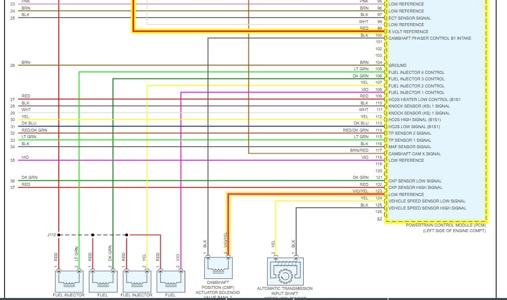

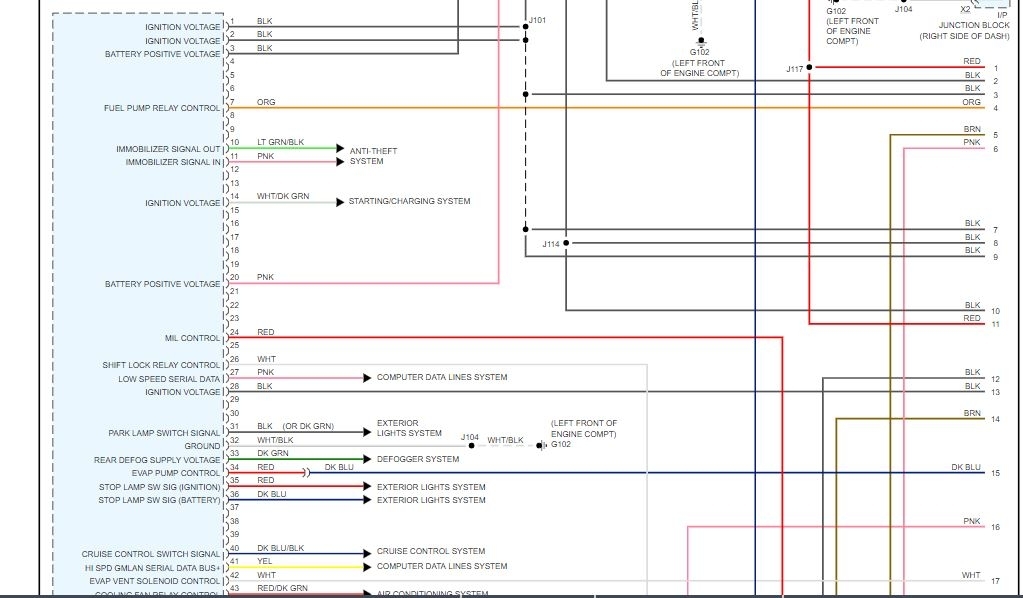

Good morning,

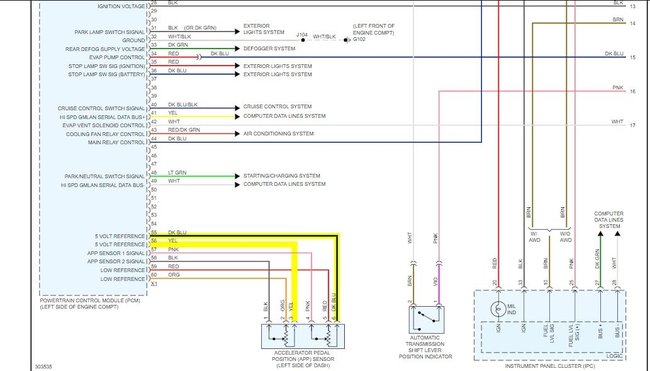

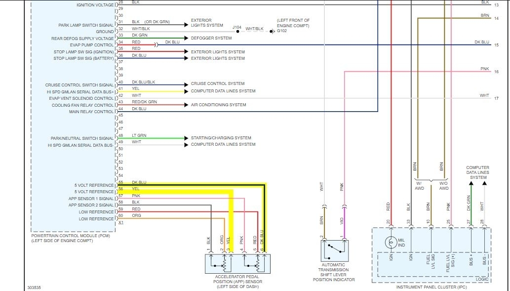

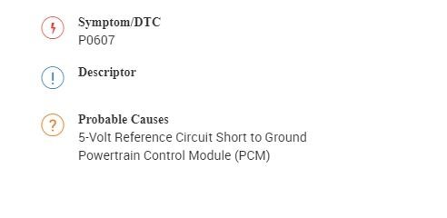

This code is for an electrical issue with the 5 volt reference circuit for the ECM. When that voltage is not present, this code will result.
I posted below the description and the flow chart for determining the issue. You will need a volt meter to do the testing.

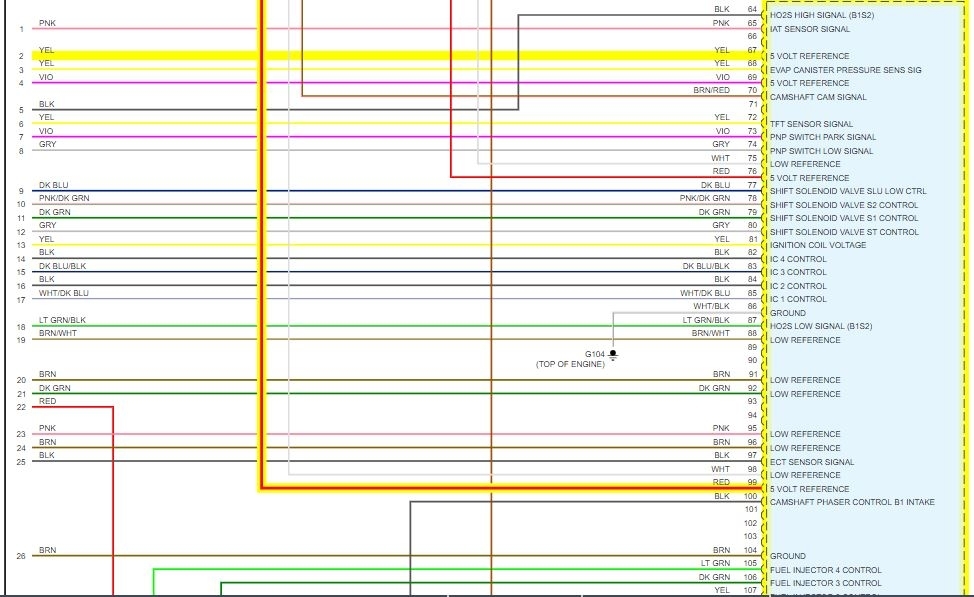

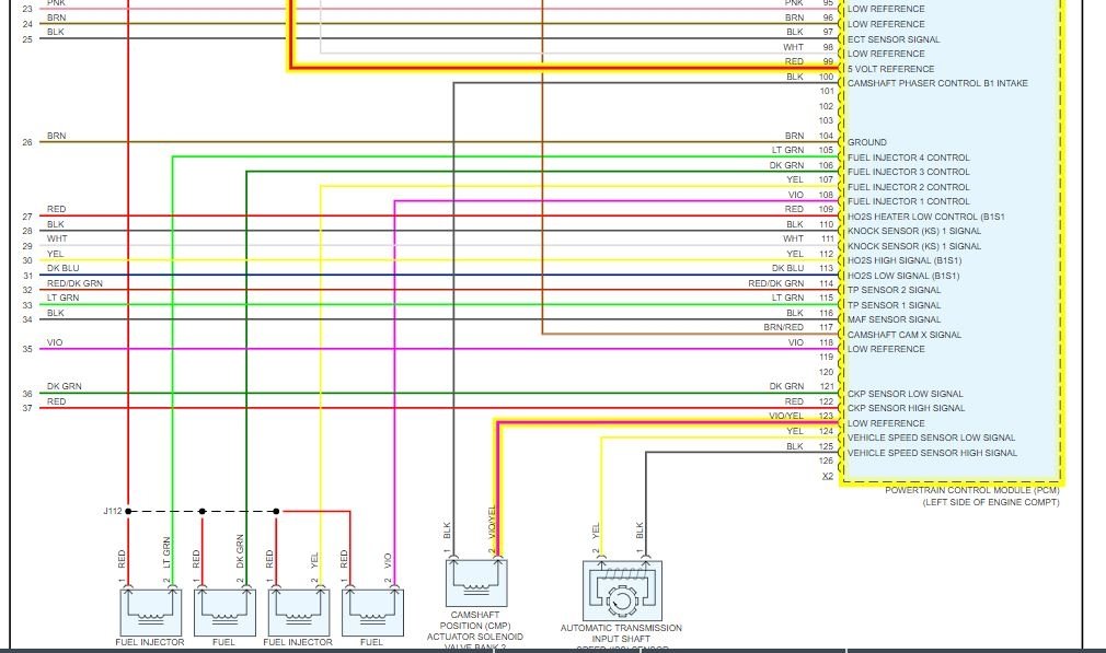

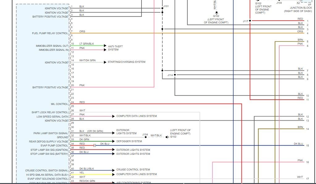

I also posted a diagram of the ECM and the 5 volt outputs that need to be verified.

A short to ground in the 5-volt reference circuit of some engine control sensors can set a DTC P0606 or P0607. The PCM provides 5 volts to the following sensors:
Throttle position sensor (TPS) 1 and 2
Accelerator pedal position (APP) sensor 1 and 2
The fuel tank pressure (FTP) sensor

1. Ignition ON, clear the DTC information with a scan tool. Observe the scan tool DTC information. Verify that DTC P0606 or P0607 does not fail this ignition cycle.
If DTC P0606 or P0607 failed this ignition, test the PCM 5-volt reference circuit of the applicable engine sensors for a short to ground. Refer to Diagnostic Aids. If the circuits test normal, replace the PCM.
2. Observe the DTC information with a scan tool. Verify DTCs P0604, P060A, P060D, P060E, or P2610 do not set this ignition cycle.
If any of the DTCs set this ignition cycle, replace the PCM.
