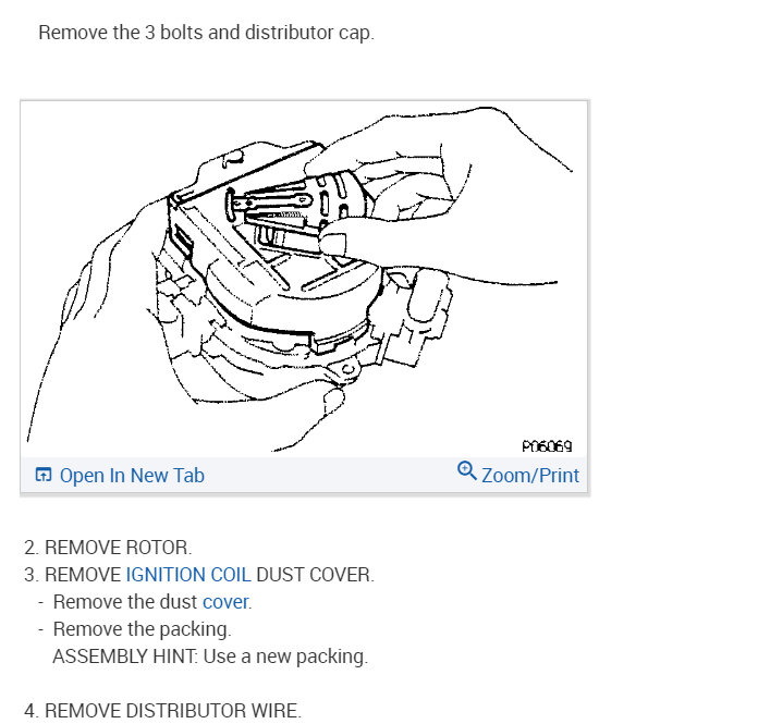

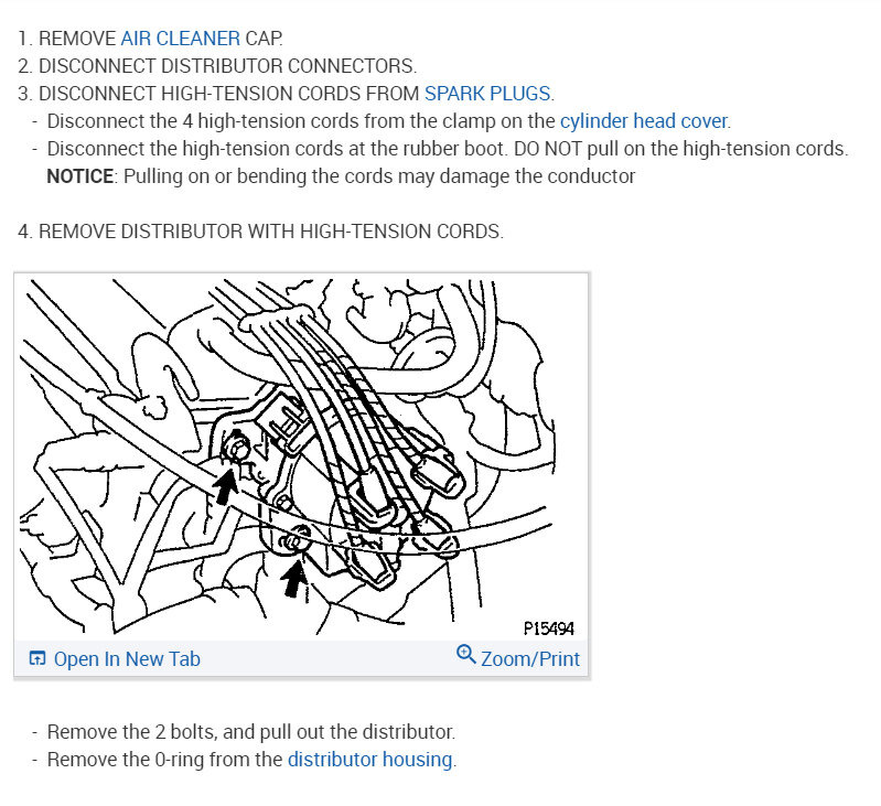

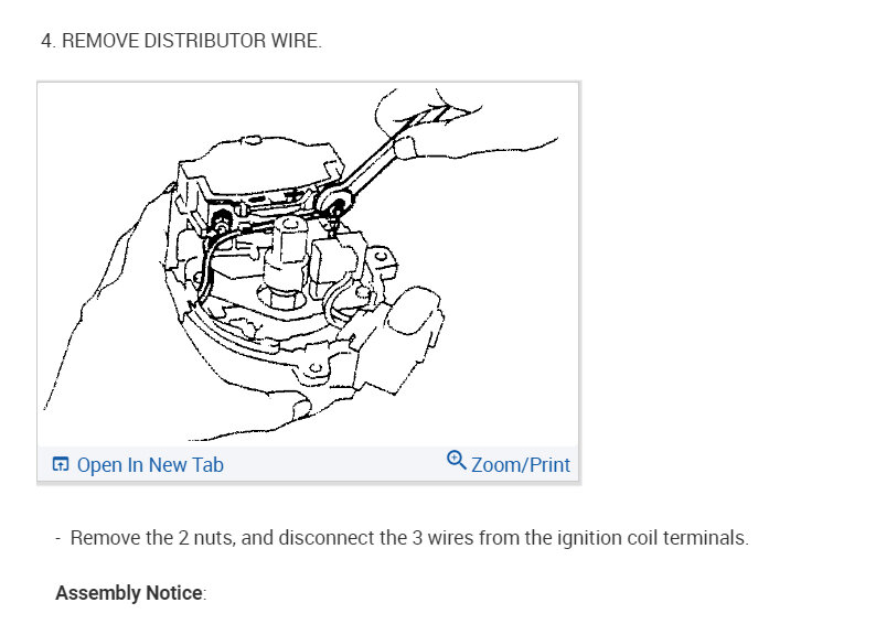

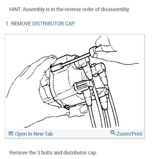

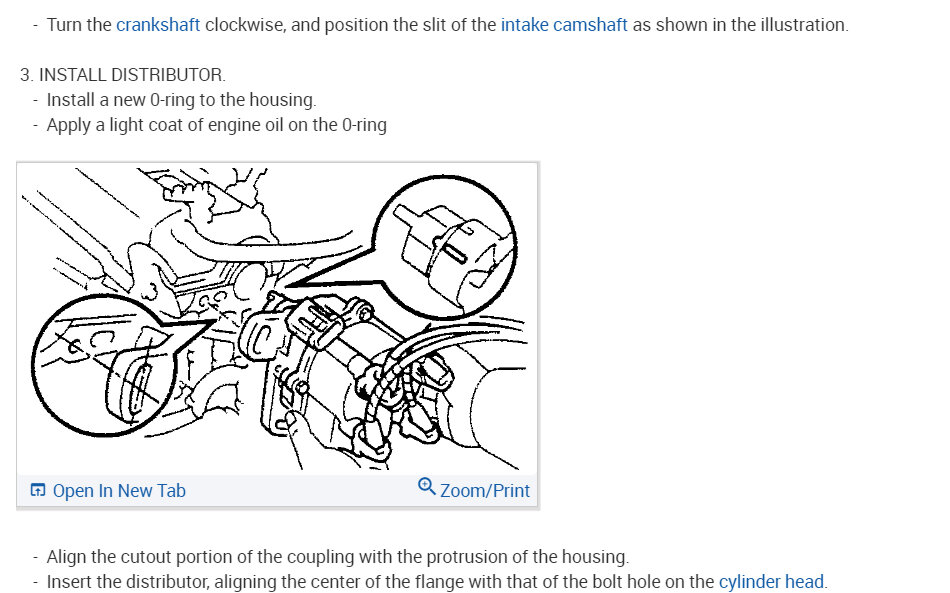

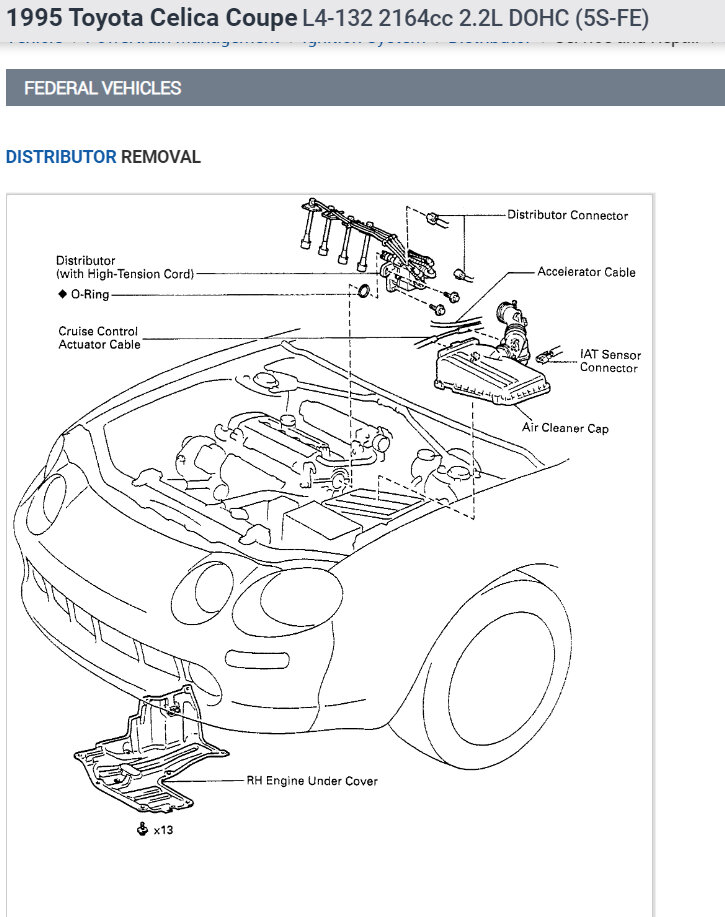

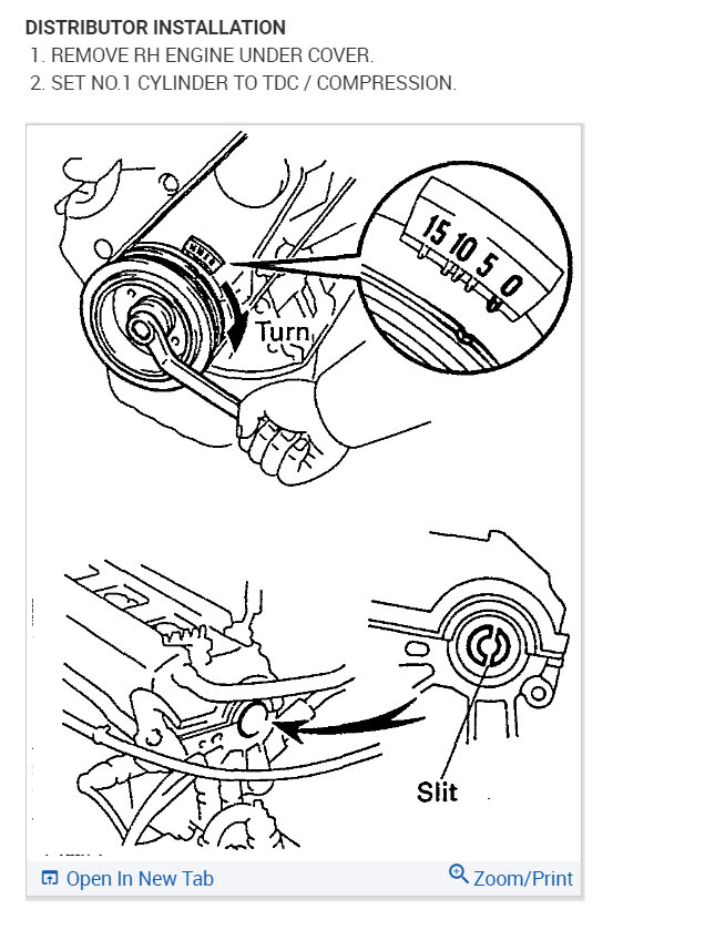

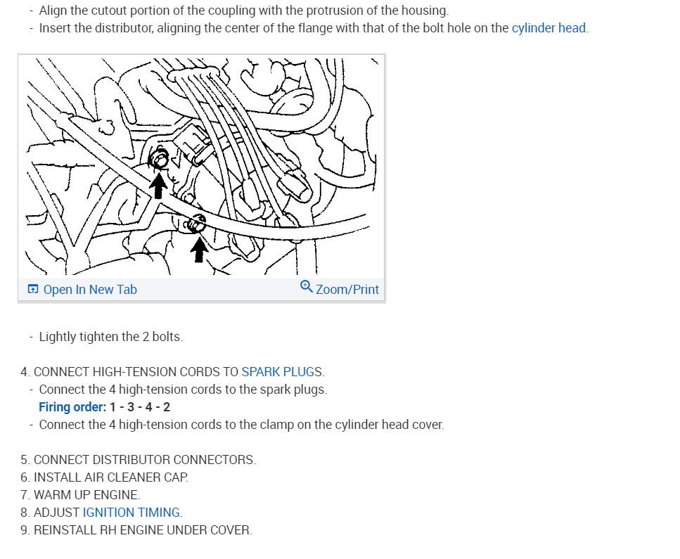

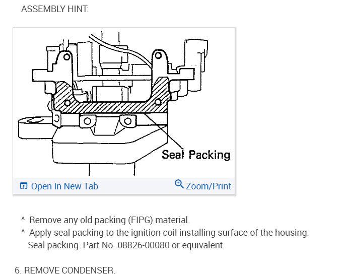

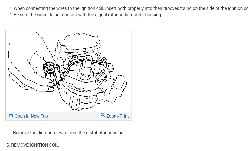

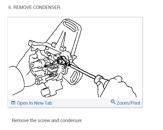

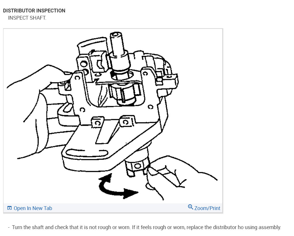

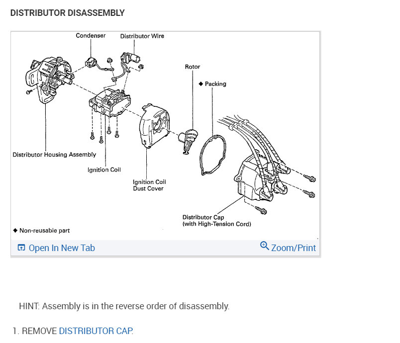

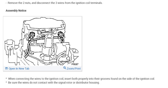

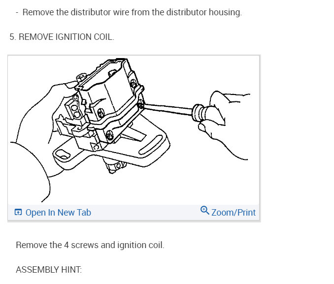

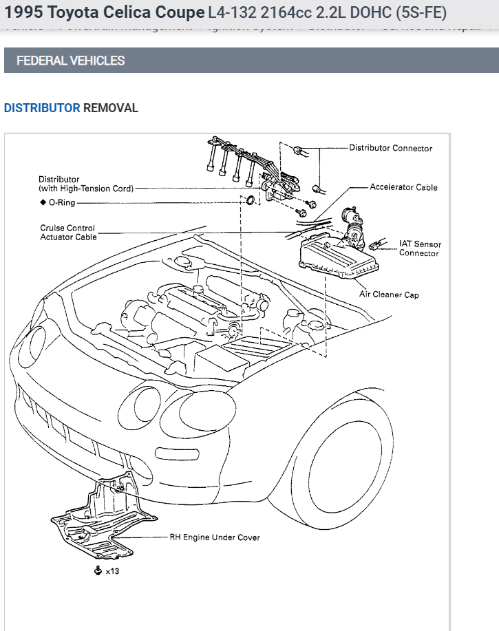

Code 12 Engine revolution signal missing, so I would replace the sensor which is inside the ignition distributor. Here is how to change it out. Also, you can get a rebuilt distributor or the individual internal parts. Here is one that Amazon has:
https://amzn.to/3PZ9iNp
Check out the images (below). Please let us know if you need anything else to get the problem fixed.
