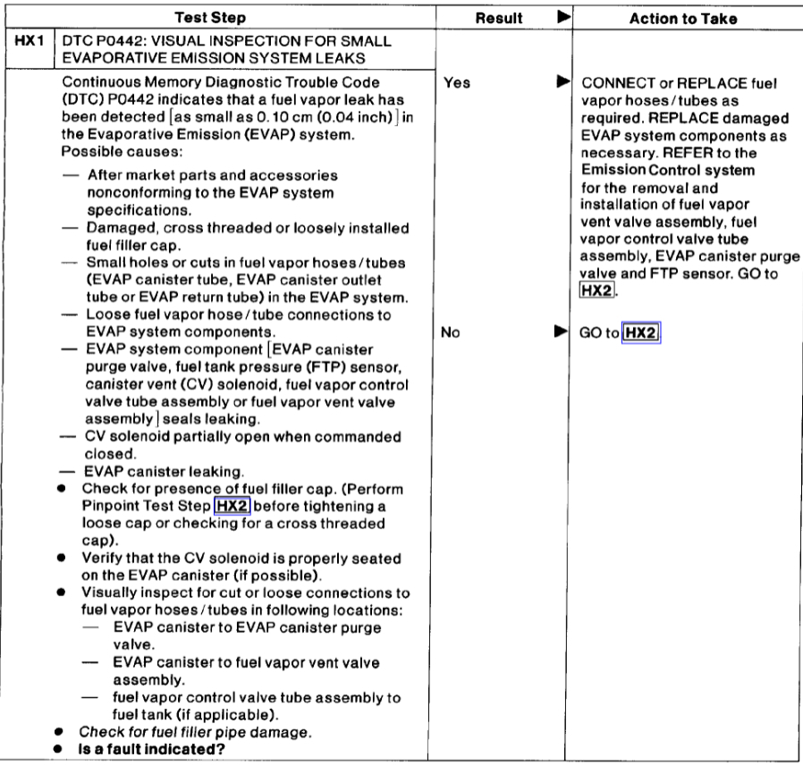

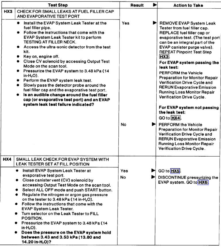

Previous P0442 code, gas cap hx, rain (leak=water inside frame), am=rough idle. Driven.
Friday, October 15th, 2021 AT 8:03 AM
SQM
MECHANIC
6,383 POSTS

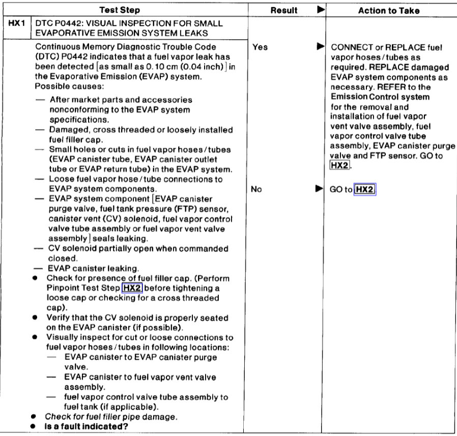

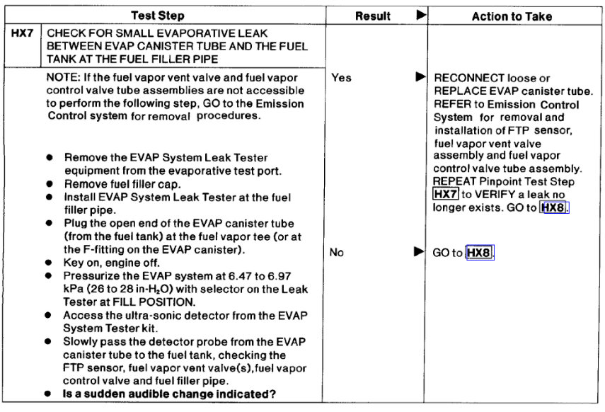

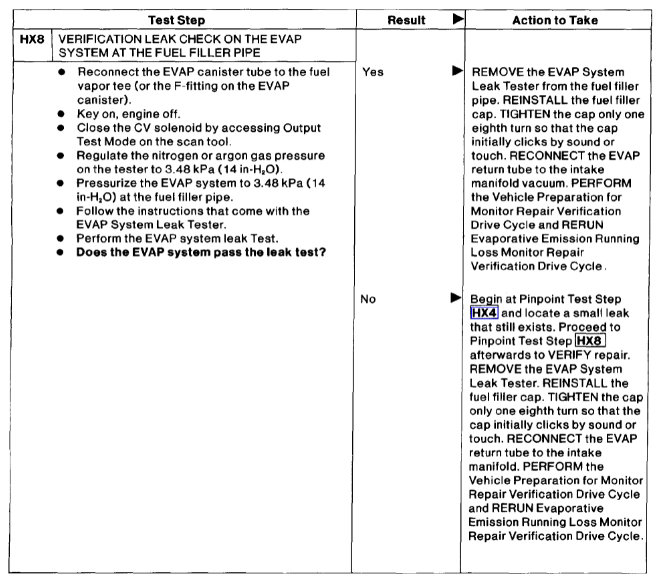

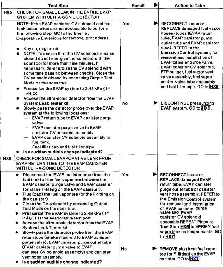

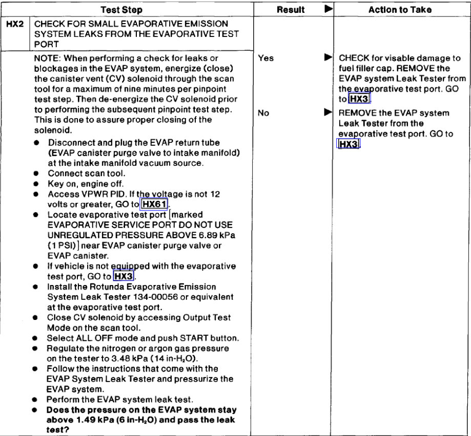

The code P0442 can get triggered for any type of small leak in the EVAP system. From a leaky gas cap to a cracked hose to a bad purge valve.
Here is a helpful guide:
https://www.2carpros.com/articles/evap-system-code-repair
I have attached the trouble shooting steps for that code below. This can help you with the diagnostics.
