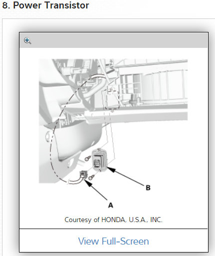

This sounds like you have a blower motor transistor that is out. here is the blower motor and air conditioner wiring diagrams so you can see how the system works with the location of the part that needs to be replaced. This guide can help walk you through some basic testing as well.
https://www.2carpros.com/articles/blower-fan-motor-works-on-high-speed-only
Sep 24, 2019 at 5:46 AM
BLAZE45
  • 380 POSTS
Well, I replaced both the fan and transistor. I don't know if this fixed the issue because it is on my girlfriends car and I am breaking up with her today. The fan is still noisy but I think that is just a characteristic of these fan motors/cars. Thank you for your help.

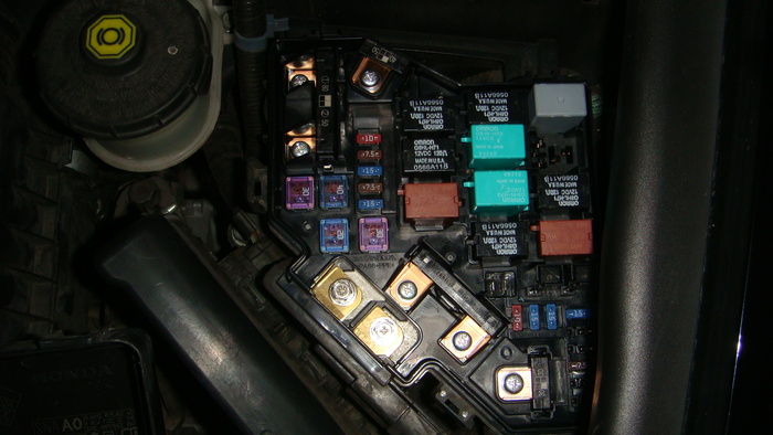

there are several relays there, which one is the blower motor relay and how do i check if its faulty?
Sep 29, 2019 at 2:41 AM (Merged)
DEO
  • 12 POSTS
checked fuse #9 (40A) and its good. checked for voltage on fuse terminal and i got full voltage

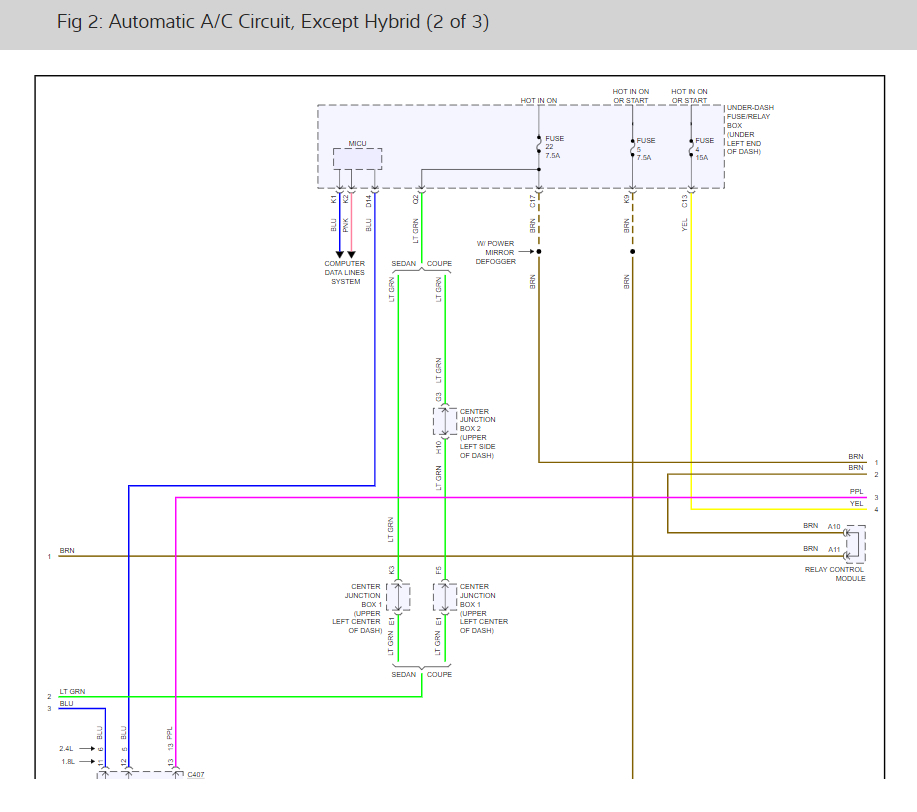

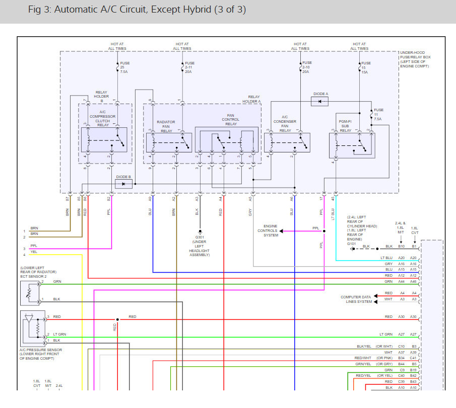

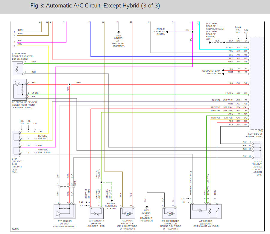

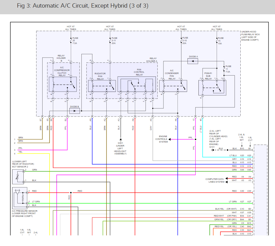

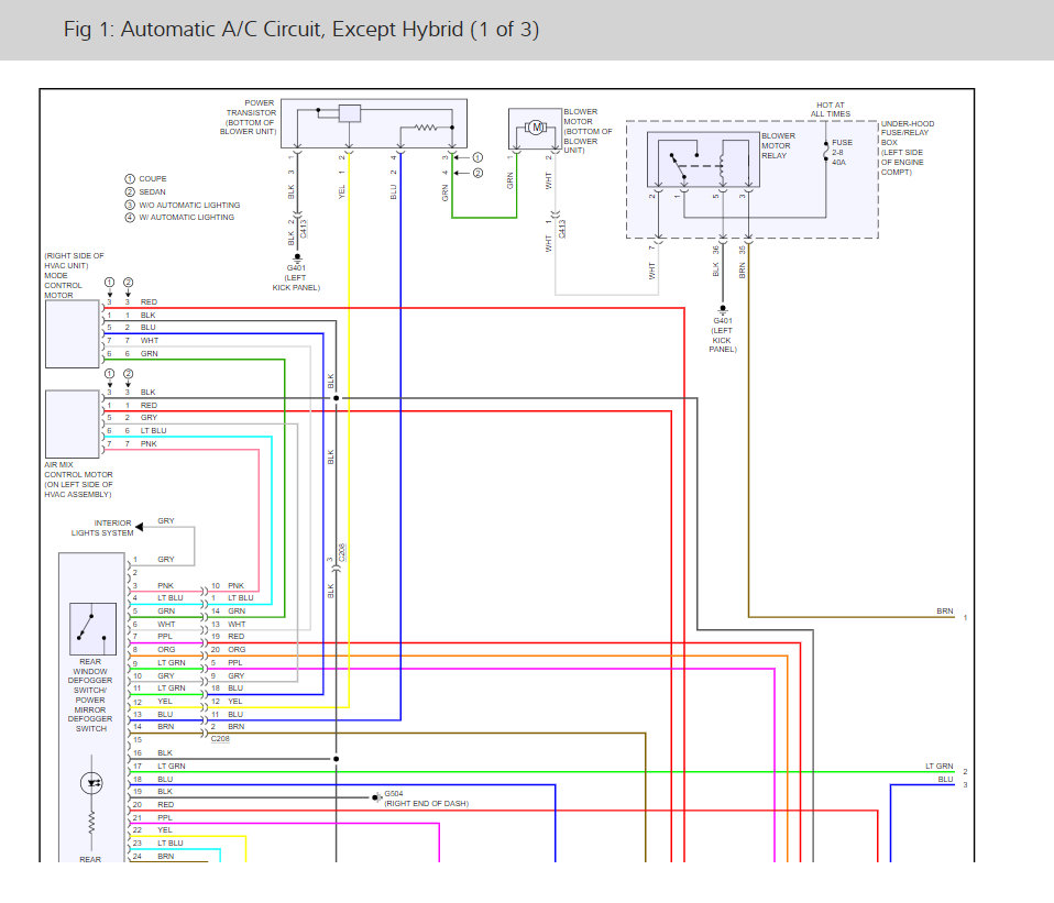

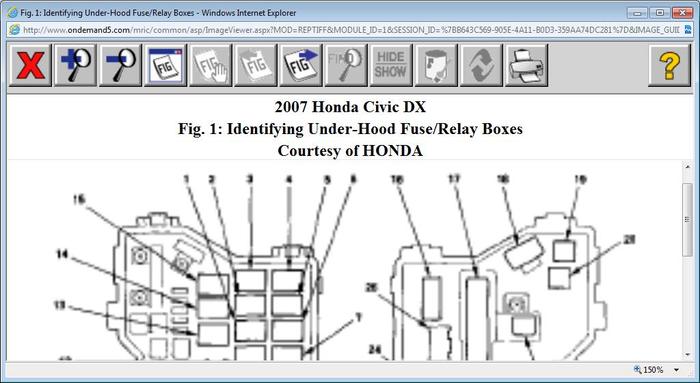

Alright if khlow2008 doesnt beat me to it i will post a diagram showing all the relays when i get home in front of a computer.

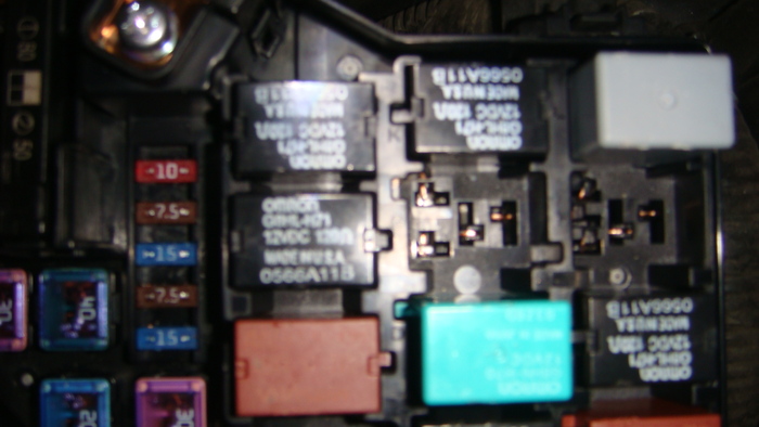

Center row, 2nd relay is the blower motor relay. Diagram seems to be very blurred so no point posting it.

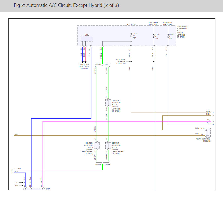

SATURNTECH9
  • 30,869 POSTS

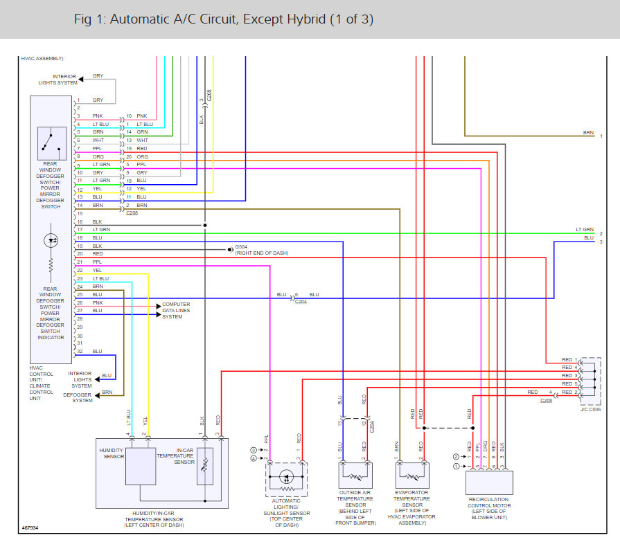

Iposted the diagram anyways i know its blurry but you can still make out the numbers you need.The number is 2 for the blower fan relay and khlow2008 said to swap it with relay number 4.
DEO
  • 12 POSTS
2 and 4 are different relays. 1 and 2 relays are the same and i swapped them out but no luck. also, im not sure which ones are the relay terminals 1 and 2 to try to connect a fused jumper
KHLOW2008
  • 41,814 POSTS
The two terminals that are wider apart would be the terminals to connect.
DEO
  • 12 POSTS
the top left and bottom left terminals?
KHLOW2008
  • 41,814 POSTS
I can't see it clearly but they should be side by side. If you look at the relay pins you would understand. Ensure you have battery voltage at one terminal with ignition OFF.
DEO
  • 12 POSTS
ok i jumpered the terminal on the right and the one in the middle and i got full voltage on the white wire at the blower with the ignition off.

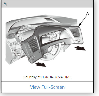

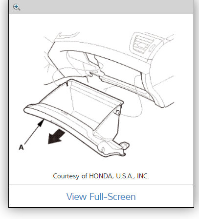

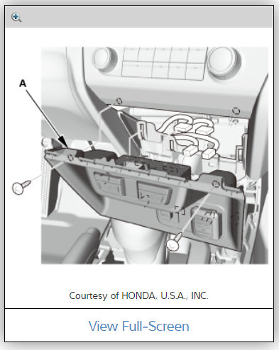

KHLOW2008
  • 41,814 POSTS
Lets forget about previous work and start with this.
HOW TO USE THE SELF-DIAGNOSTIC FUNCTION
The HVAC control unit has a self-diagnostic function for heating, ventilation, and air conditioning system. To run the self-diagnostic function, do the following:
