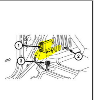

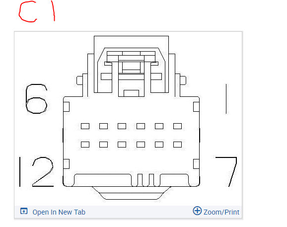

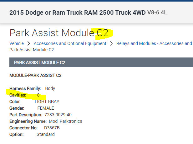

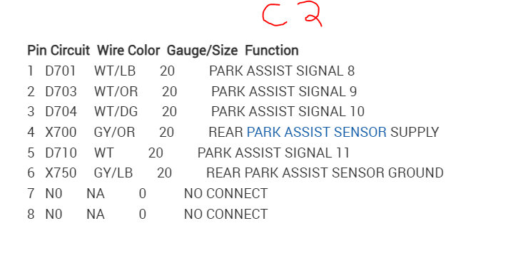

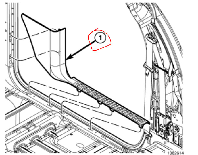

There is a park assist module that controls the different sensors at the rear. The Module is in the vehicle behind the left kick panel.
If you look at pic 1, it shows the kick panel being removed. Pic 2 shows the module itself.

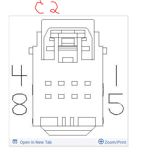

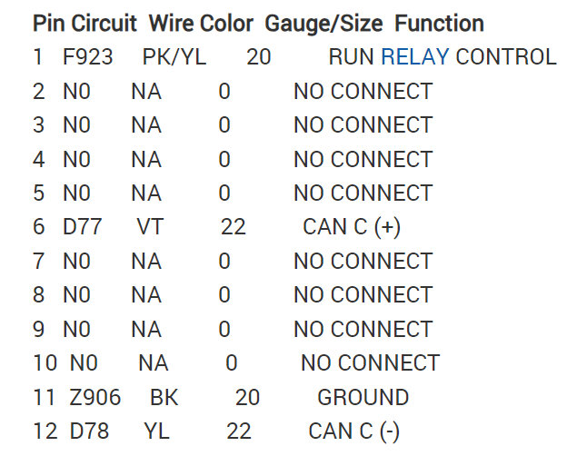

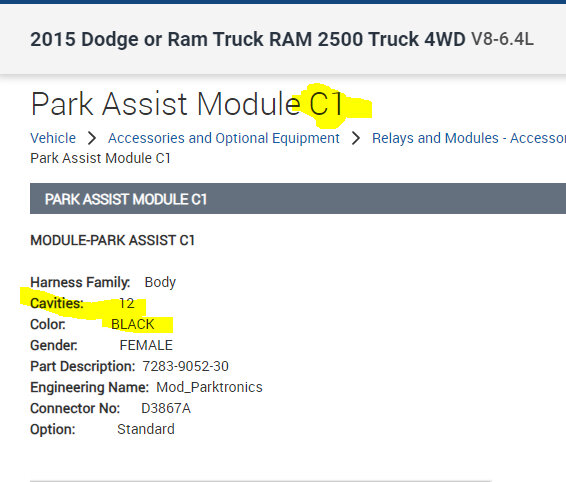

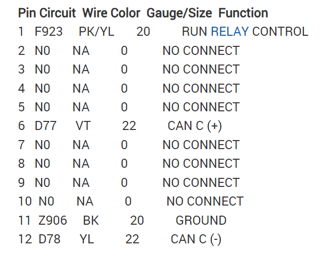

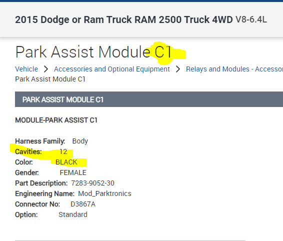

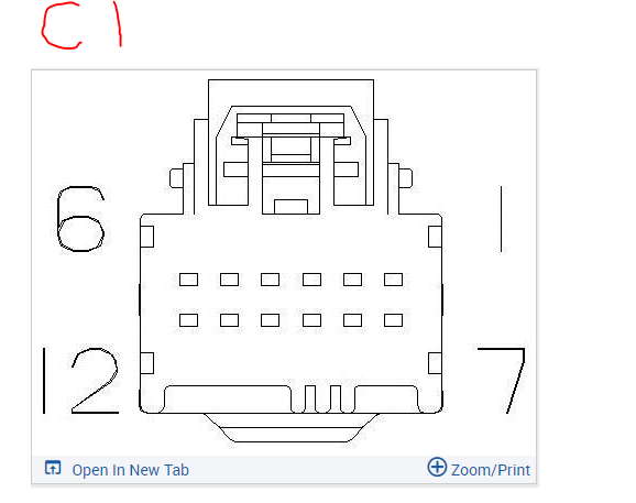

There are two connectors on the module. I attached a pin out of them below as well. This leads me to a question. Did they tell you which sensor was the problem? There are a few. Also, were any trouble codes provided?
See pics below. Note the colors of the connectors. C1 is black and C2 is gray.

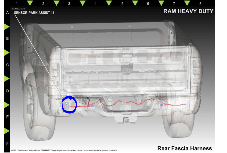

The work order states stored code for sensor 11, cleared codes.
Which sensor is sensor 11?
Feb 29, 2024 at 4:08 AM
  • 110,244 POSTS

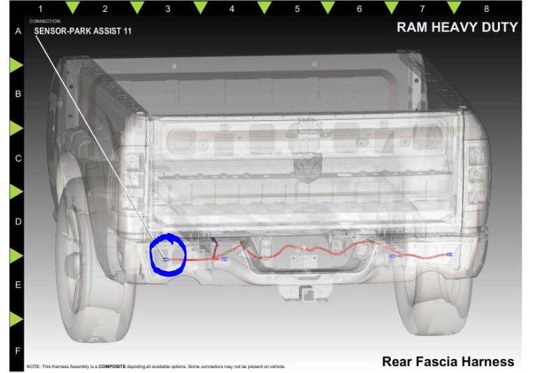

I attached a pic below showing sensor 11. It is on the driver's side.
Check the wiring to the sensor to see if there is any evidence of damage.

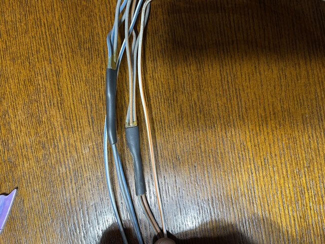

I took that harness off and there is no evidence of wear. I checked every line for continuity and had good continuity from each sensor connector back to the main 6 pin connector.
Feb 29, 2024 at 9:03 PM
SUGARRAY40
  • 36 POSTS
I have also rotated a new Bosch sensor from AutoZone through each sensor position without resolution.

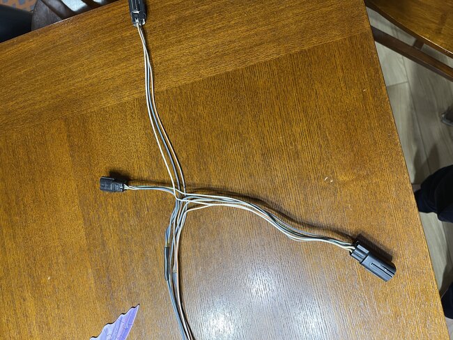

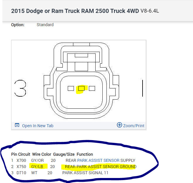

When I check resistance across the pins on the sensor I get these OHM readings: sensor 11 - signal to grey/orange 50.5 ohm, signal to grey/blue 174.2 ohm, grey/orange to grey/blue 131.7 ohm.
I then checked Bosch sensor from AutoZone with readings of 50.9, 184.1, 137.8 ohms.
Then checked sensor 9 and got 51, 184.2, 135.3 ohms.
I don’t know which wire is ground and which is power. In the attached pic the signal wire is the left pin, grey/blue middle, grey/orange right. I checked each sensor connector, and they are all oriented this way.
Not sure this helps, but it’s more information.

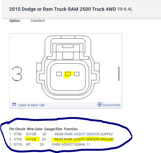

If you look below, I attached a pic of the connector and highlighted the sensor ground pin. Take a look and let me know if that helps.
See pic below.
Mar 8, 2024 at 12:12 PM
SUGARRAY40
  • 36 POSTS
It’s help confirm ground is the center pin.

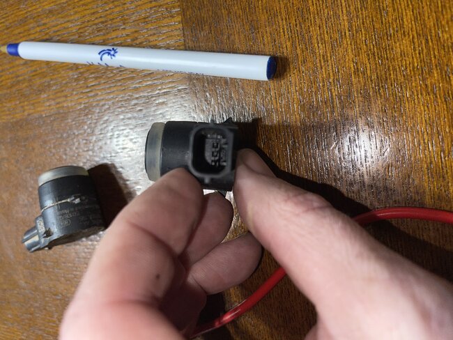

So, I checked the sensor “clicking” today and sensor 11 was clicking but significantly less than the other 3. Also, I didn’t get the proximity alert from sensor 11 like the other 3 as well. So, I swapped out 11 for the Bosch sensor from AutoZone. Short drive to town, 3 miles, and no problems. We’ll see in the morning when it’s supposed to be 25-ish degrees.

So, I have driven all week, in the rain. No problems. I guess it was just a bad sensor 11 the whole time.
