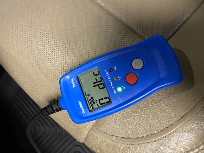

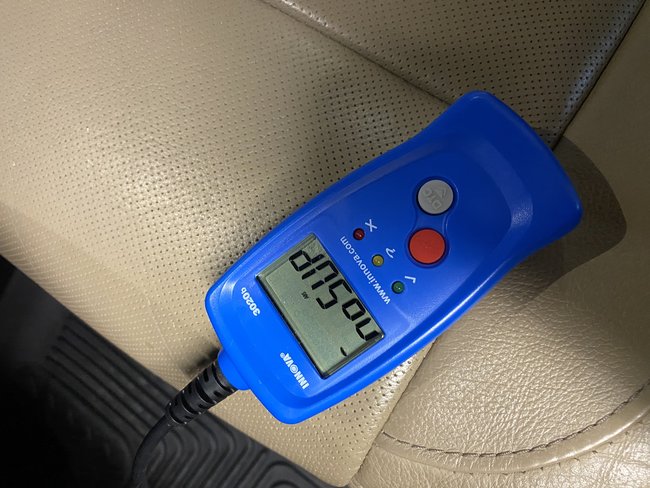

TNBLESSED
  • 5 POSTS
I’m attaching a better video. It took 11 tries to get it to fire this time. I used a small scanner and it came back with 0 DTC. I’ll include the photos of that. I really appreciate your help.

That is all great info. If you notice the light on the push button is flashing when you press it and it fails to start. That is normally a signal that the button is the issue.
However, with the last scan you have more evidence as to what is happening. The B108A is what we need to start with. This is directly for the start button.
I attached the info below for this code. If everything checks out then it may be the BCM but we can get into that next.
This testing is not the easiest and I am not sure your scan tool will do some of this but it is worth looking into.
Things are starting to add up.
