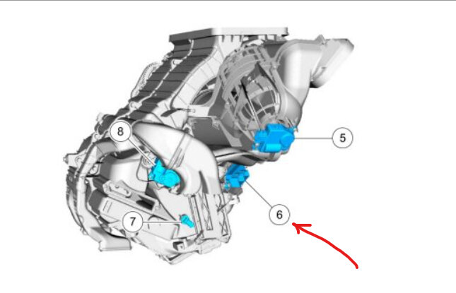

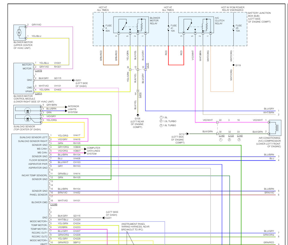

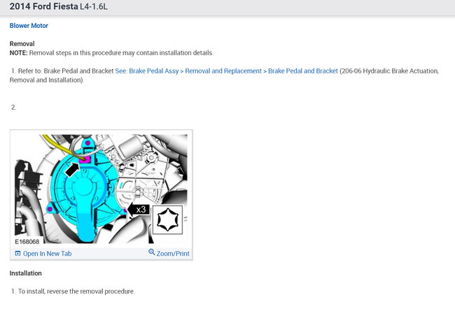

This sounds like a classic blower motor going bad, here is the location so you can swap it out which should fix the problem. Please check out the instructions in the images below. To be sure you can test the blower motor for power and ground and if it has both then for sure the motor is bad, here is a guide to help and the blower wiring diagrams so you can see how the system works. The Yel/Blu wire is power and the Gry/Vio is ground.
This guide shows how to do the testing:
https://www.2carpros.com/articles/blower-fan-motor-works-on-high-speed-only
Check out the images (below). Please let us know what you find.

Yep, that is strange it could be the blower control module, here is the location so you can check it out. I would try tapping on the module to see if it affects the blower operation when the blower is on. Also, we should do a CAN scan to see what comes up, please check out the information below, you can get a CAN scanner (Controller Area Network) from Amazon.
