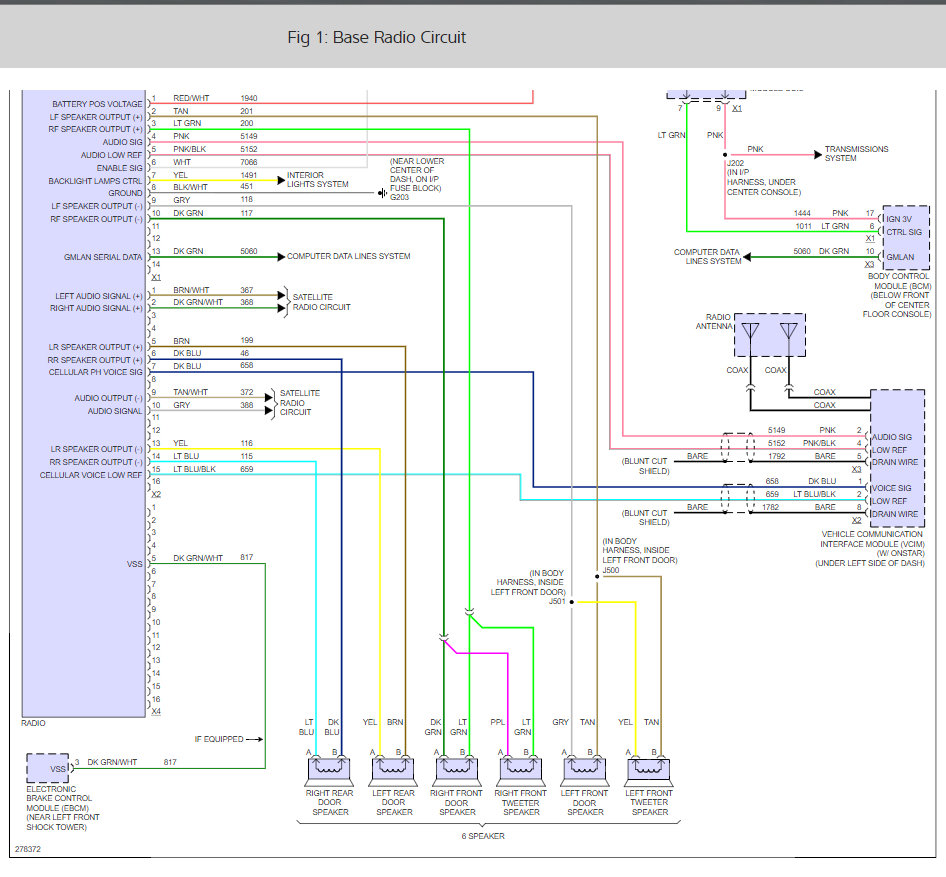

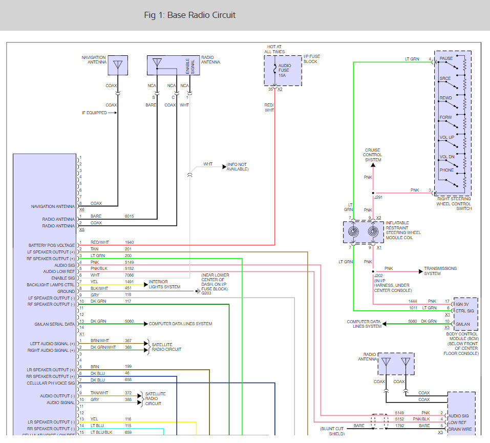

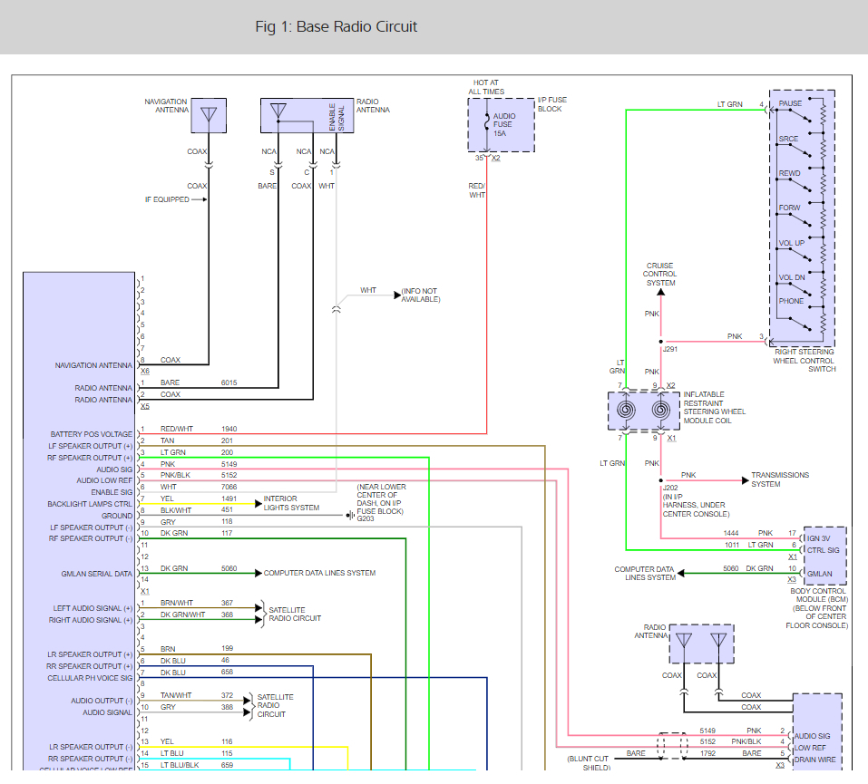

Chances are the problem is with the radio but to be sure you should use a test light on the power and ground circuits while you drive to see if they flicker.
Here is a guide and a wiring diagram to get you started.
