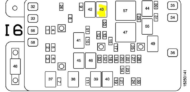

Headlights do not turn on manually but work intermittently when set to auto. This is for both high and low beam. When they randomly turn off I can only get light by pulling and holding signal switch toward me. Then again later for no apparent reason they will start working again.
Nov 17, 2019 at 2:58 PM
  • 110,244 POSTS
Hi.

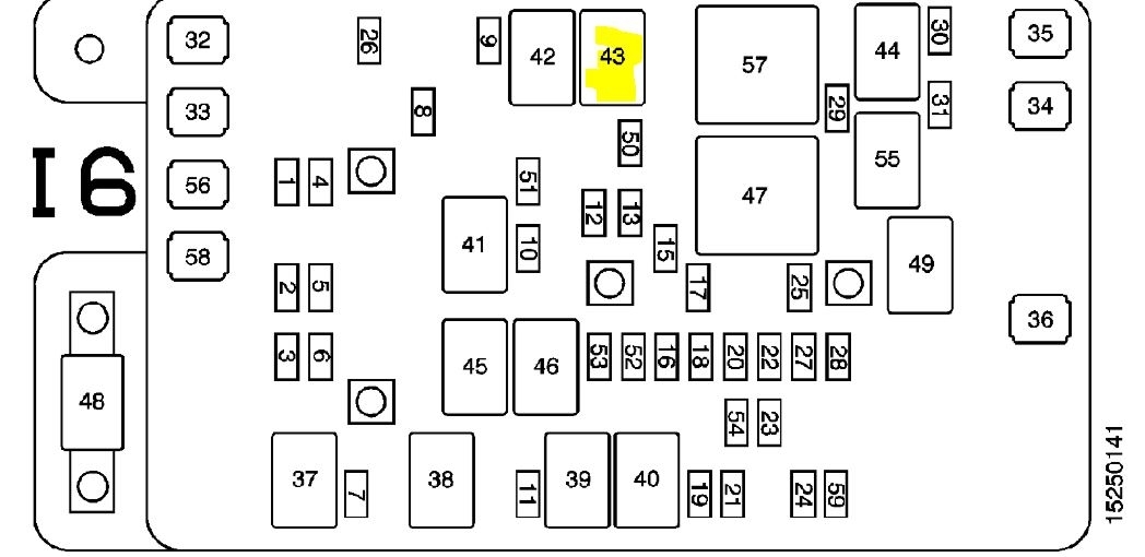

When you pull the signal switch, you are getting high beam only. I suspect it is the switch itself, but there is a relay that can be checked first. It is under the hood in the fuse / relay box. I attached a pic below to help locate it (pic 1).
You have two choices to check it. First, see if there is another relay with the same part number and switch them to see if that makes a difference. Or, here is a link that shows how to test a relay. You will need a multi meter and a test light.
Here are a few links to help if you decide option two:

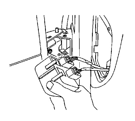

pic 2

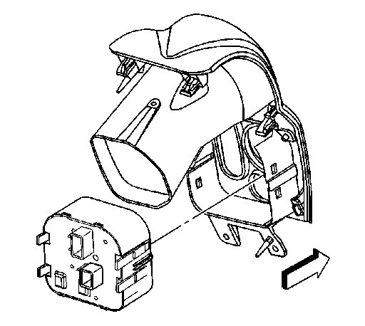

2. Reach into the access hole and release the 4 retaining tabs located on the headlamp switch behind the IP.
pic 3
3. Remove the headlamp switch from the IP, through the IP access hole.
4. Disconnect the electrical connectors from the headlamp switch.
5. Remove the headlamp from the IP.

Relay replaced and same issue. Will order replacement switch and try that. Thanks.
Nov 18, 2019 at 2:01 PM
  • 110,244 POSTS
Most likely, the switch is internally overheating and failing. Let me know if that takes care of the problem.
Nov 19, 2019 at 10:54 AM
NORM.S
  • 10 POSTS
Thanks Joe it did fix the problem.
