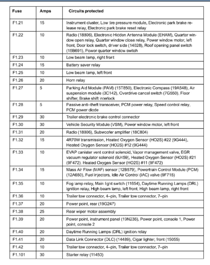

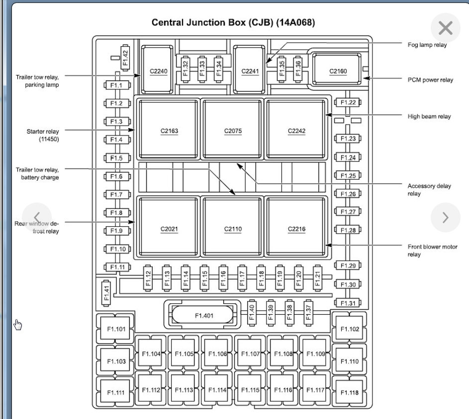

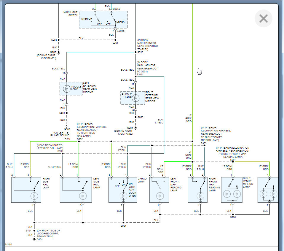

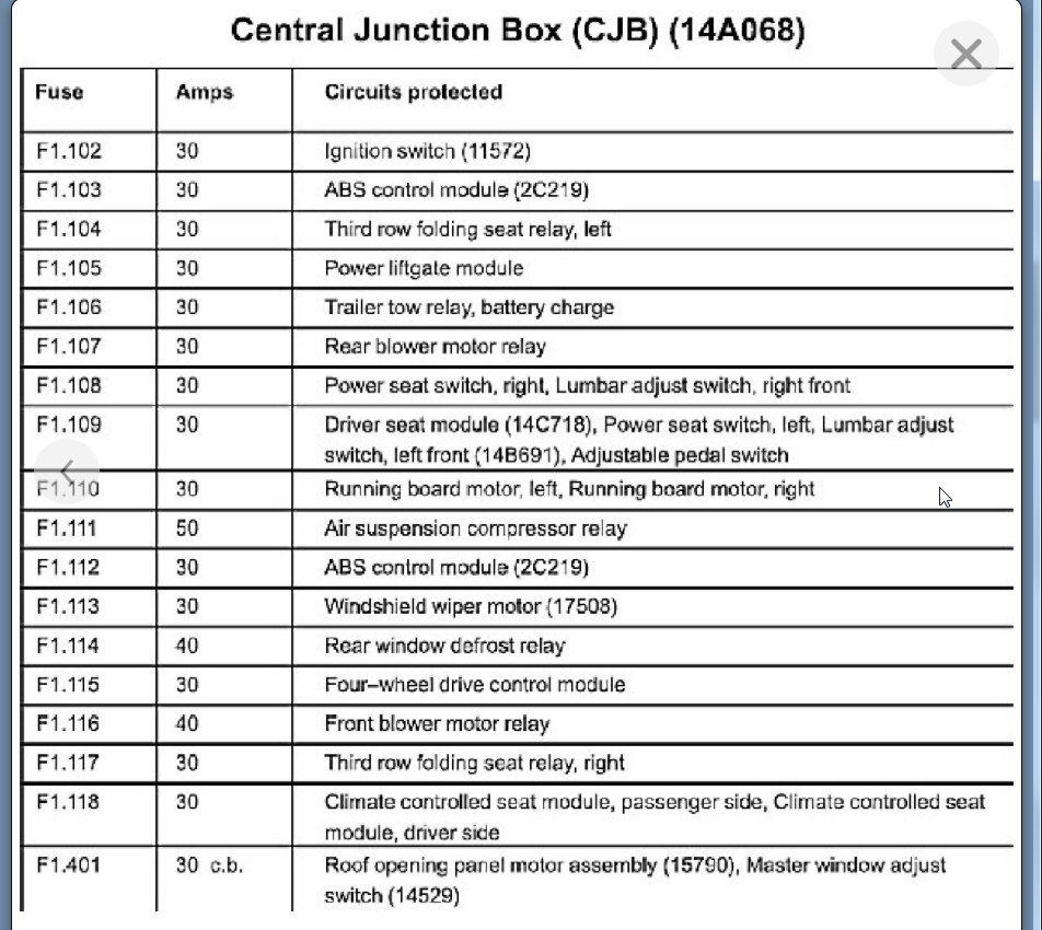

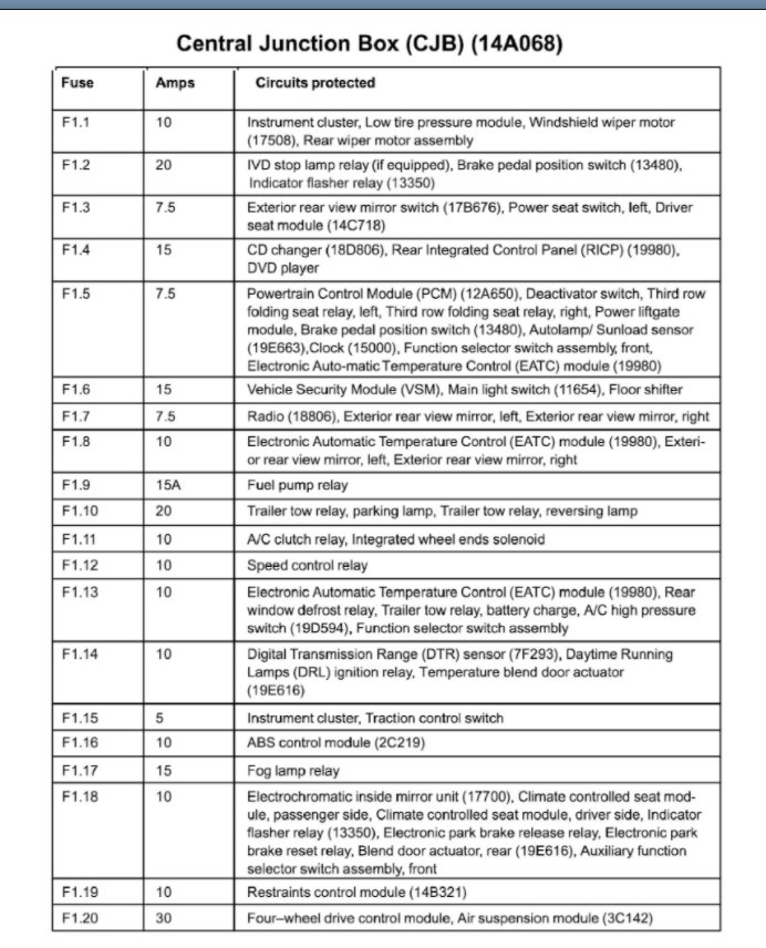

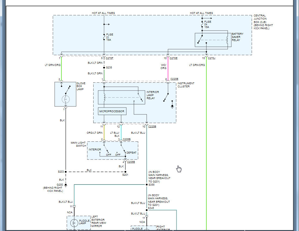

My vehicle listed above has a sunroof and I have told that the weep holes stop working and water runs down on top of GEM and cause problems (dome lights radios door latch parking light) and I get all of them not at the same time. I have not been able to find the GEM. Is there a reset for it?
Feb 20, 2021 at 3:53 AM

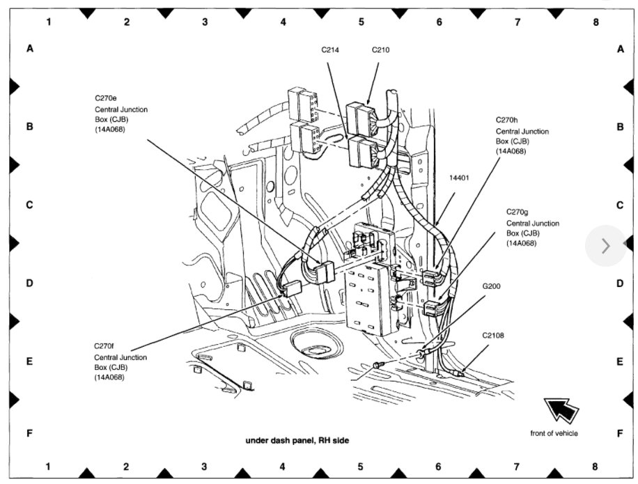

You are correct however, your vehicle does not have a GEM. You have a central junction box that is on the right side kick panel and if your drain is clogged and water is running down the inside paneling it could be into the CJB. If it does you should find water and corrosion inside the connectors or on the relays/fuses.
Take a look at the material below and that will help locate this and identify where these components are. Each of the items you listed runs through this so it is the correct place to start.
Let me know what questions you have. Thanks
