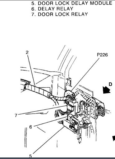

When checking for a short put the tester on the positive cable found a buzzing noise under the passenger side dash. sometimes it goes on sometimes it's not, but that's what's draining the battery. can't find out what it is under the dash that's coming on and off when you turn the ignition on and off doesn't always happen.

There are quite a few things under there. A buzzing could be anything from an HVAC actuator to a relay. Do me a favor, try removing 1 fuse at a time to see if the draw stops. If you determine a specific fuse we will know what circuits are affected. Then we can pinpoint possible components. Also, let me know what side of the dash you hear it from and how quickly it drains the battery.

It is under passenger side of the dash. we did the fuse pulling one at a time still did not find out where powers coming from this is an intermediate problem. when I put the test light on the positive side of the battery sometimes when it's no light comes on there's no noise and then do it again and sometimes the noise will be there light will be on.

The interior fuel box is under the left side, and I think you already know that. On the right side are the actuators for the HVAC. They are vacuum actuated. Is there any way you could record the sound so I could hear it?

It may seem odd, but I hate when I can't find an issue. Could the sound be coming from the other side of the firewall on the passenger side?
I just hung up the phone with a tech I know, and he can't think of anything under the dash on that side that would buzz on the passenger side.

no that's the first thing I checked is exactly where it's coming from. it's above the AC and heater unit.

I just went through everything I could think of. The only thing I even question (because the pic is so vague) is the door lock relay or module. See pic 1. Based on the pic, I believe it to be on the inside right side of the dash. Pull the fuse for the door locks and see if it stops.
Also, and don't laugh, here is a list of components (text description) that I read through 2 times trying to find something located where you said. I found nothing. See if anything stands out to you.

Where is that diagram located?
Sep 16, 2019 at 11:38 AM
ROBERT GIFFORD
  • 18 POSTS
I've been trying to find a relay or something that's above the HVAC.
Sep 16, 2019 at 11:39 AM
ROBERT GIFFORD
  • 18 POSTS
I've been trying to find a relay or something that's above the h v a c
Sep 16, 2019 at 11:49 AM
  • 110,194 POSTS
Welcome back:
According to the manual, the diagram is under the dash on the right side. Also, did you look through that list I sent? There has to be something under there, but nothing is listed. Ugh! I feel your frustration.
I will keep looking.
Sep 16, 2019 at 5:41 PM
