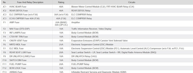

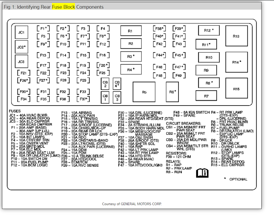

Everything quit working all of a sudden.
no power seats, no power mirrors, no tilt wheel controls.
everything worked fine and all the options just stopped working at the same time.
Jul 12, 2019 at 5:05 AM
  • 55,402 POSTS

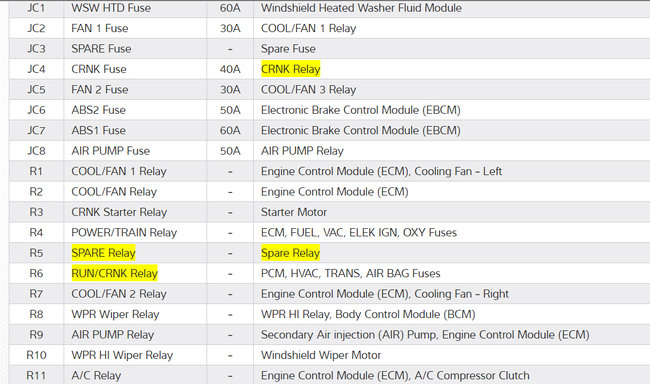

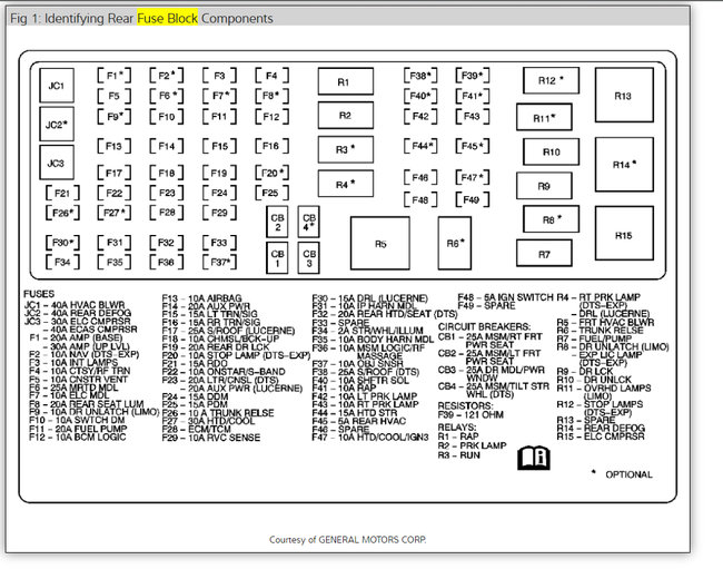

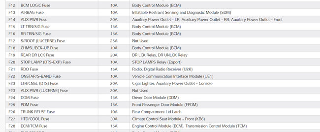

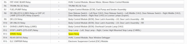

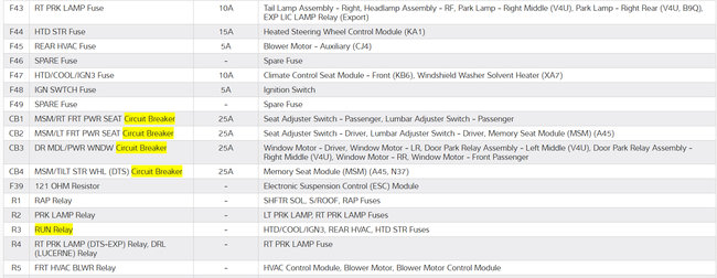

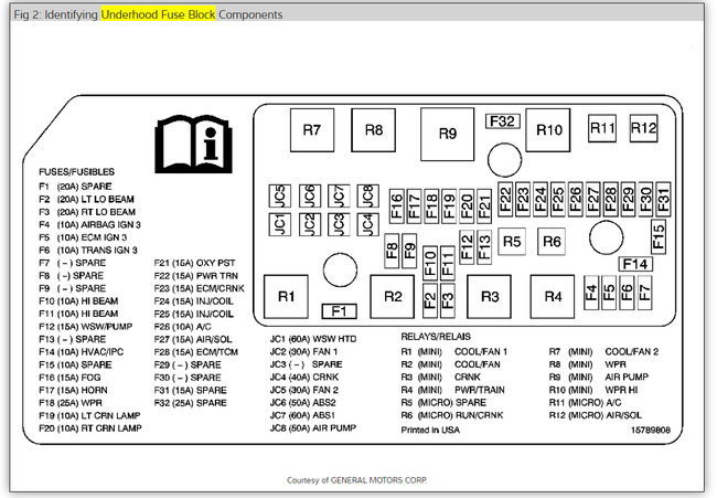

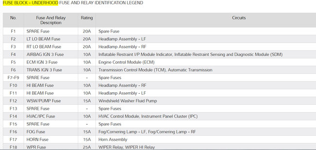

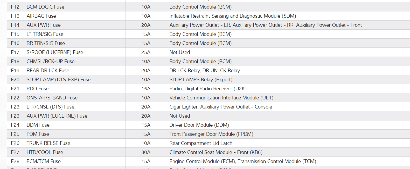

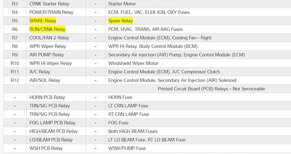

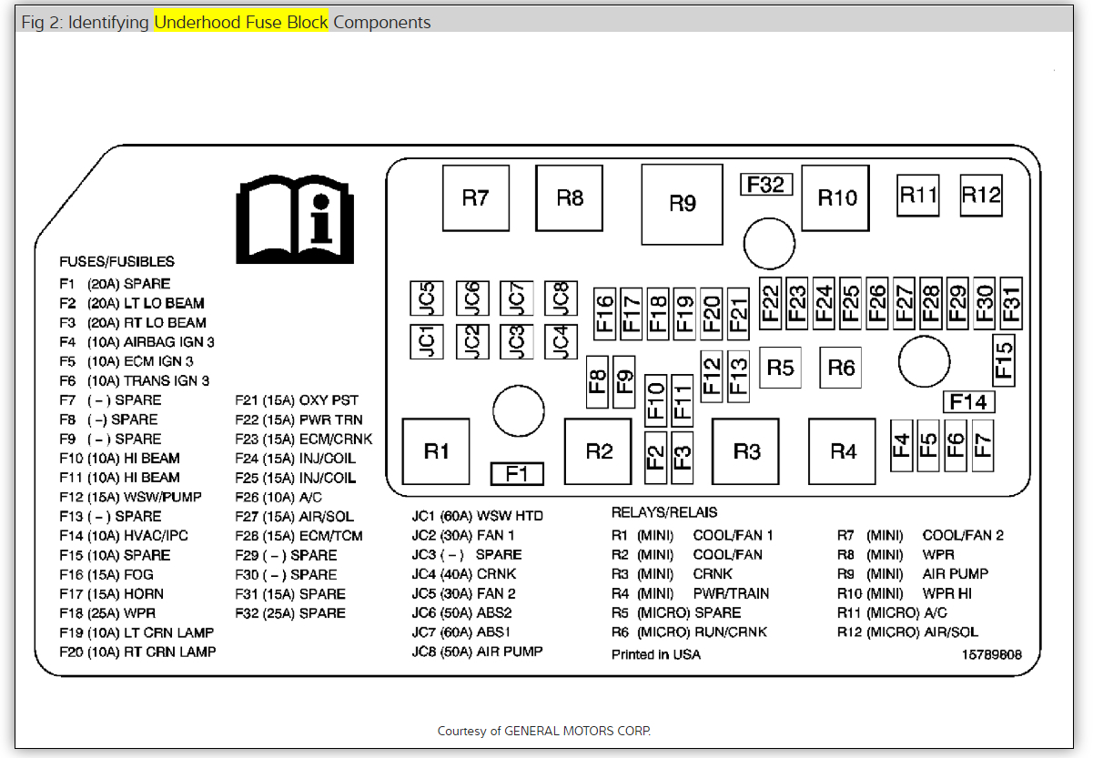

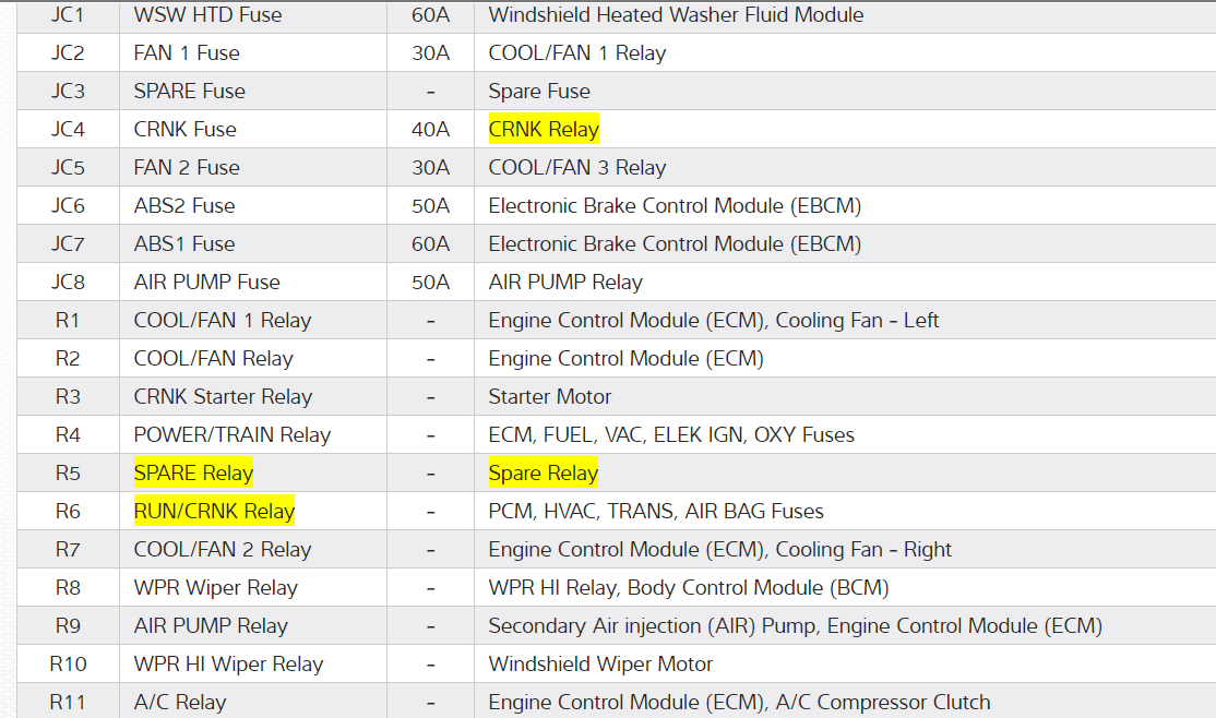

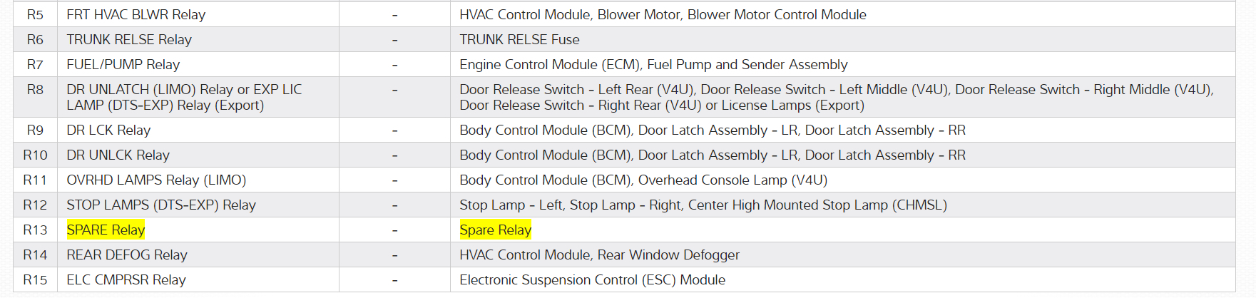

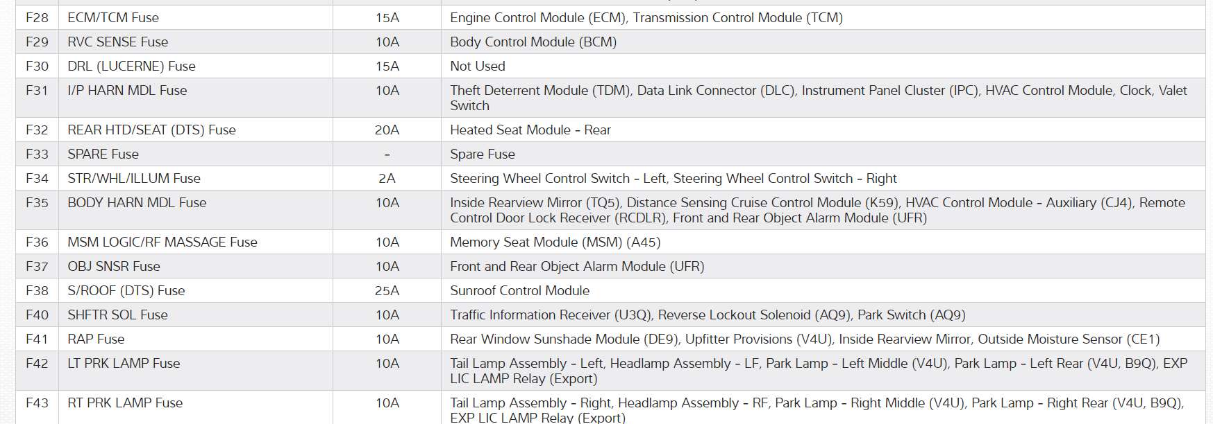

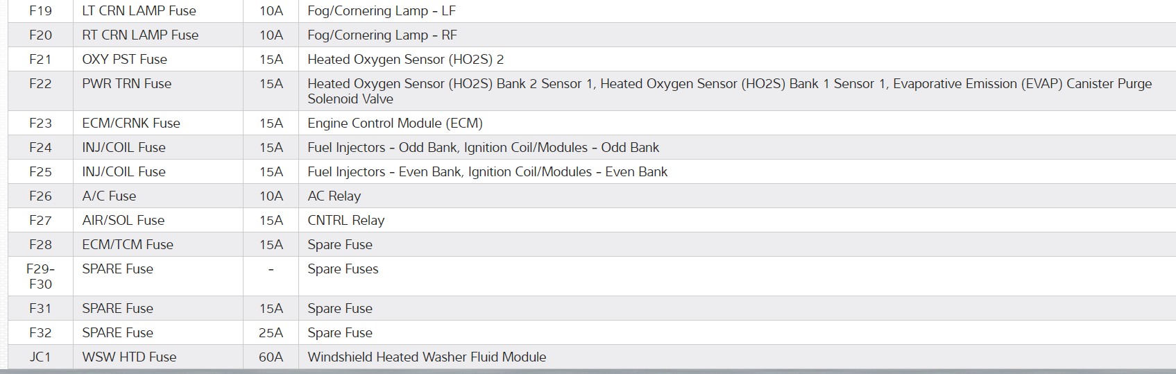

Lets start by checking the fuses. here is a guide and the fuse locations below:
Check out the diagrams (below). Please let us know what you find.
Jul 13, 2019 at 6:38 AM
PCDJ64
  • 127 POSTS
Thank you, there were 2 blown fuses.
replaced with same and now both are working again.
