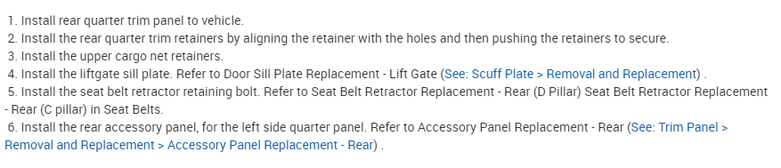

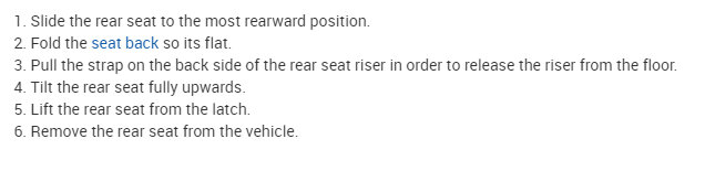

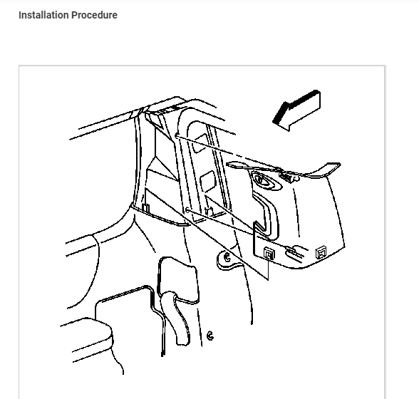

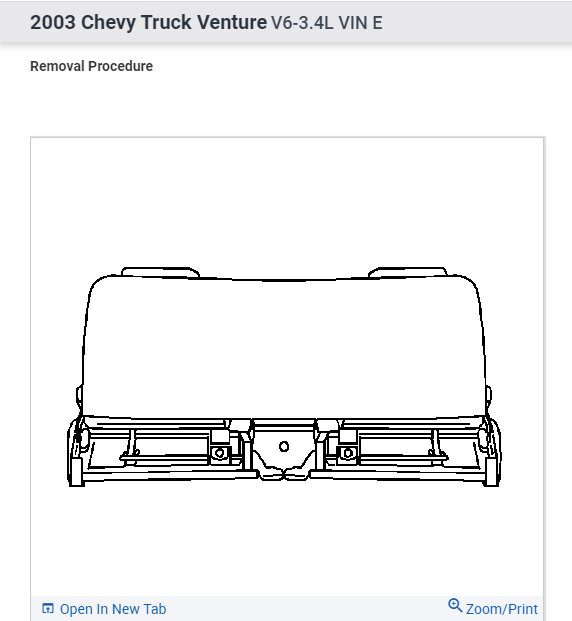

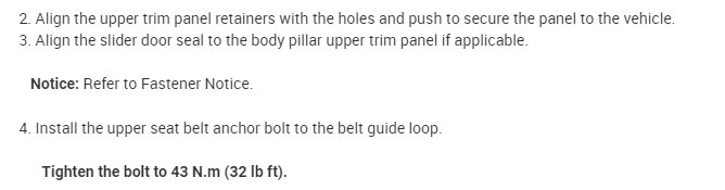

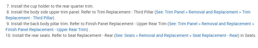

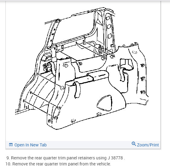

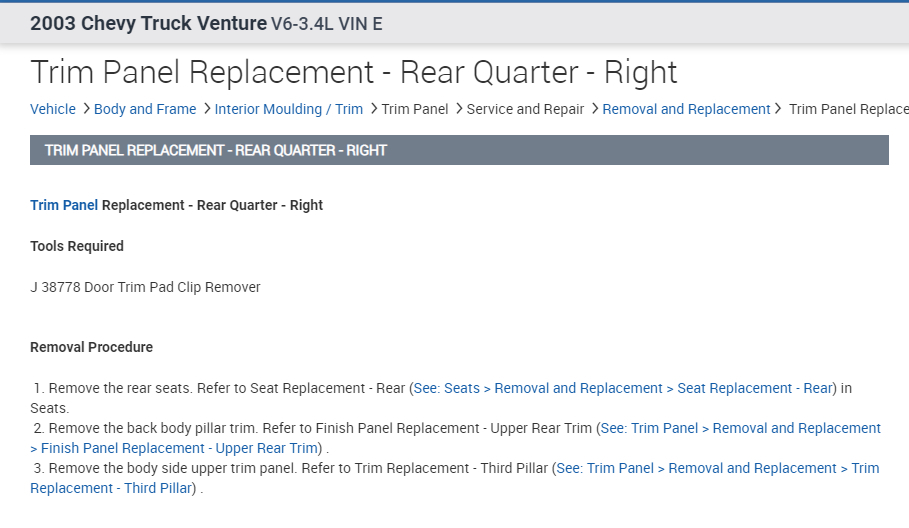

How to remove the interior plastic?
2003 CHEVROLET VENTURE
75,000 MILES • 6 CYL • 2WD • AUTOMATIC
BRUNO NEIS

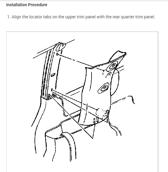

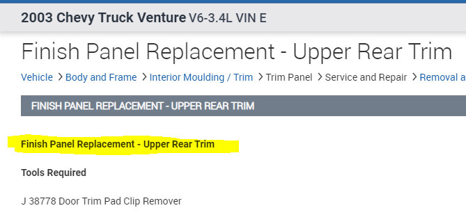

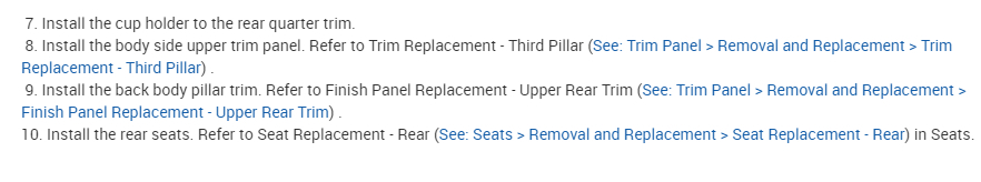

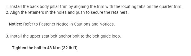

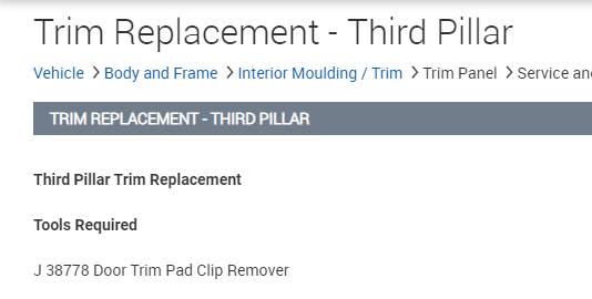

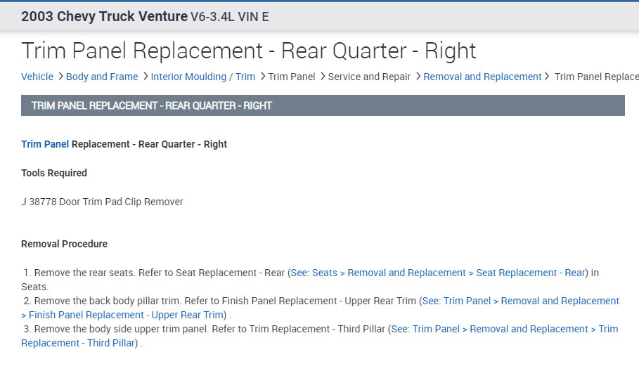

rear panel behind sliding door removal.
Nov 19, 2022 at 7:16 AM
  • 110,194 POSTS

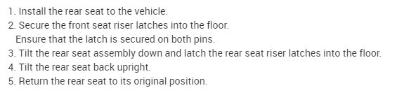

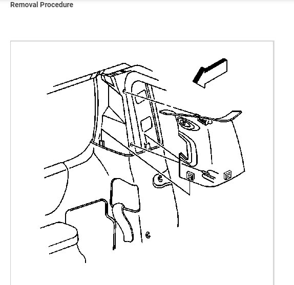

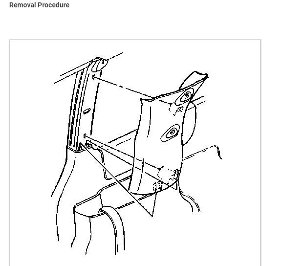

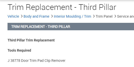

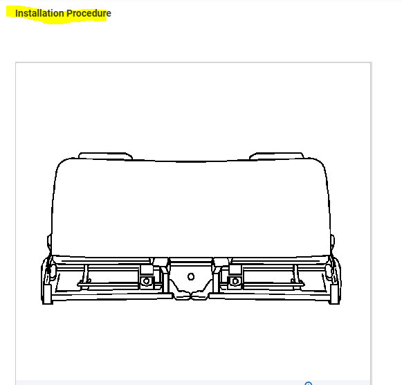

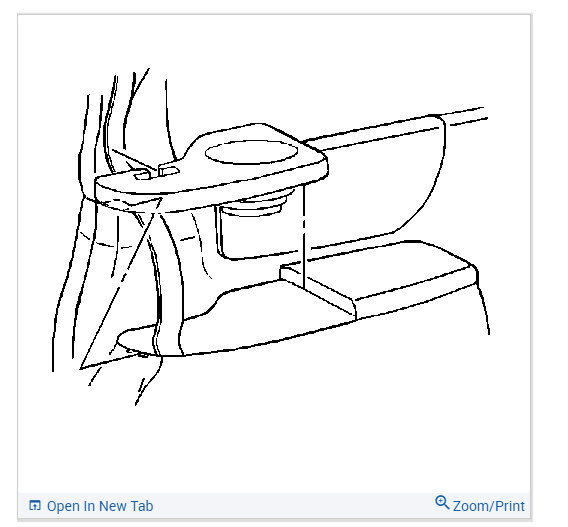

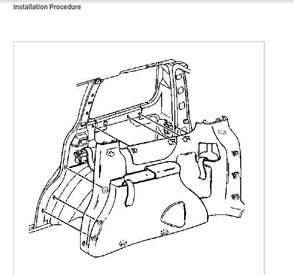

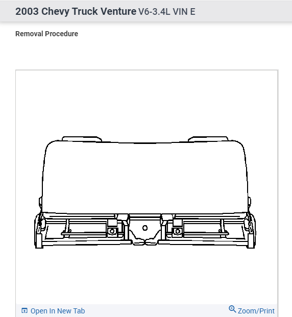

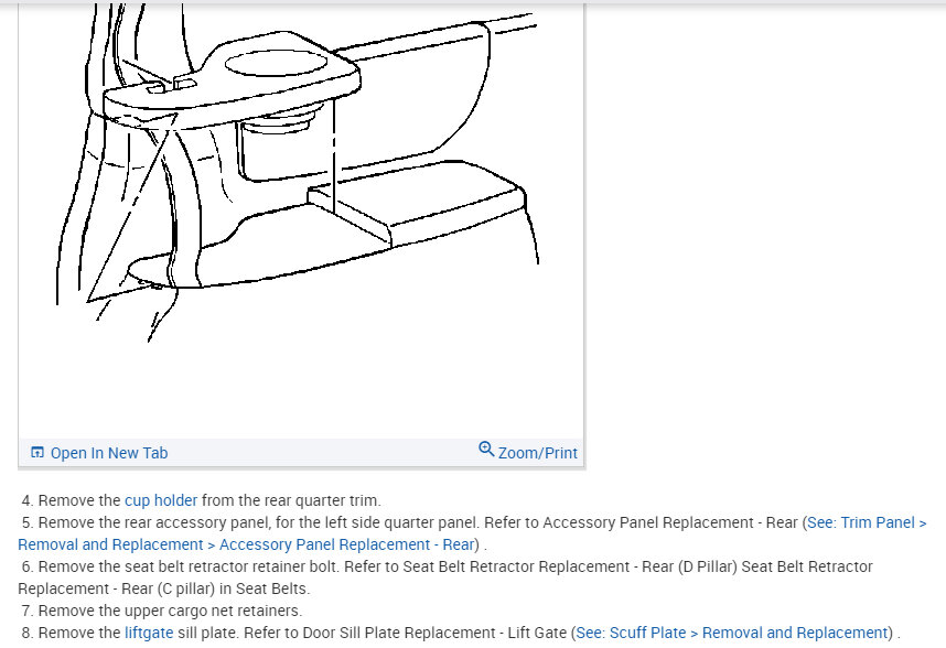

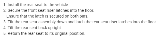

Before you remove the trim panel, the seat, upper trim panel, and the rear body pillar trim needs to be removed first.
If you look below, I attached the directions for all of the items I mentioned. Will place them in the order of removal.
