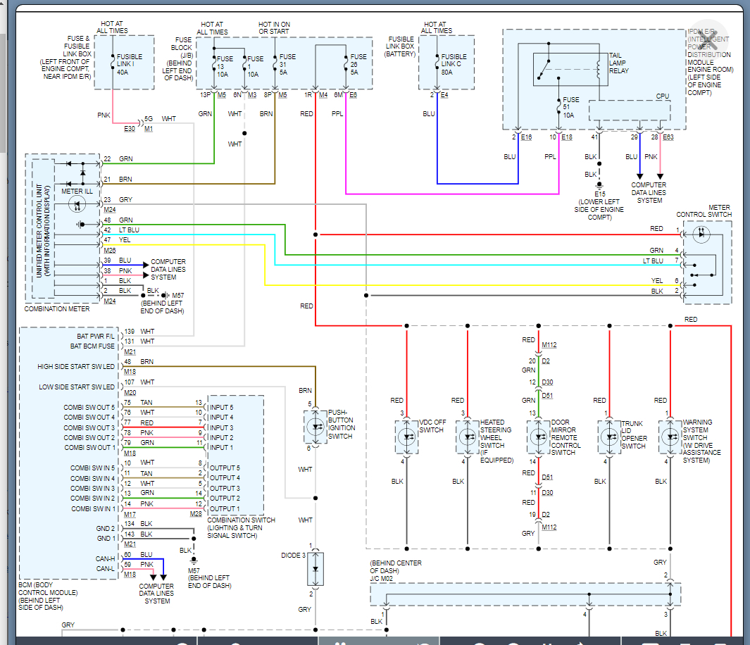

When my headlights are on or in auto my dash odometer, tachometer lights and my A/C panel light does not work. If I turn my headlights off everything works fine. Also each time i restart my car my trip mileage resets. I've checked a bunch of fuses interior and under the hood finding none burnt. Any thoughts?

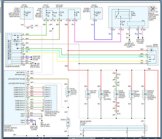

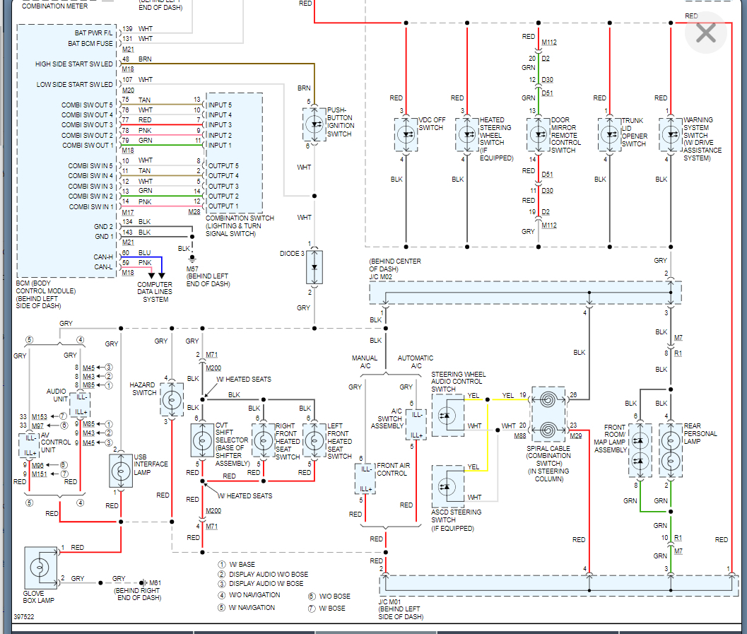

Both of these functions are controlled by the body controller so I suspect we have an issue there.
Basically the BCM is going to control the lighting based on the switch input. Some vehicles will adjust this lighting on sunload as well but it looks like your vehicle uses that only for A/C operation.

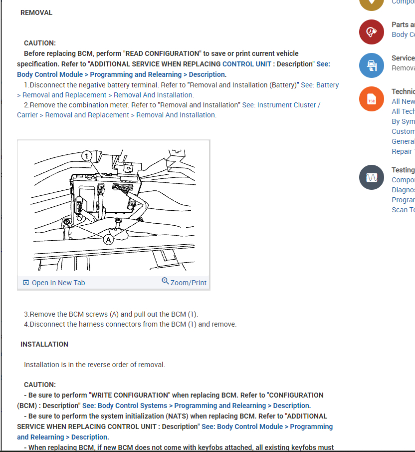

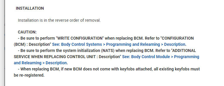

https://www.2carpros.com/articles/how-to-replace-a-bcm-body-control-module

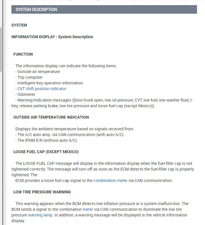

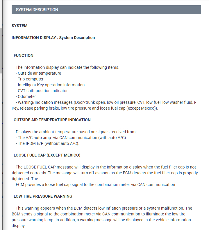

Looks like to me that we are going to need to replace the BCM but the only thing that gives me pause is the fact that the manual does not state that the trip meter is BCM controlled. It lists it under the Trip computer under the cluster operation.
This is not the cheapest part and not the easiest to confirm this. We are going to need to use a scan tool and monitor the BCM inputs and outputs in order to confirm this.
However, you should have a push button start. This will have a halo around it, does this work properly? That may give us a little more info to be more confident if you don't have a scan tool that can monitor the BCM.

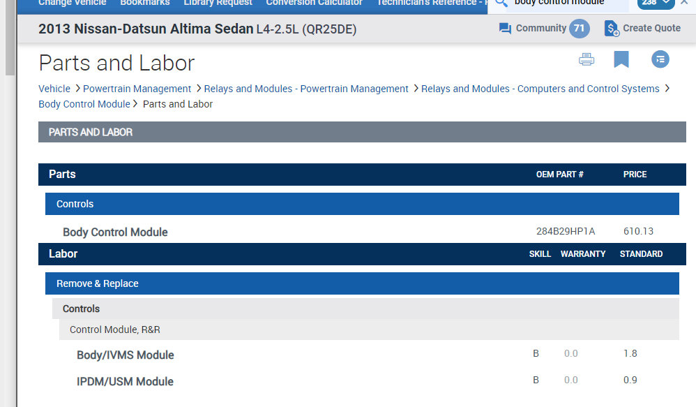

The ignition is illuminated when the headlights are off but when the headlights are turned on it shuts off as do the other lights. What level of scan tool would I need for the scan? The dealer wants $200.00 for the scan and print out. Any ideas on how much a new BCM?

Based on the fact that the ignition does the same thing tells us that the BCM is doing this but the only question left would be, is there a sensor or something telling the BCM to do this? This would be what we need the scan tool for though.

As for the cost of the BCM, it is about $600.00 but you may be able to find one cheaper. I attached the part number below.
