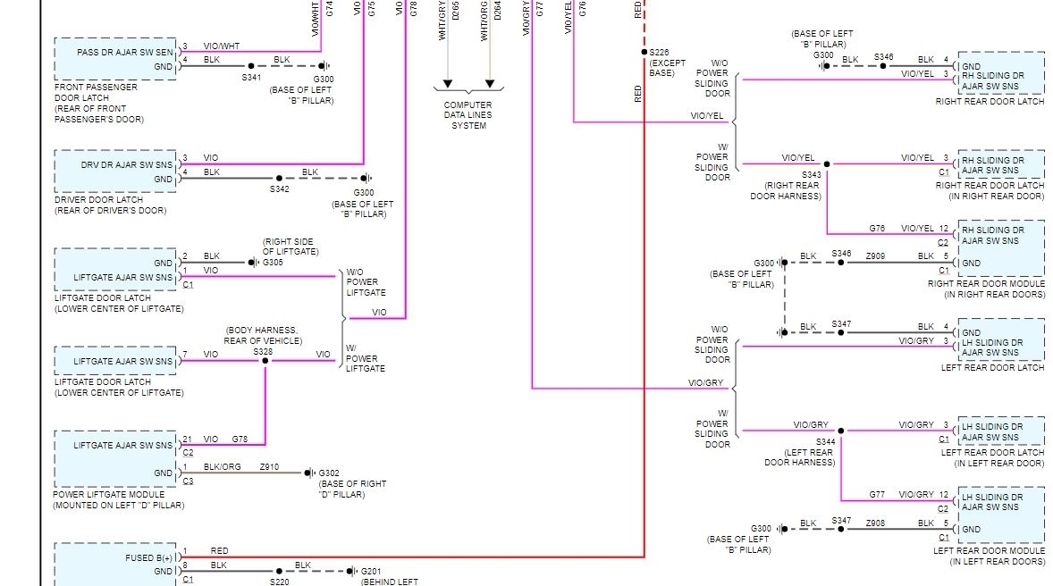

We have checked fuses and everything. we're stuck .none of the lights on the inside want to go off when we turn it off and close the doors.

Hello, the first step you want to try is go through and unplug each door switch one at a time, most likely a door switch is sticking causing the lights to stay on. They usually have a small screw to take out and then unplug the switch. Each door has one. Try this and get back to us. Here is a wiring diagram to help.
