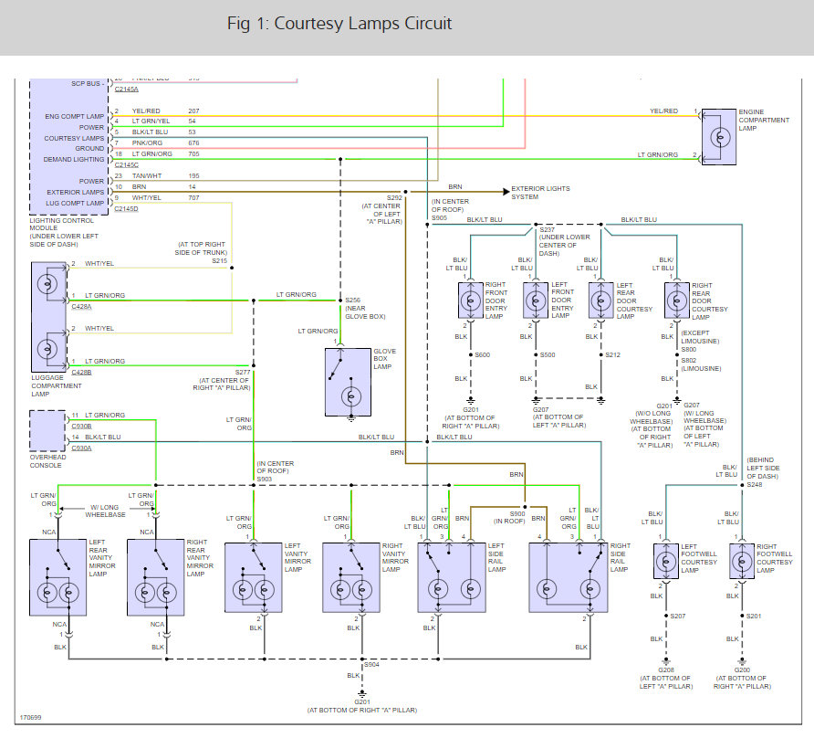

I had to jump battery. Now all interior lights stay on. So now until Wednesday when i have appointment for car i have to keep disconnecting the negative cable. Then the car has to relearn every time I hook it back up. Help!
Feb 4, 2018 at 2:22 AM
  • 55,732 POSTS

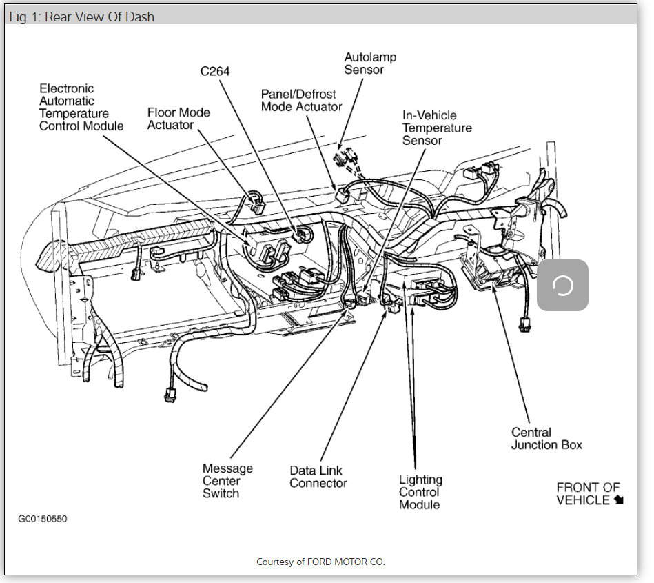

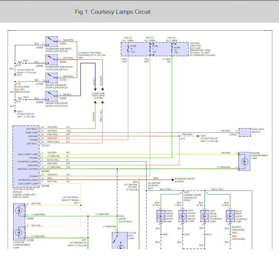

Yes, that happens, the lighting control module is shorted out due to a voltage spike. Here is the location and the interior light wiring diagrams so you can see how the system works.
The lighting control module is located under the dash.
Check out the diagrams (bbelow).
