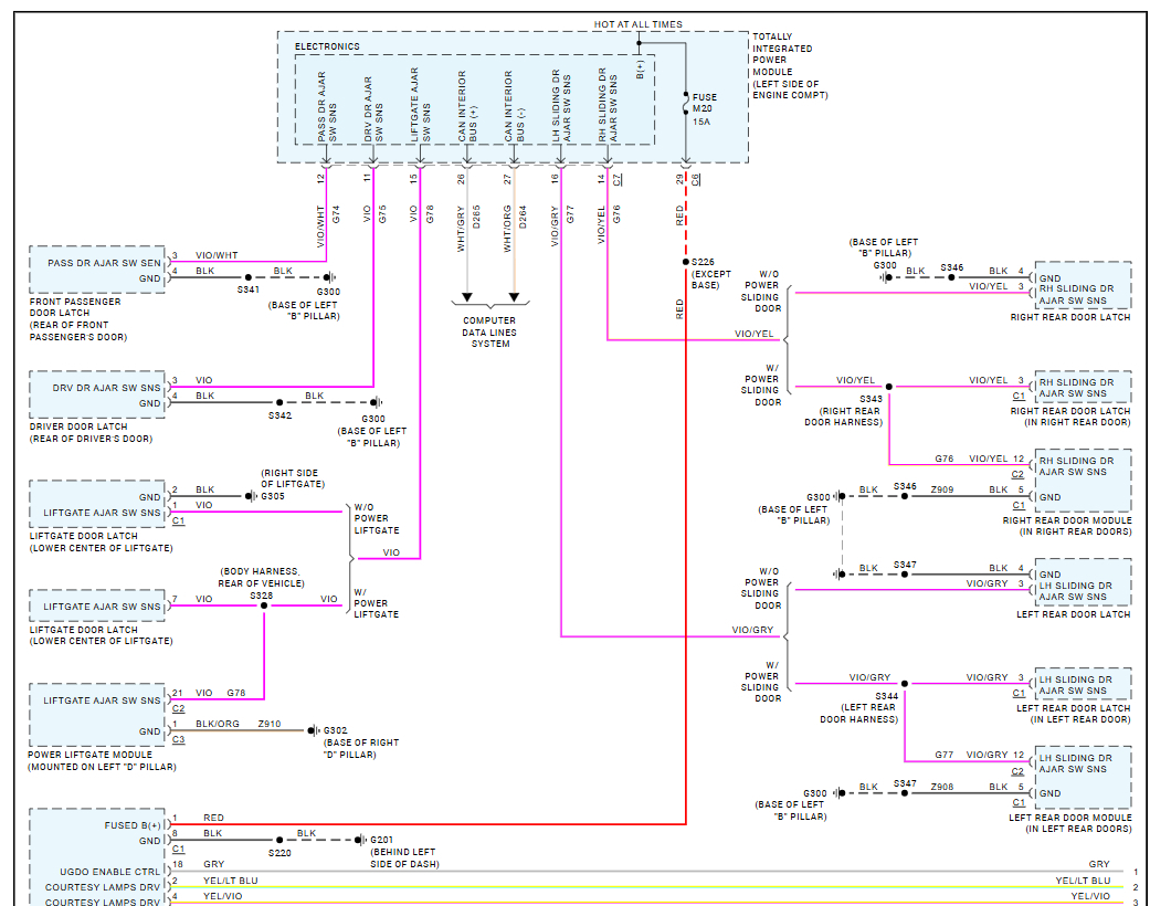

my interior lights in the passenger aera and console are not working. what could be the problem?

The first thing I would do is check the fuses, this video will help and the fuse location is in the fuse panel under the hood, m20
https://www.youtube.com/watch?v=G-xNK79Wa-w
There is a chance the TIPM is out, here is the wiring diagram so you can see how the system works. Check out the images (below). Please let me know what happens.
Image (Click to enlarge)
Jul 4, 2026 at 7:32 AM
