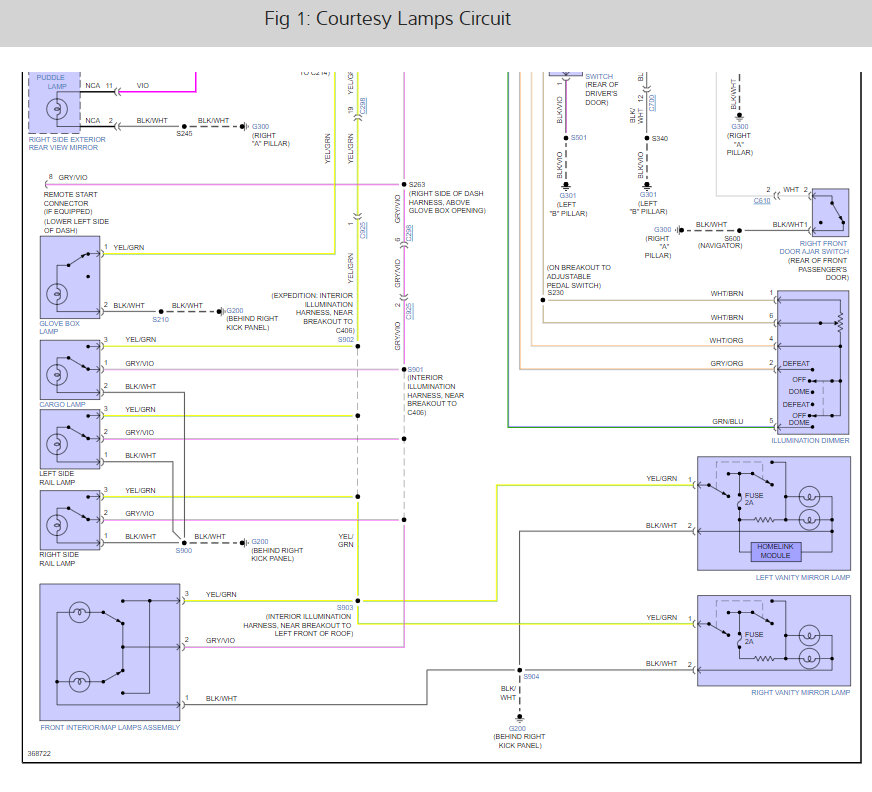

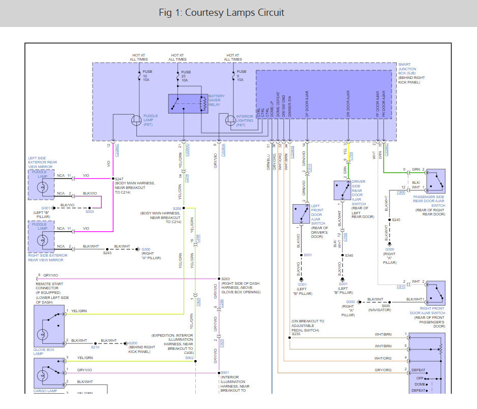

My interior lights will only come on when either of the doors open. But if we try to turn the light individually it will not turn on. Also, when either door is opened and we click on any light, the light immediately turns off.

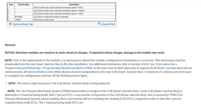

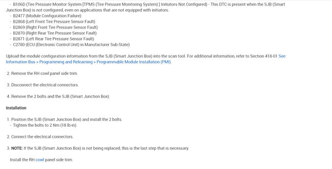

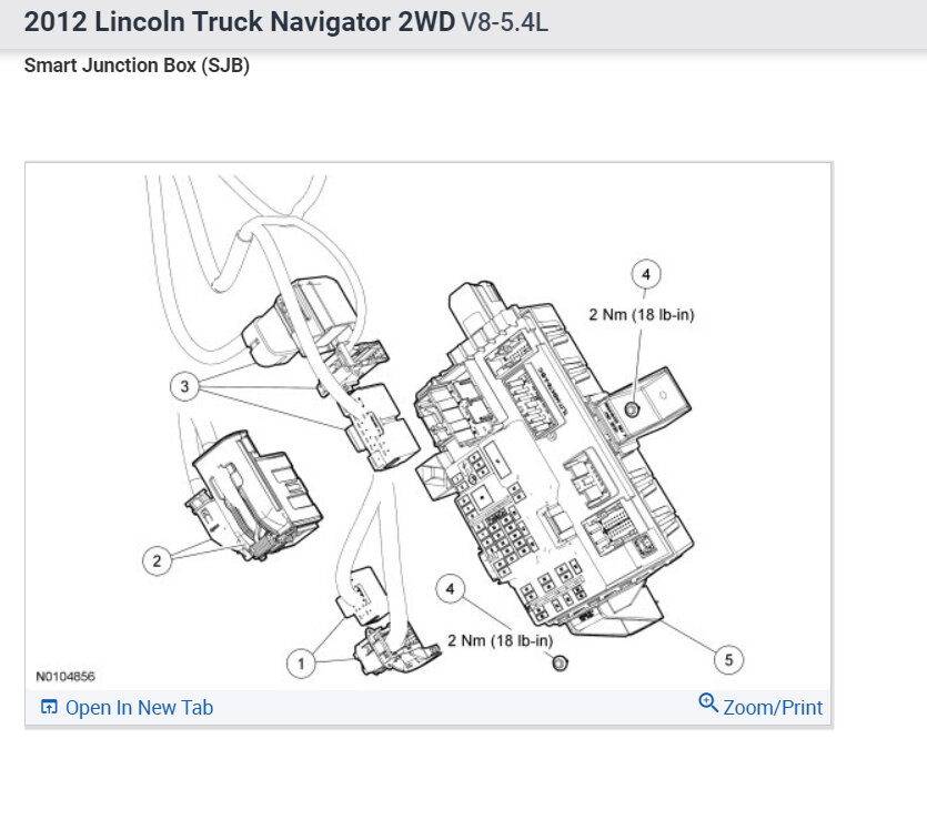

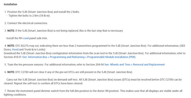

This happens when the SJB (smart junction box) goes out, but to be sure we should do a CAN scan which is easy. You can get a CAN scanner (Controller Area Network) from Amazon from about $32.00.
https://youtu.be/u-4syLc-ifQ
and
Amazon CAN scanner link:
https://amzn.to/3sX8MCX
Here are the interior wiring diagrams so you can see how the system works and how to change out the SJB as well. Check out the images (below). Please let us know what happens.
