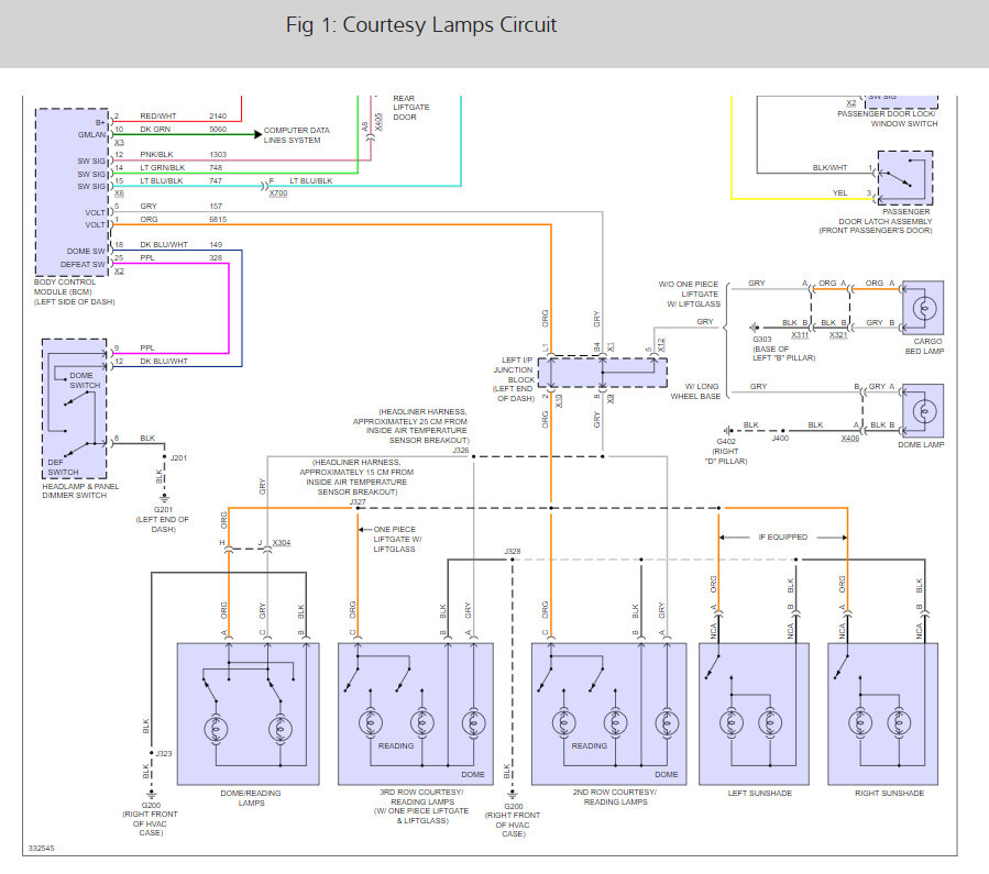

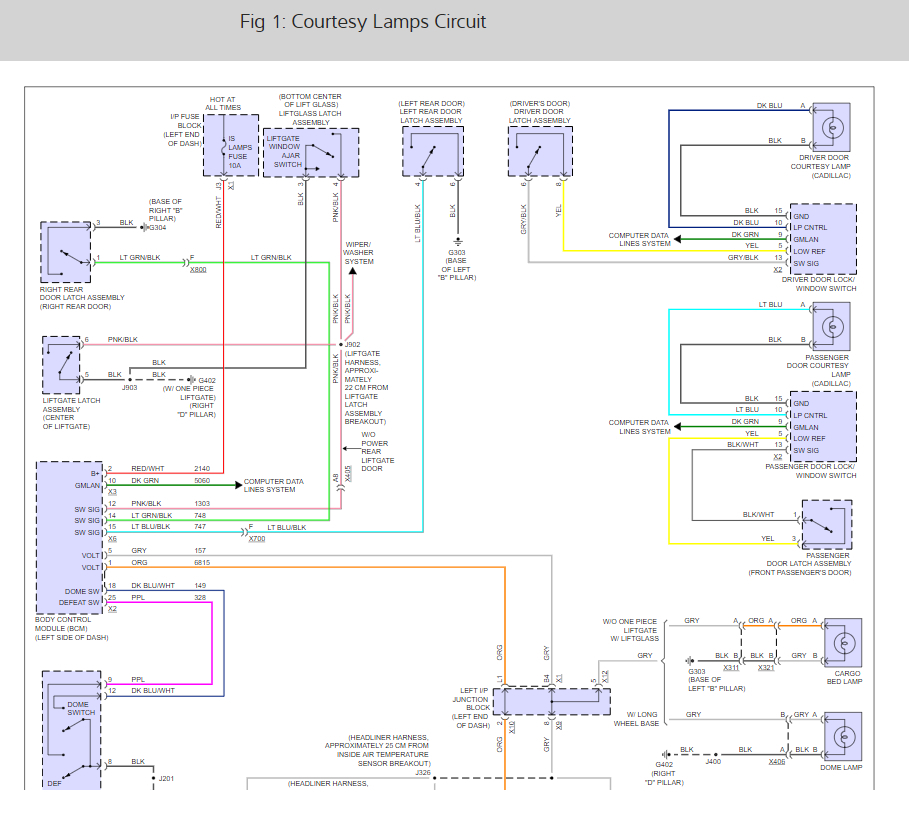

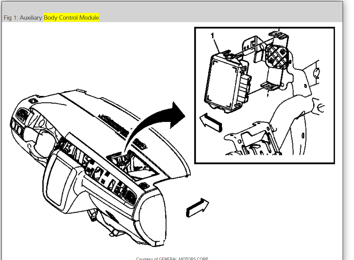

Hello! When i just open and close the rear glass hatch to get stuff out of the back my interior lights never shut off. So I then have to go open and close a door for then to go off.
Is there a faulty sensor back there or a switch is on the wrong setting maybe?
Jun 5, 2019 at 3:20 AM
  • 55,433 POSTS

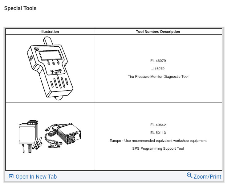

Either the switch at that particular door has gone bad or you have a BCM that is going out. To be sure here are the wiring diagrams and a guide so you can test the circuit and the BCM location with replacement instructions below:
Remove the knee bolster. Refer to Knee Bolster Replacement (Except Cadillac) , Knee Bolster Replacement (Cadillac)
1 Body Control Module
Remove the BCM cover.
Disconnect the electrical connectors.
Press on the tabs to release the body control module.

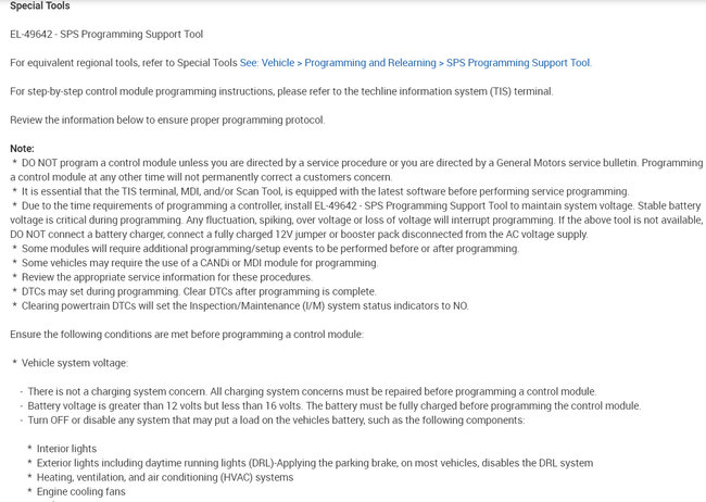

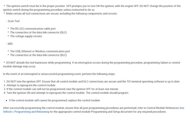

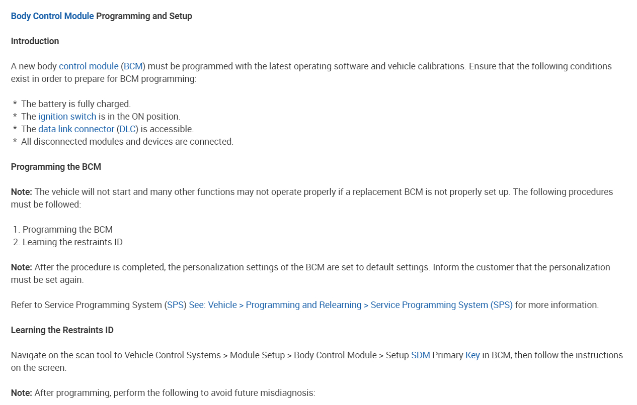

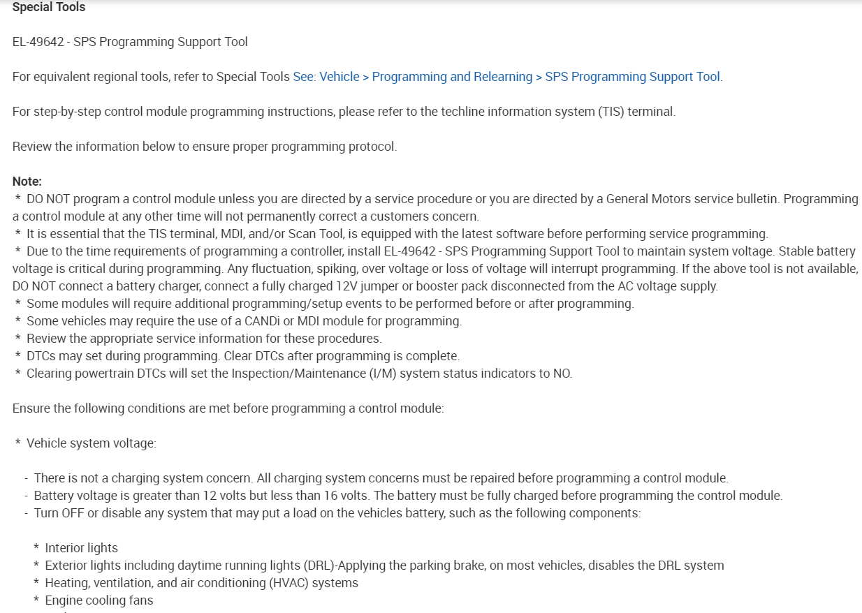

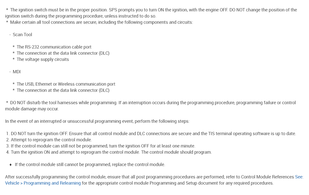

If a replacement module is installed, program the module. Refer to Control Module References .
