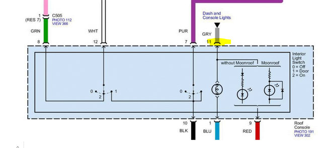

All the other interior lights work just fine, but the two little lights above the windshield (above the center console, by the moonroof, etc.,) won't turn on. I've replaced the bulbs a few times and they simply won't work. Ugh, help! (please!)

Have you checked to see if there is power at the light sockets? Also, I attached a schematic of the light wiring (I hope I got the correct lights). What I will need you to do is check to see if there is power to the gray wire to the lights shown in the schematic.
Here is a link that you may find helpful:
Let me know what you find.
