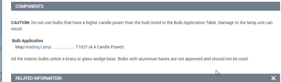

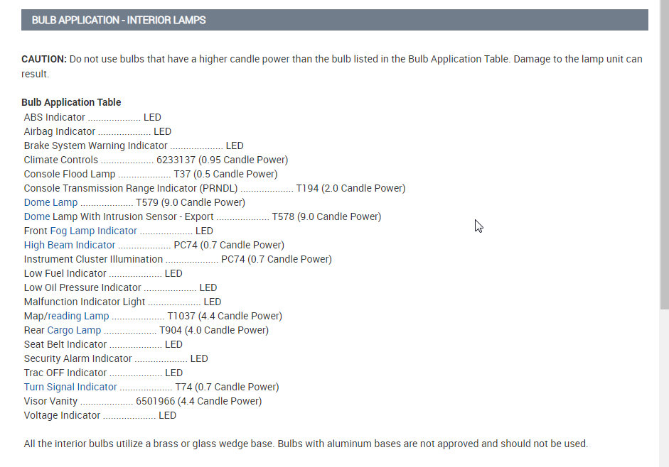

Which specific ones are you trying to access? The reason there is no material out there is because the manual doesn't have specific instructions on the interior bulb replacement. Basically they figured the technicians at the dealers would figure it out.
However, each has a trick that we can figure out for each once we see what type of lamp it is.
Can you get pictures of each of them and I will get you the info on how to get them off?
I attached the bulb specifics below for each of these so that you can be sure to get the proper replacement in the color that you want. Thanks
