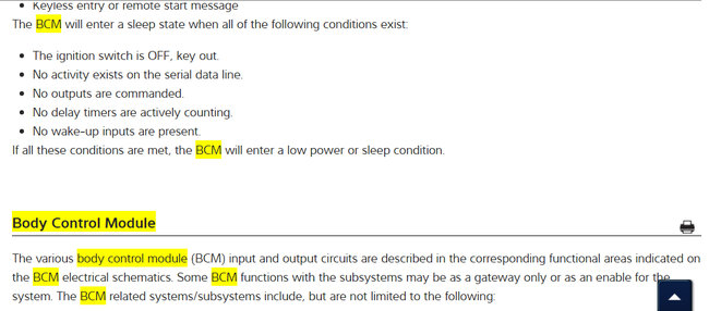

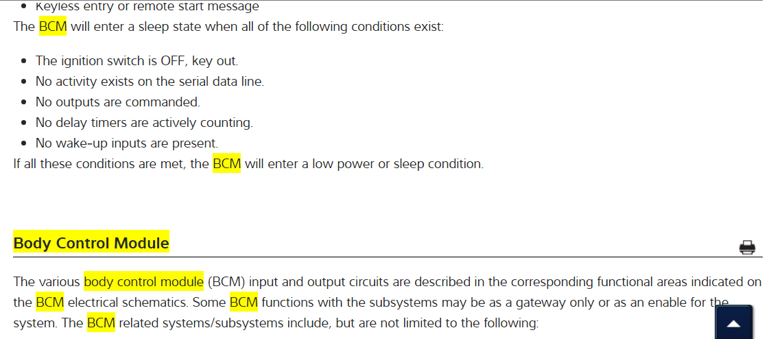

Touching the button to open drivers side window. Car will turn off and have a ticking noise coming from the door and dash. The ticking stop in about 5 minutes car will start again but interior lights stay on and radio will not turn off when door opens.
Aug 17, 2019 at 4:30 PM
SCGRANTURISMO
  • 4,897 POSTS
Is your Malfunction Indicator Lamp (MIL) or "check engine" light illuminated? If so could you please pull the Direct Trouble Code (DTC) for us. This will call for you to use a code reader, so here is a link for you to go to if you are unfamiliar with how to do that:

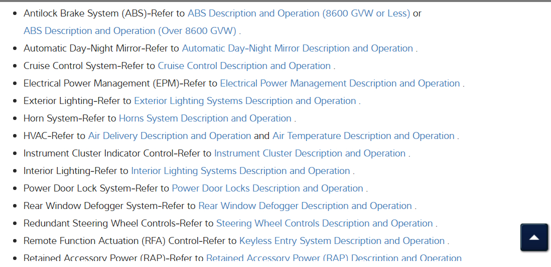

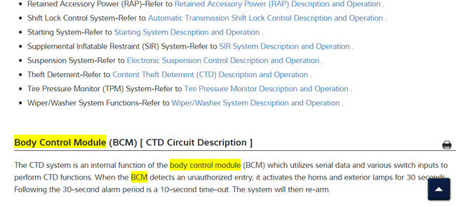

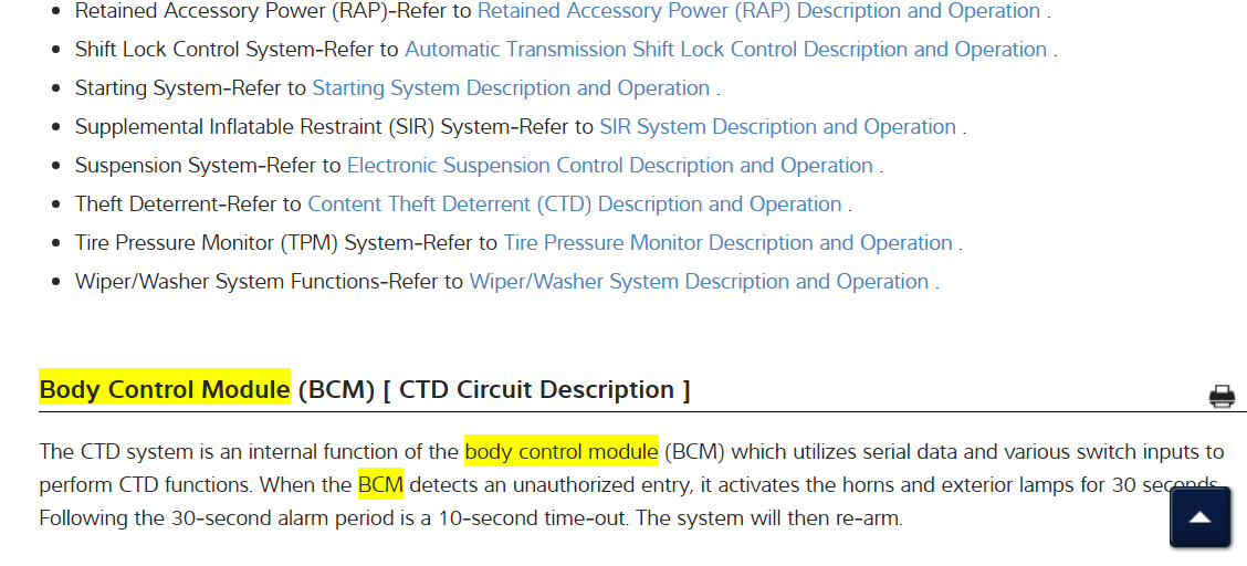

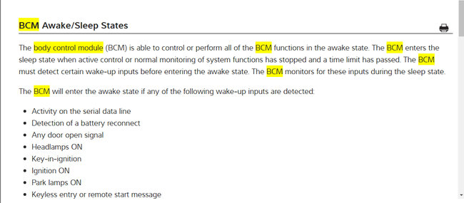

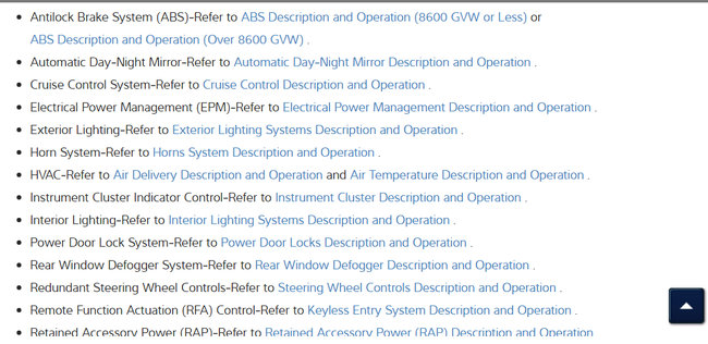

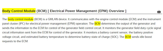

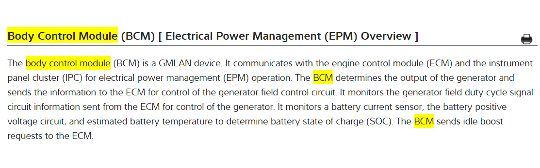

I suspect this might be a problem with your Body Control Module (BCM) so I have included a description of its operation in the diagrams down below for your reference, but any set DTC(s) should point us in the direction we need to go. Please go through these guides and get back to us with what you are able to find out.
