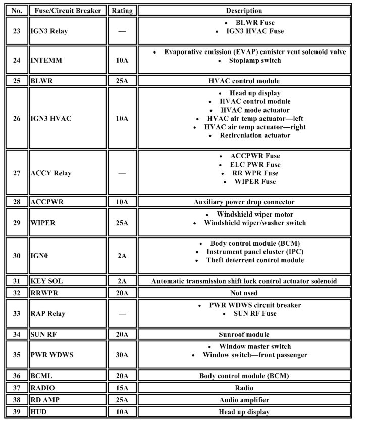

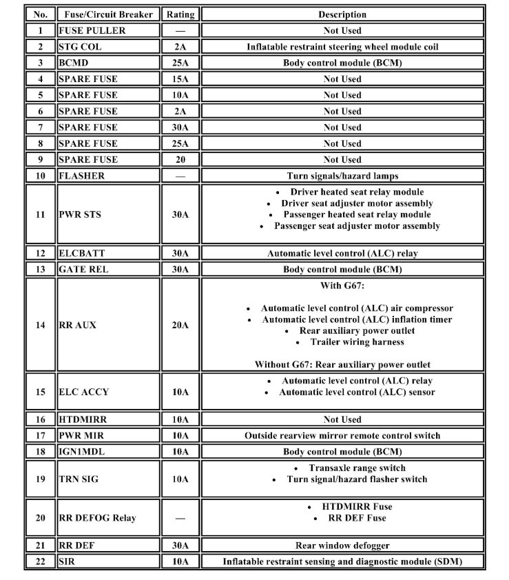

My interior lights stay on even when I turn the knob to off. I disconnected battery replaced fuse then when I reconnect lights come back and stay on.
Jul 14, 2019 at 6:32 AM
  • 55,427 POSTS

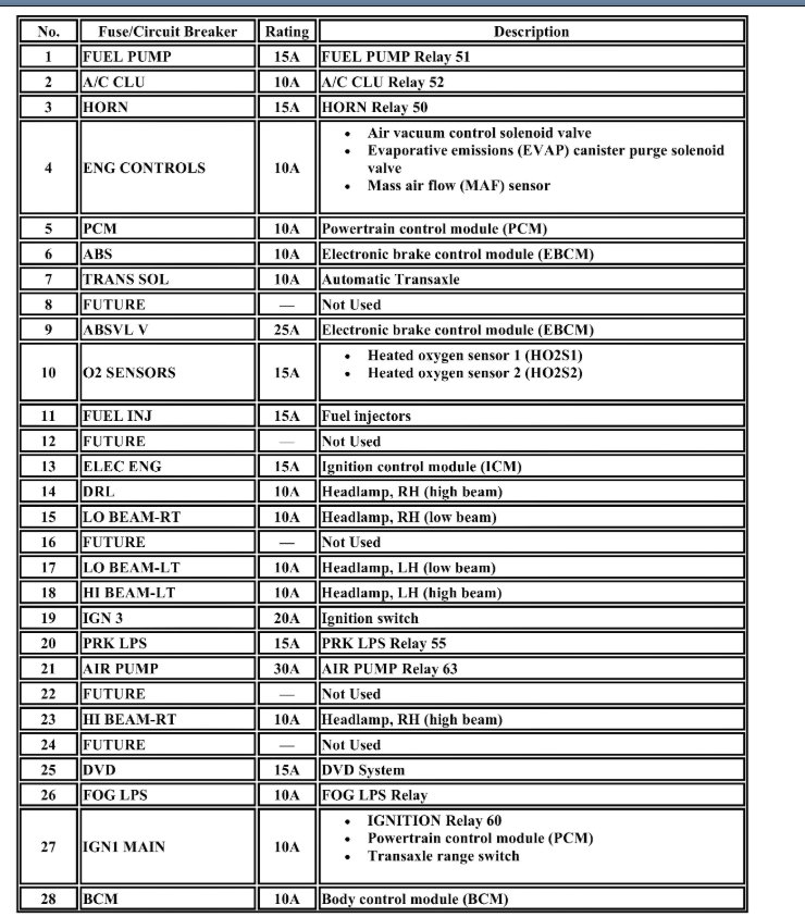

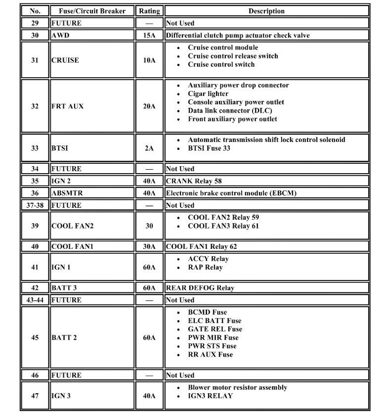

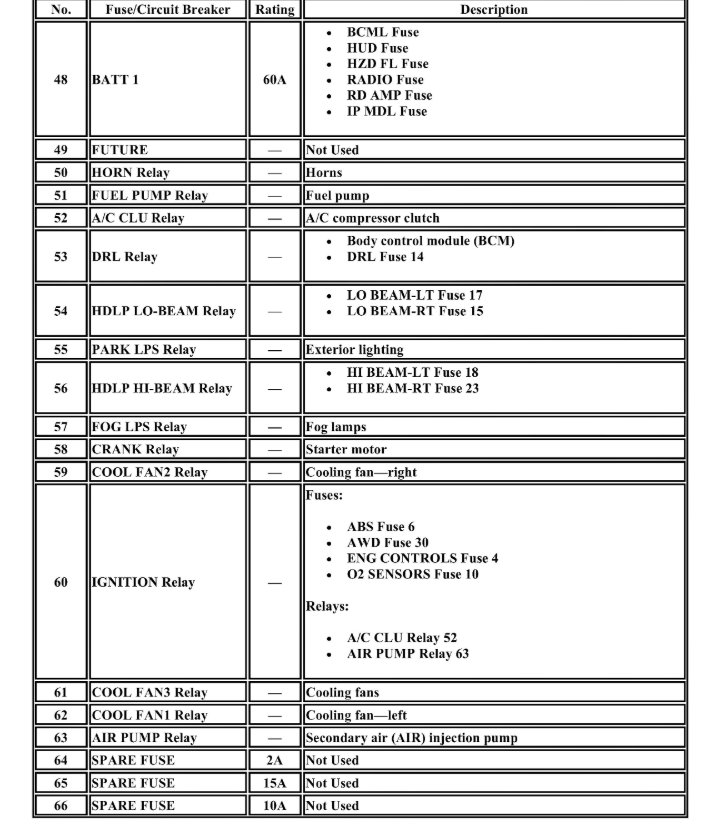

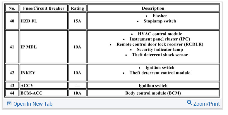

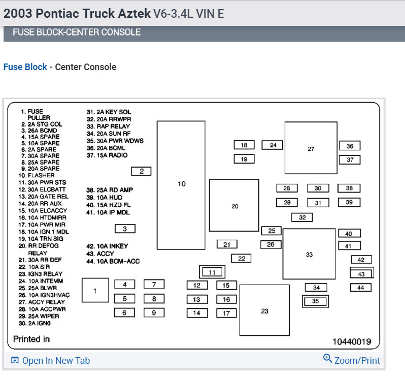

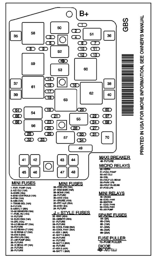

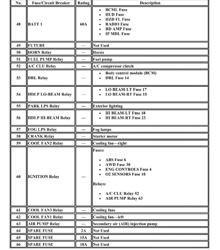

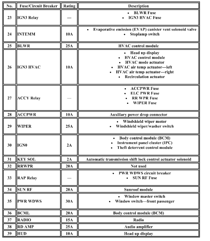

This happen right after the battery was reconnected? If so I would check the fuses on the BCM. here is a guide and the BCM fuse locations as well:
Check out the diagrams (below). Please let us know what you find.
