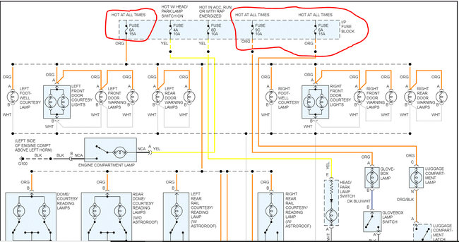

Interior lights do not turn off
1995 BUICK PARK AVENUE
150,000 MILES
GYPSYSTARLOVER
Interior lights won't go off why?
May 26, 2020 at 7:34 AM
  • 110,194 POSTS
Are you sure they are not set to on at the dimmer switch? It's an easy mistake to have happen. Also, if the switch is in the off position and all doors are closed but the lights stay on, there has to be a short to power. Are all lights staying on or only specific ones?
Lets try this. If you look at the attached picture, I circled 3 fuses that are located in the vehicle's fuse box. Remove one fuse at a time and let me know if the lights go off. If they do, let me know which fuse causes it to happen. That will limit the number of possible causes.
