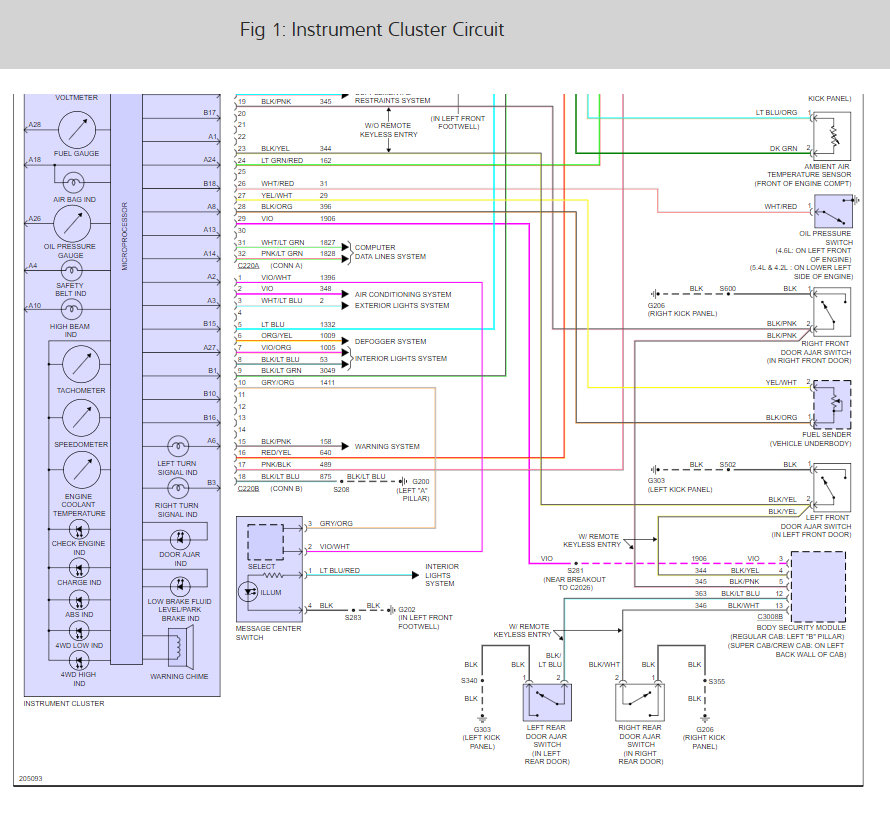

For no apparent reason interior lights go on every once and awhile.
I get them to go off I just smack the left side of dash above light switch and they of out. Or turn the dimmer off.
Feb 3, 2019 at 7:22 AM
  • 54,832 POSTS

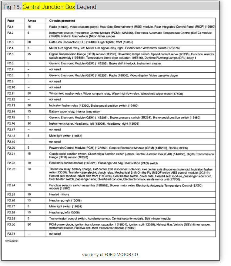

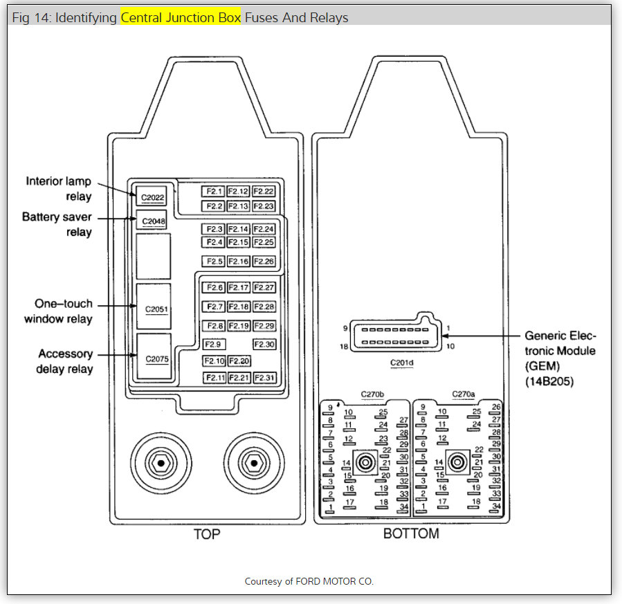

It sounds like it could be the instrument cluster. here is a wiring diagrams so you can see how the system works. also see if pulling the battery saver relay helps. Here is a video of a cluster being removed for rebuild in a similar car the process is the same and the relay location below:

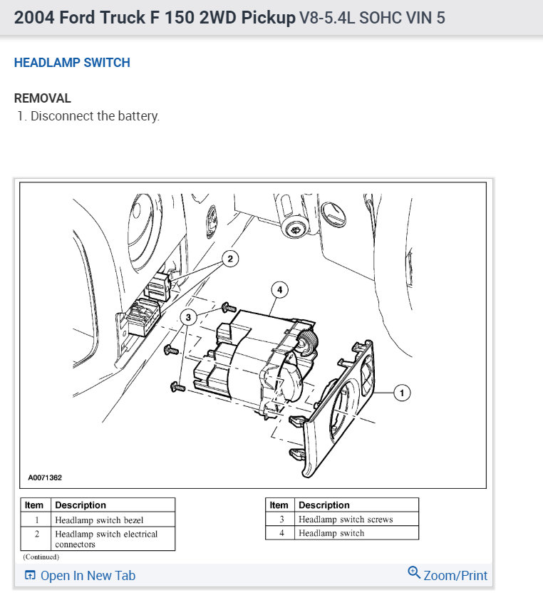

Thanks. I'll give it a try. You don't think it's the light switch assembly?
Feb 5, 2019 at 4:17 PM
  • 54,832 POSTS
I have not seen a switch fail that way but there is always a first time. Try unplugging the switch to see if it stops. Check out the diagrams (below). Please let us know what happens.

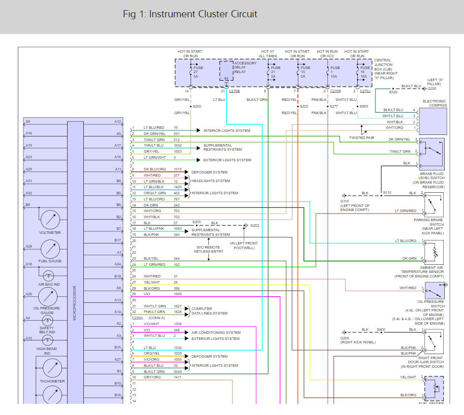

Same thing, I was told the instrument cluster would control the brake light and the dome lights along with a lot of other devices. is this true?
Feb 7, 2019 at 4:05 PM
  • 54,832 POSTS
That is correct. Here is a wiring diagrams of the cluster so you can see how it works and what it controls.
