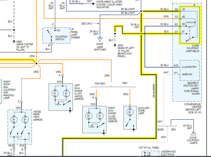

All hi, am asking help in my problem. I'll be brief. The light in the cabin is constantly on the display it is written-open doors, door jamb switch right. give scheme and explain where is the main module, thank you
Sep 27, 2019 at 6:12 AM
Good morning,

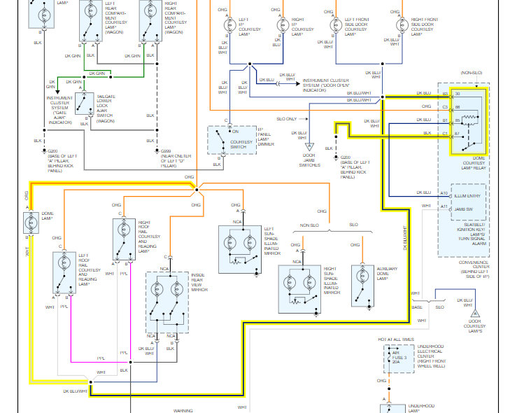

I attached a diagram for you to view.
There is a relay in the convenience center for the dome light. It may be stuck closed.
Make sure the headlight switch is not commanding it on as well.

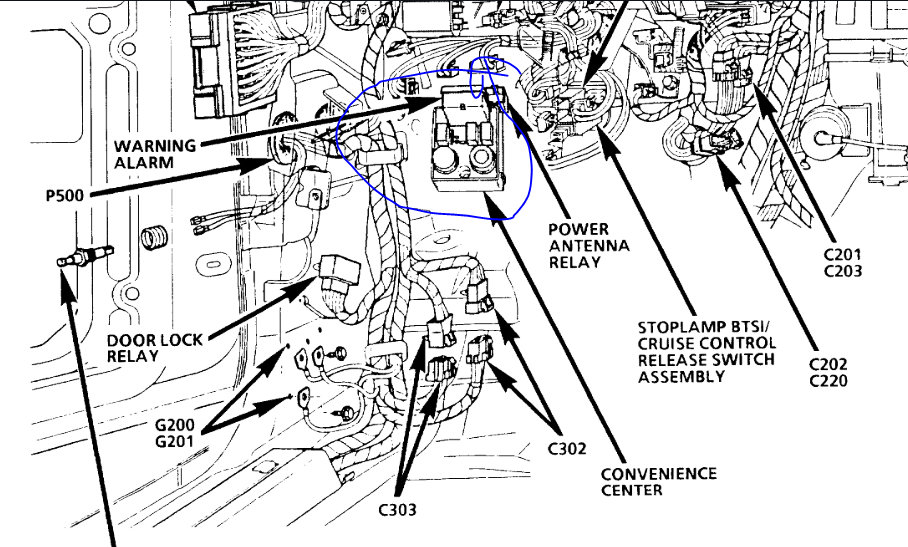

where is the relay?
Sep 28, 2019 at 12:08 AM
In the convenience center under the dash to the left of the steering column.

And you could throw a photo above which completely?
Sep 28, 2019 at 12:24 AM
ANONYMOUS
  • 0 POST
And whether the location of relays on this board?
Sep 28, 2019 at 12:25 AM
I attached the picture. There are only a couple of relays. They should be marked. If they are not, remove them one by one until the dome light goes out.
