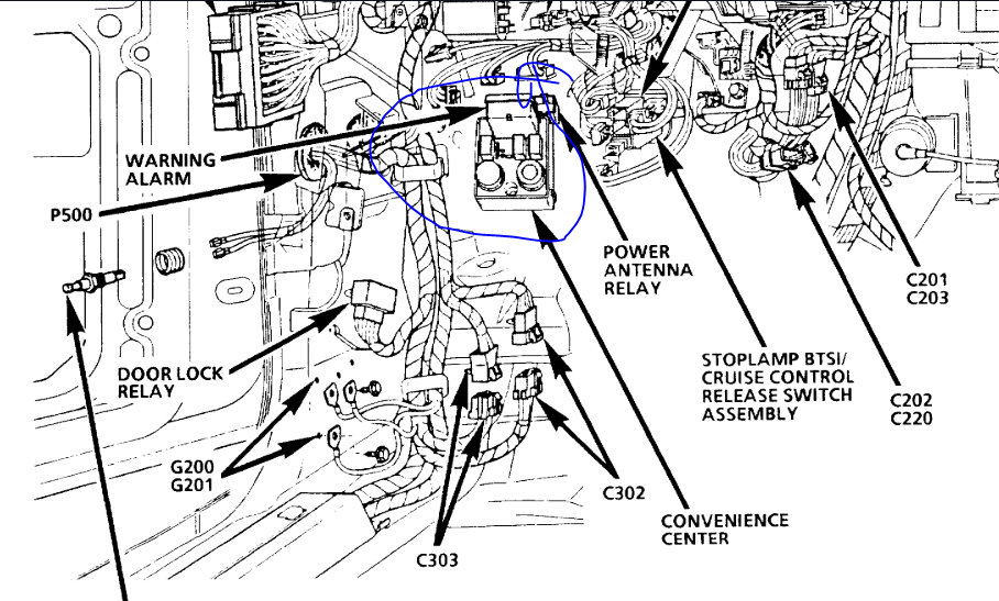

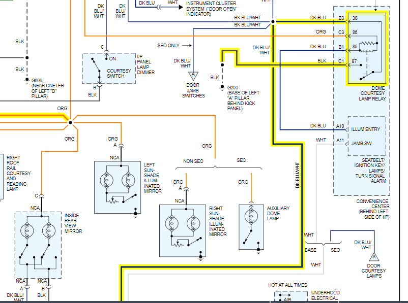

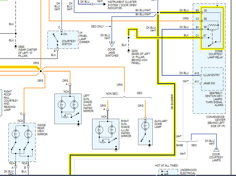

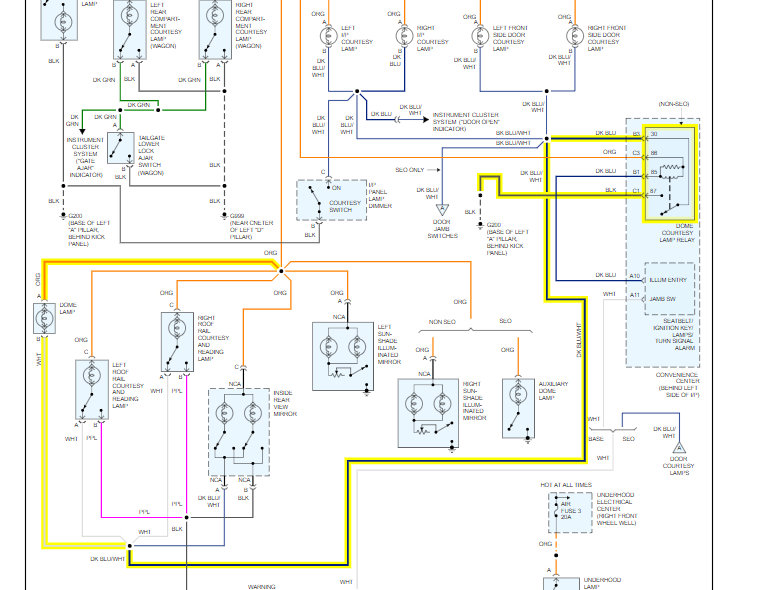

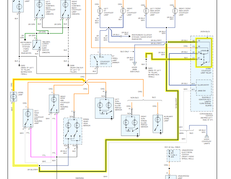

All hi, am asking help in my problem. I'll be brief. The light in the cabin is constantly on the display it is written-open doors, door jamb switch right. give scheme and explain where is the main module, thank you
Sep 27, 2019 at 1:12 PM
Good morning,
I attached a diagram for you to view.
There is a relay in the convenience center for the dome light. It may be stuck closed.
Make sure the headlight switch is not commanding it on as well.

And you could throw a photo above which completely?

And whether the location of relays on this board?
Sep 28, 2019 at 7:25 AM
I attached the picture. There are only a couple of relays. They should be marked. If they are not, remove them one by one until the dome light goes out.
