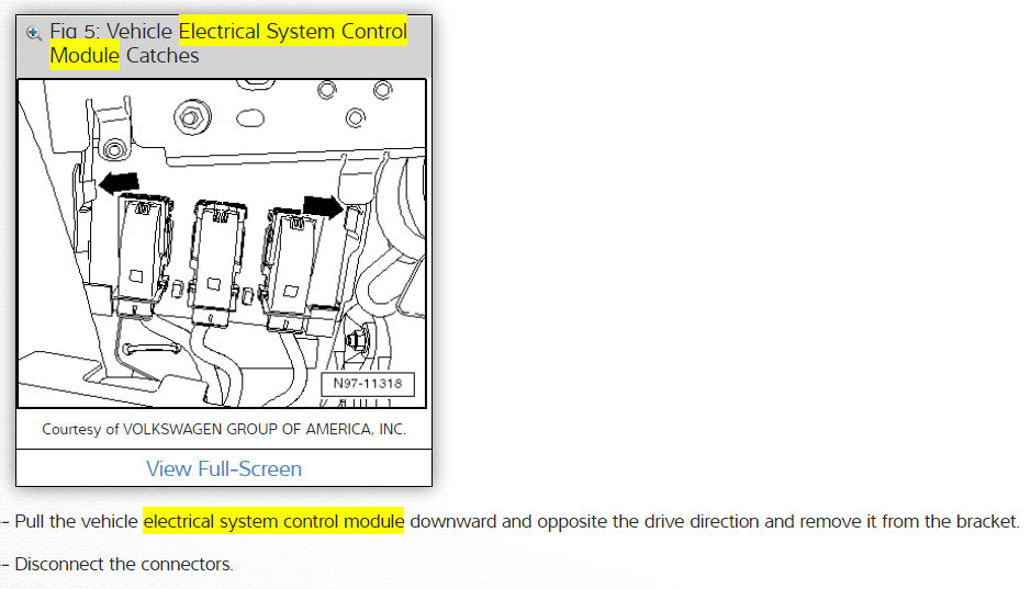

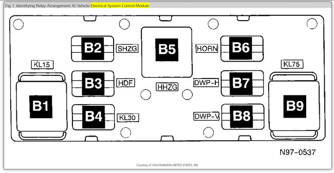

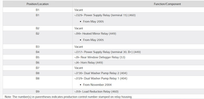

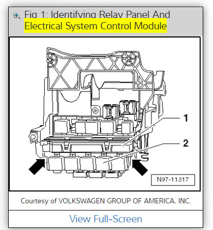

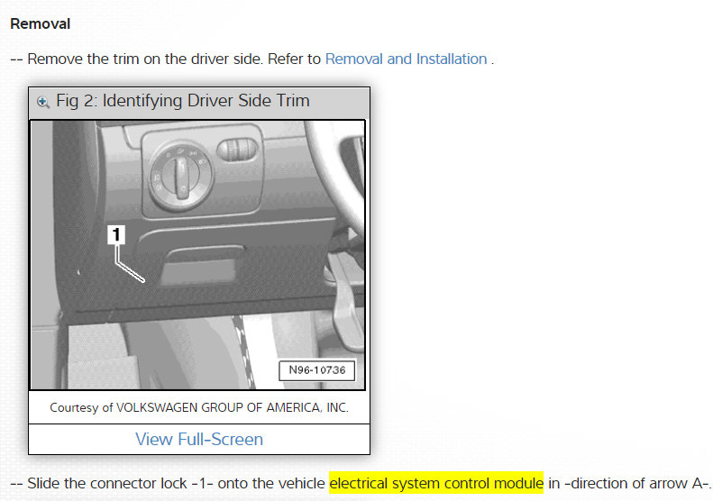

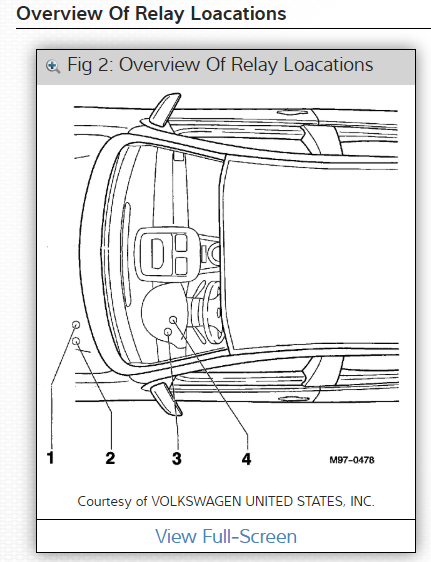

Interior light fuse #15 keeps blowing
110,604 MILES • 2.5L • 5 CYL • 2WD • MANUAL
FAZAL94

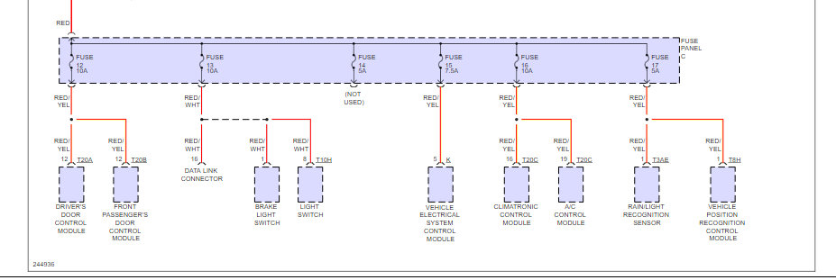

Hi, the interior lights not working. Replaced the fuse #15 of 7.5A and it blows off repeatedly. What should I do?
Sep 25, 2018 at 9:30 AM
  • 55,721 POSTS

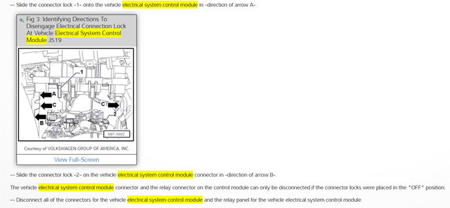

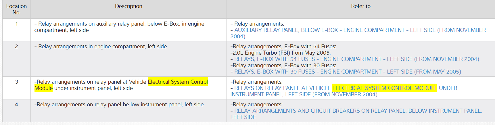

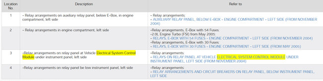

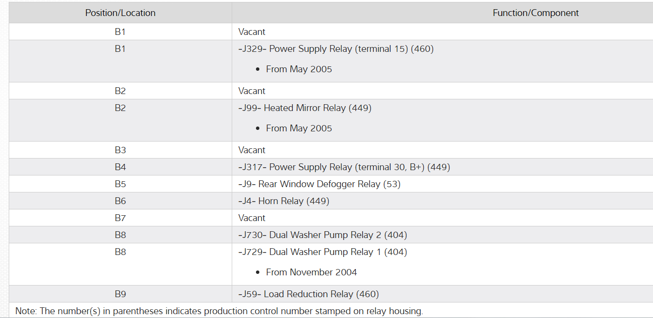

This fuse goes to the electrical control module which has many fuses and relays. I would try pulling relays one at a time to check if the fuse still blows (you will need a box of fuses). Here is the wiring diagram showing the fuse in question and the location of the module below:
