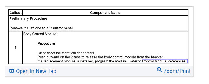

Suddenly, i had a message that the passenger door and the right door are open and the interior light remained on.

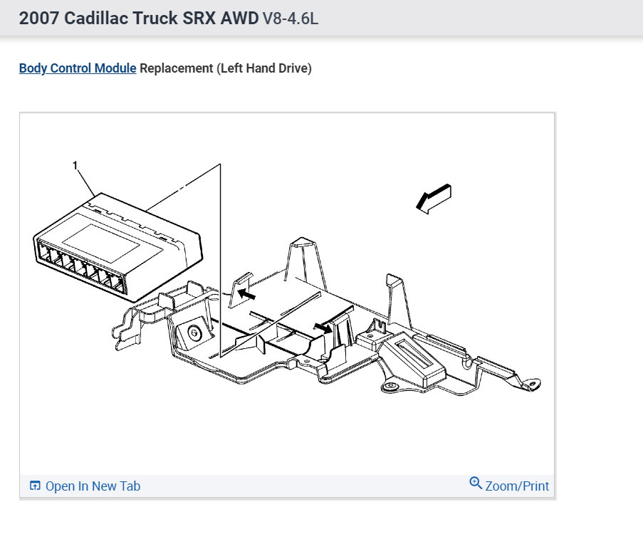

This happens when the BCM is going out which can also explain the radio issue as well. You can get a CAN scanner from Amazon for about $30.00 here is a video to show you how. I have also found how to change the BCM out in the diagrams below. Also, has this car had any water damage?

Body Control Module Programming and Setup
Introduction
A new body control module (BCM) must be programmed with the latest operating software and vehicle calibrations. Ensure that the following conditions exist in order to prepare for BCM programming:
* The battery is fully charged.
* The ignition switch is in the ON position.
* The data link connector (DLC) is accessible.
* All disconnected modules and devices are connected.
Programming the BCM
Important: The vehicle will not start and many other functions may not operate properly if a replacement BCM is not properly set up. The following procedures must be followed:
1. Programming the BCM
2. Learning the restraints ID
Important: After the procedure is completed, the personalization settings of the BCM are set to default settings. Inform the customer that the personalization must be set again.
Refer to Service Programming System (SPS) for more information. See: Vehicle > Programming and Relearning
Learning the Restraints ID
Navigate on the scan tool to Body Control Module > Module Setup > Setup SDM Primary Key in BCM, then follow the instructions on the screen.
