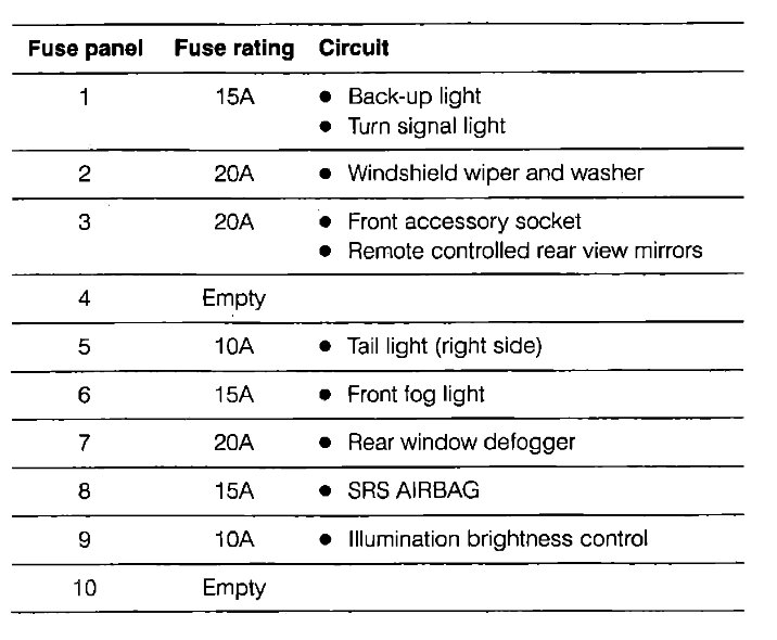

Need a picture of interior fuse panel?
1997 SUBARU LEGACY
213,000 MILES • 2.0L • 2WD • AUTOMATIC

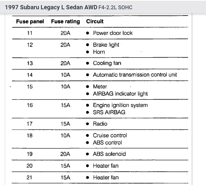

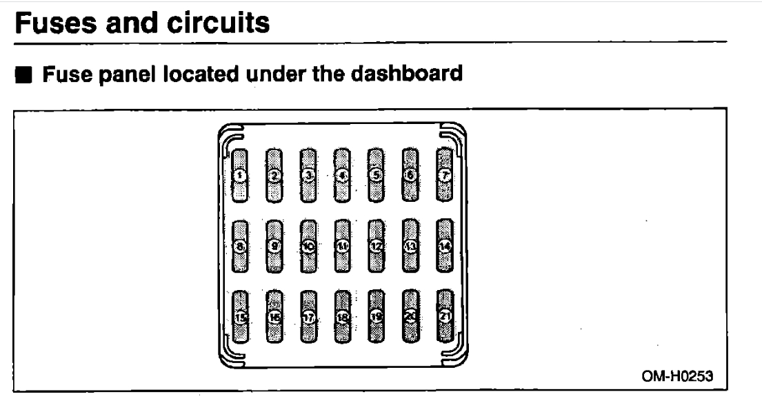

If you look below, pic 1 identifies the box and fuse orientation and identification numbers. Pics 2 and 3 are the fuse number, rating, and circuits protected.
I'm not sure what you are dealing with, but if it is a fuse-related issue, first confirm the fuse is good, if it is, it's important to determine if the fuse has power both to and from it. If there is no power, it's likely a bad fuse in the under-hood box.

Thank you so much. I could only find the diagram for 1998 or newer and we're not technically having any particular issues just don't have a cover on ours, so we couldn't tell which fuse went to what.
