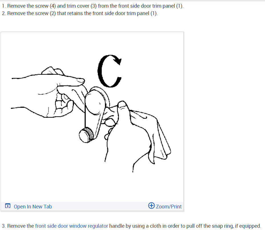

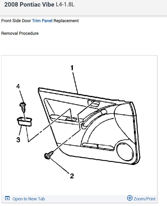

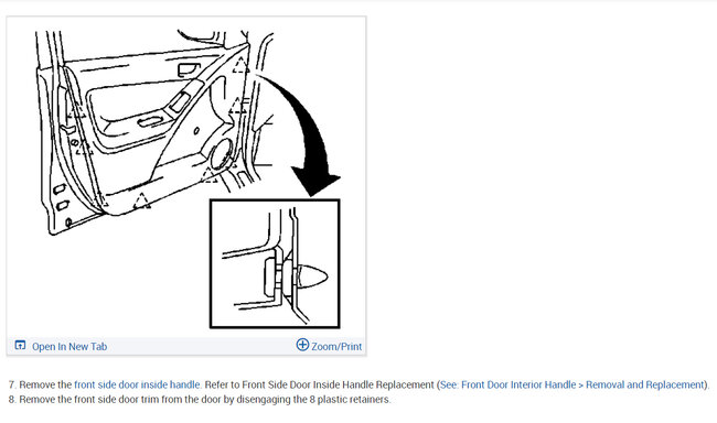

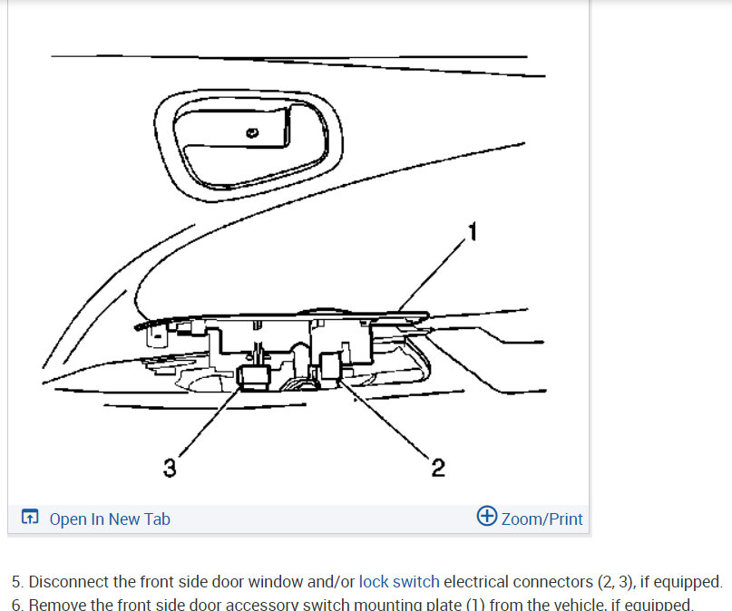

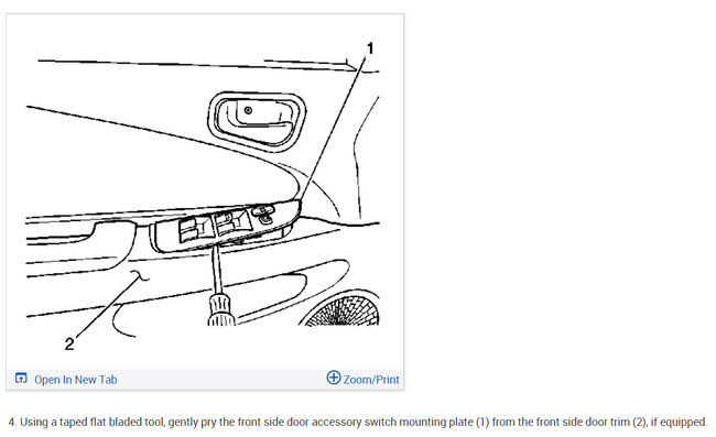

im not sure what ones to purchase and where to purchase them from.
Oct 4, 2024 at 12:34 AM
  • 55,858 POSTS

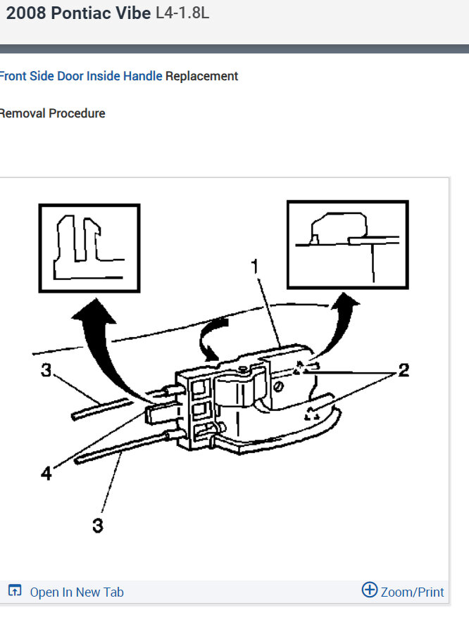

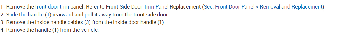

I would search eBay, they have all of this kind of stuff for cheap. They are used but still work well. Here is how to change the door handles out in case you need it. Check out the images (below). Let us know if you need anything else.
