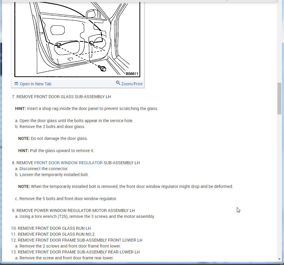

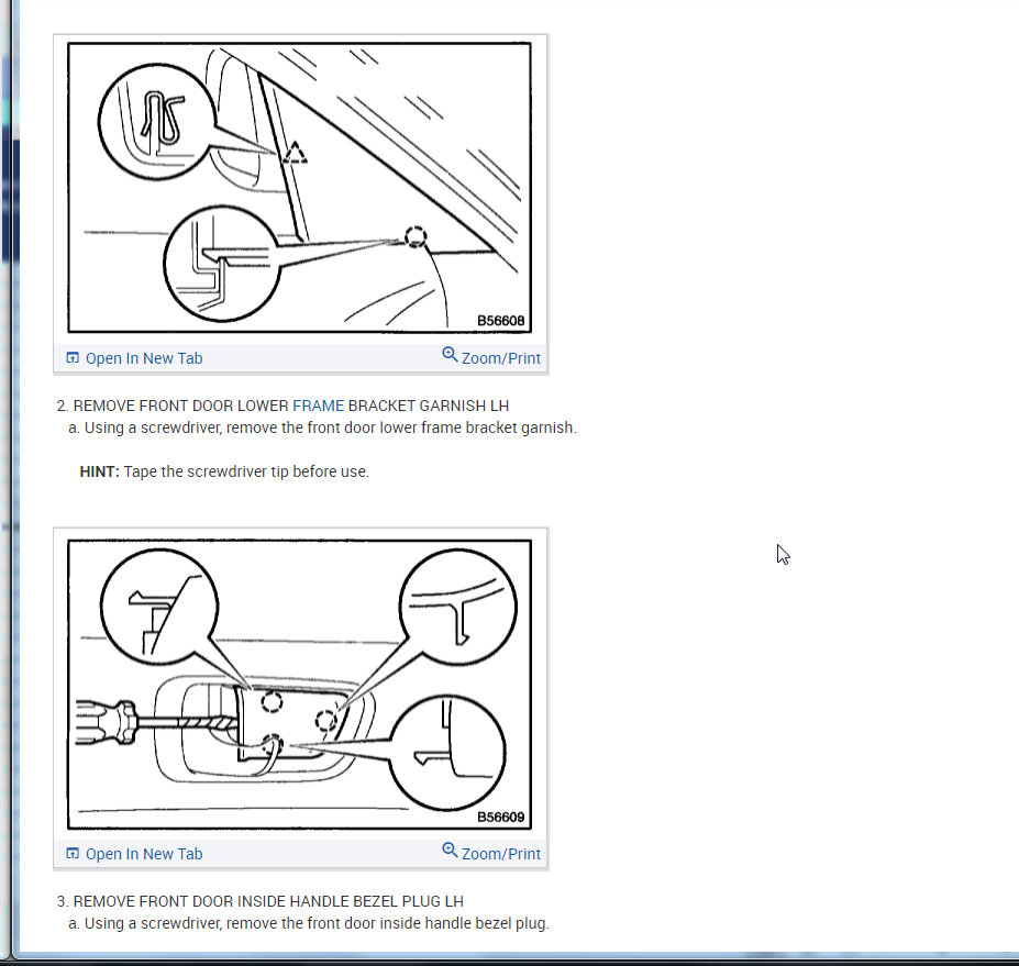

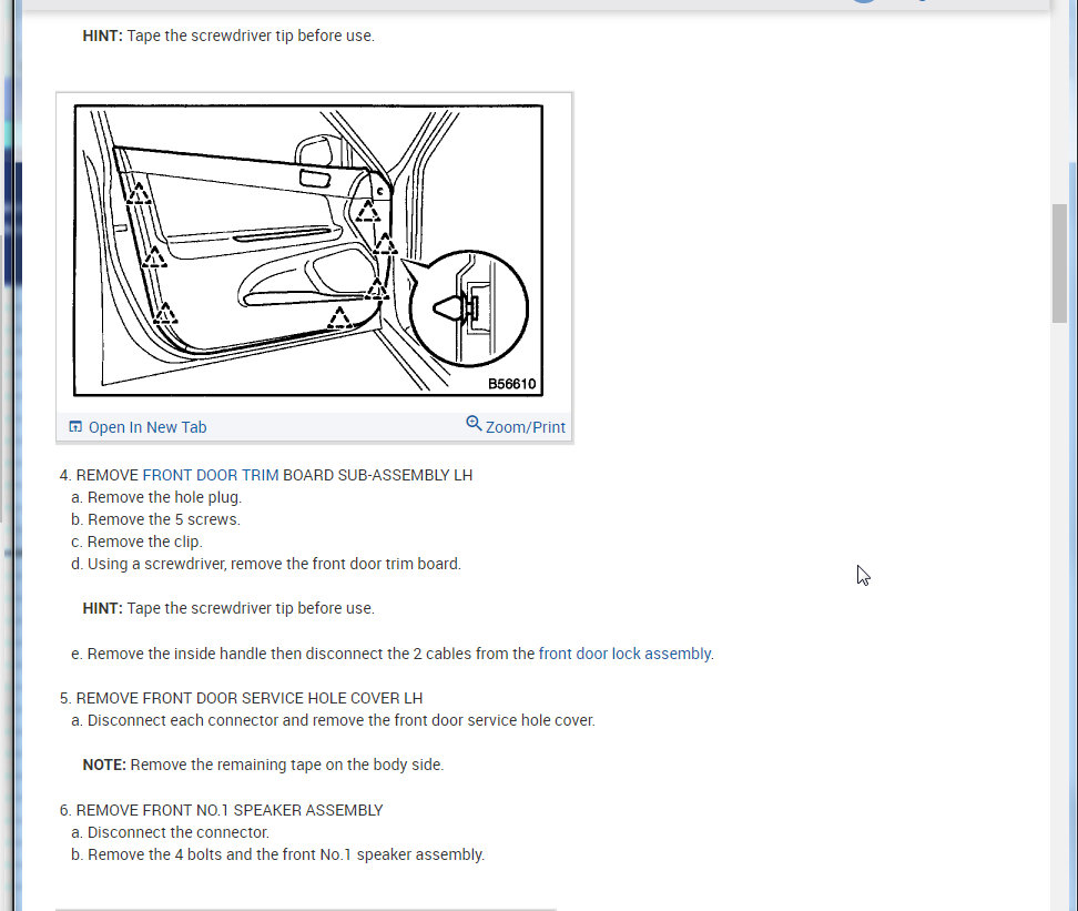

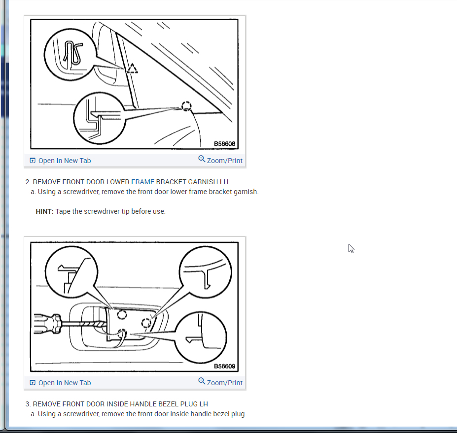

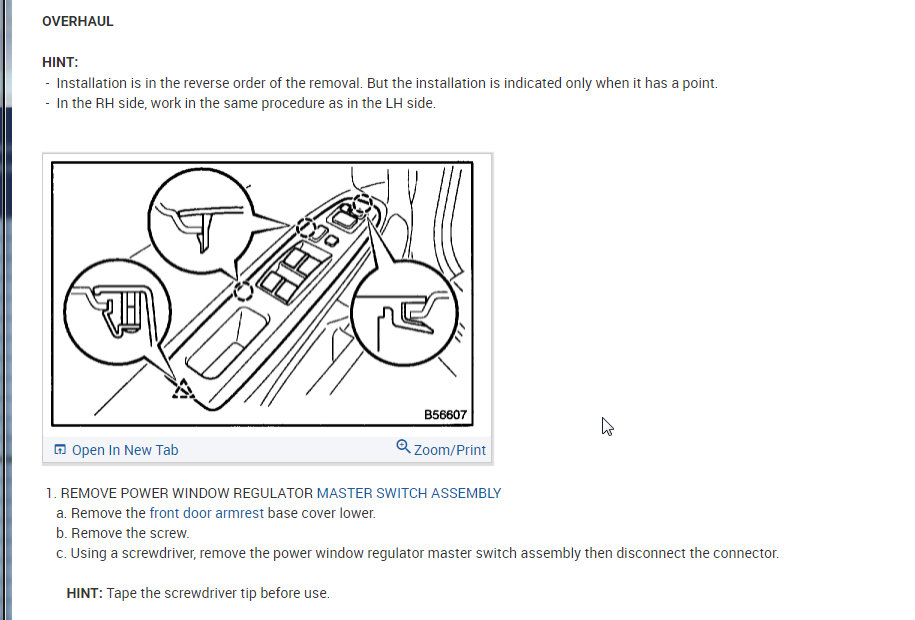

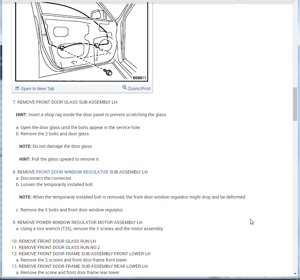

The plastic on my interior driver side door handle broke off and the door handle no longer works. The locks and exterior door handle work just fine. How can I replace that? Is it easy to do at home? How much would it cost for a mechanic to repair, if I bought the part myself?
May 23, 2021 at 8:29 AM
You are going to have to remove the door panel and then you will see how the handle comes off.
Here is a video on a 2001 Camry that is similar:
https://youtu.be/rbHbC70misg
Also, here is a guide that will help with removing the door panel that will give step by step instructions on how to do this:
https://www.2carpros.com/articles/door-panel-removal
Below is the info from the manual that will help with this as well.
Please run through this material and let us know if you have other questions. Thanks
