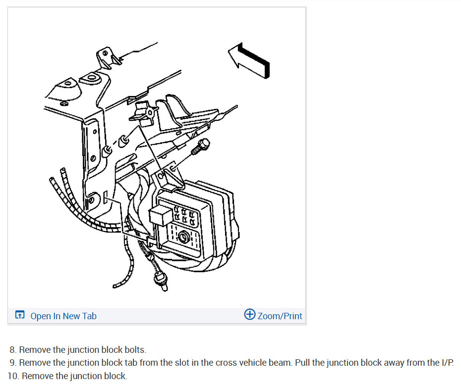

Interior cabin fuse box removal to install new box?
Feb 1, 2025 at 3:57 PM
Experienced Mechanic
55,711 POSTS

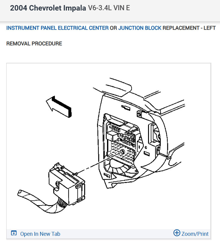

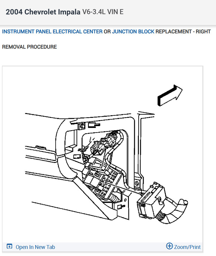

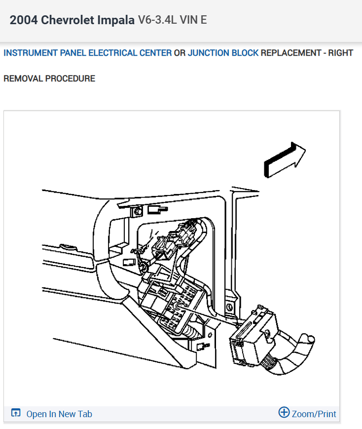

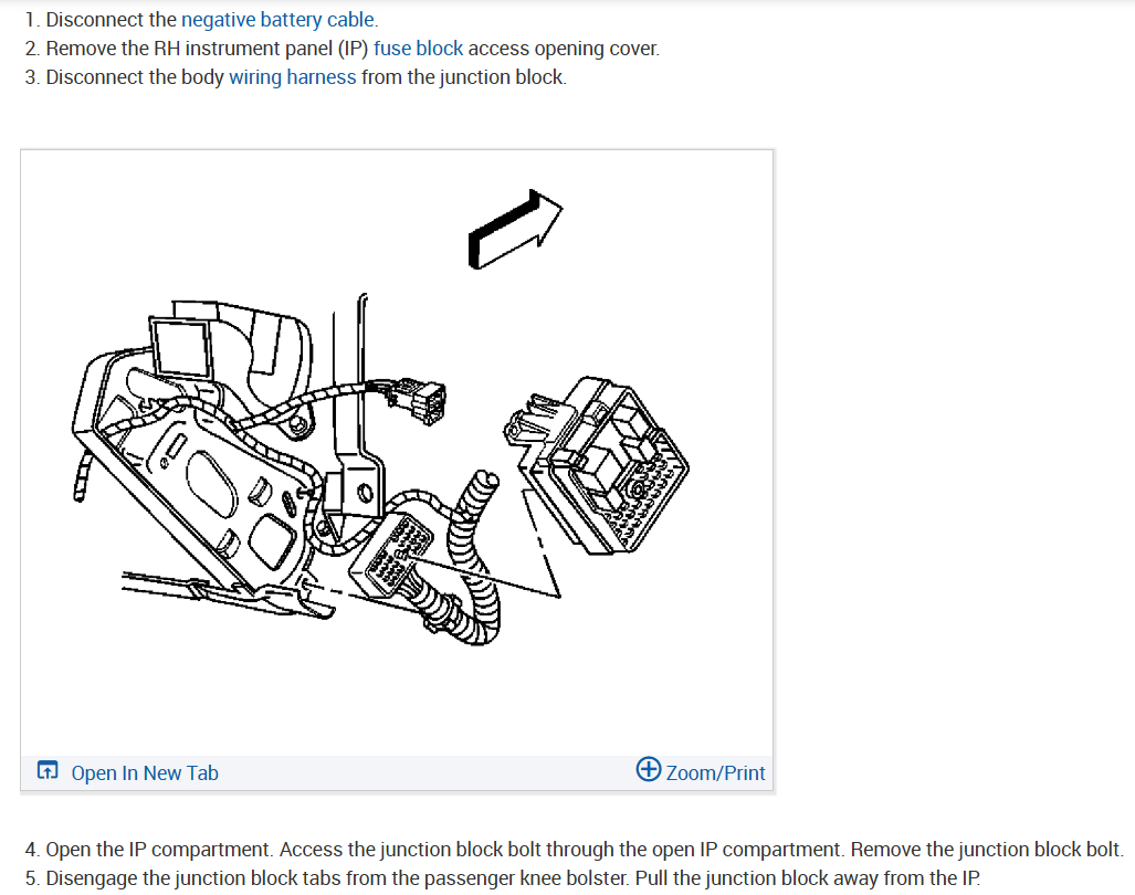

There is a right and left fuse panel, here are the instructions to replace both. Check out the images (below). Please let us know what happens.
Images (Click to enlarge)
Feb 2, 2025 at 2:40 AM
ISRAEL BRICENO
MEMBER
3 POSTS
So is it possible to take the old interior box off and put in a new one?
Feb 2, 2025 at 9:58 AM (Merged)
55,711 POSTS
Yes, please check out the images above, it shows you how.
