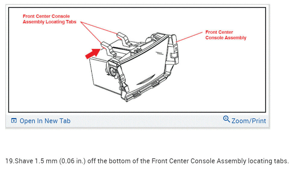

Is the door in the center console, in front of the shifter, or overhead?
Let me know. I remember there being a technical service bulletin related to the interior storage compartment being difficult to open. If I recall, it was due to an alignment issue.
___________
Update: I just saw the other posts. Try wiggling the door to open it. If you use anything to pry with, cover the area with something like duct tape to avoid damage.
According to the TSB, the locating tabs require 1.5 mm removed to fix the issue. Take a look at the pic below. Let me know if this is something you feel comfortable doing.
See pic below.
