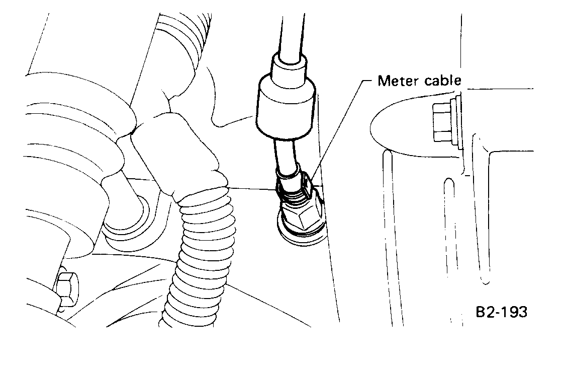

pic 1
4. Remove meter cable and clip.

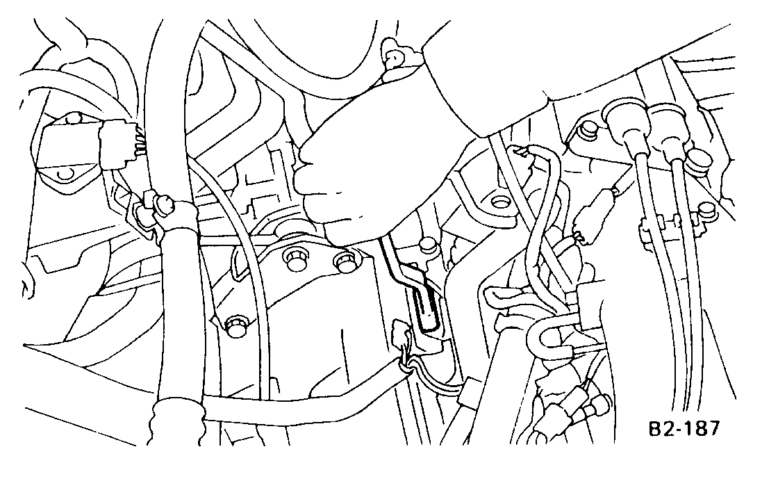

5. Disconnect the following:
- Oxygen Sensor connector
- Crank Angle Sensor connector
- Cam Angle Sensor connector
- Knock Sensor connector

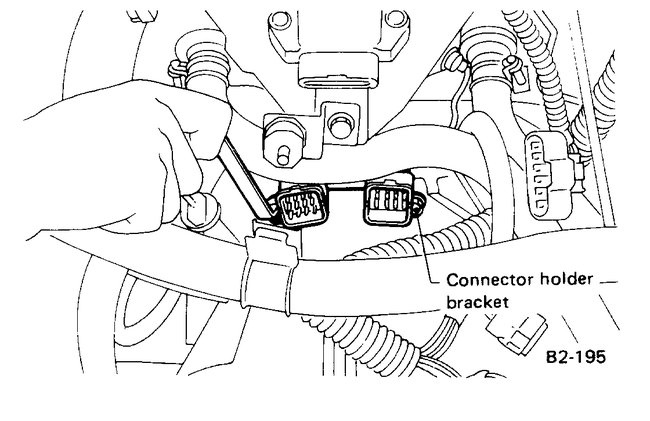

pic 2

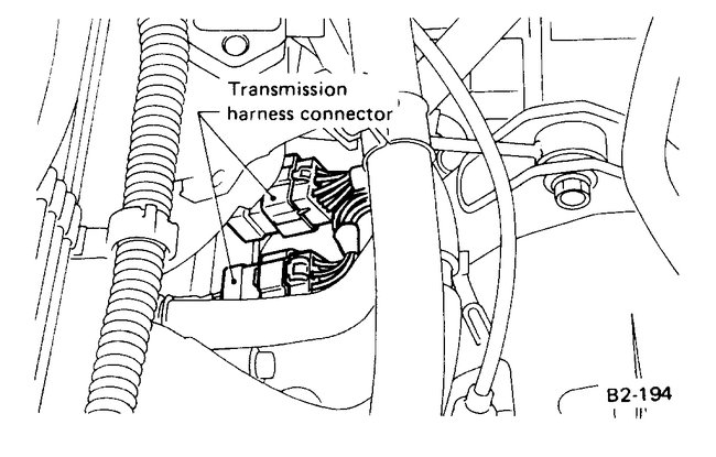

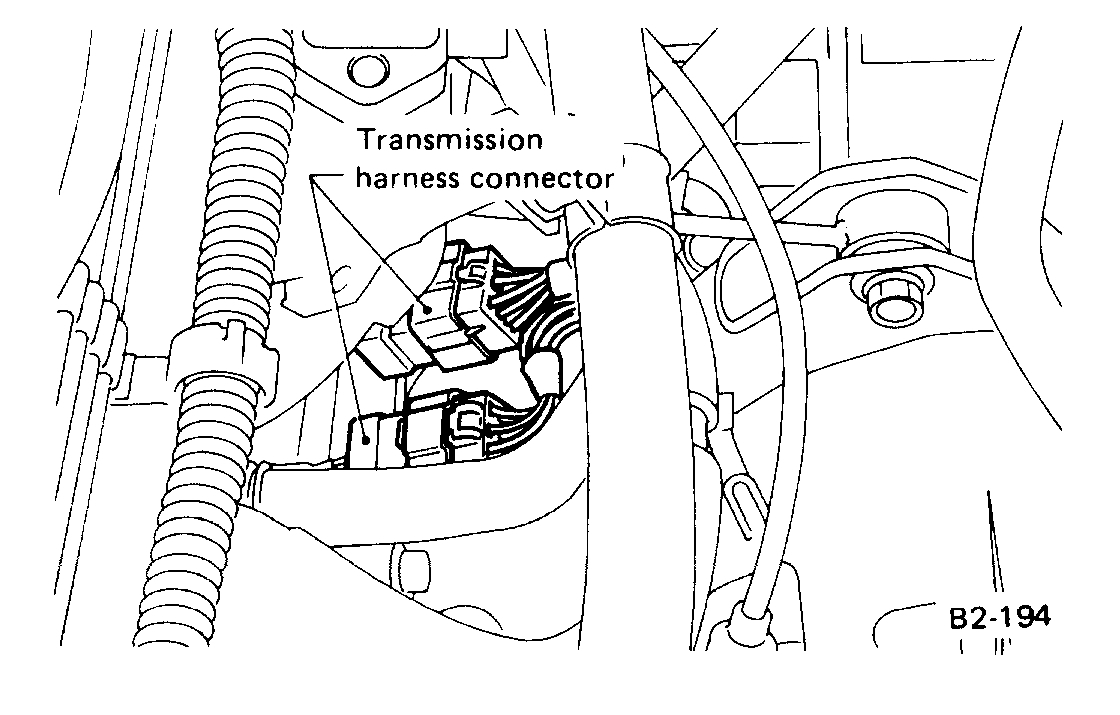

- Transmission Harness connectors
- Transmission Ground Terminal
6. Disconnect start connector and terminal and remove the starter assembly.

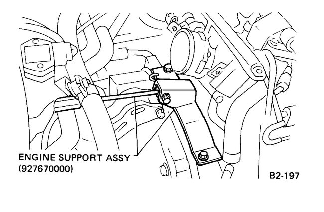

7. Remove pitching stopper rod.
pic 3

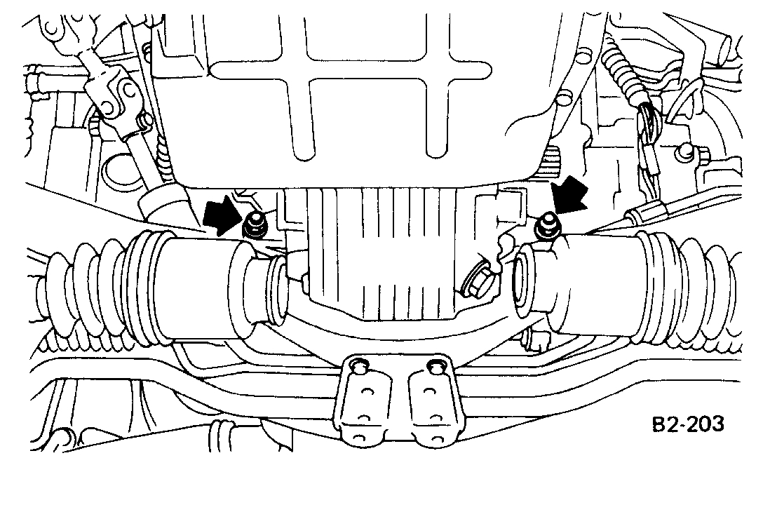

8. Remove connector holder bracket.
pic 4

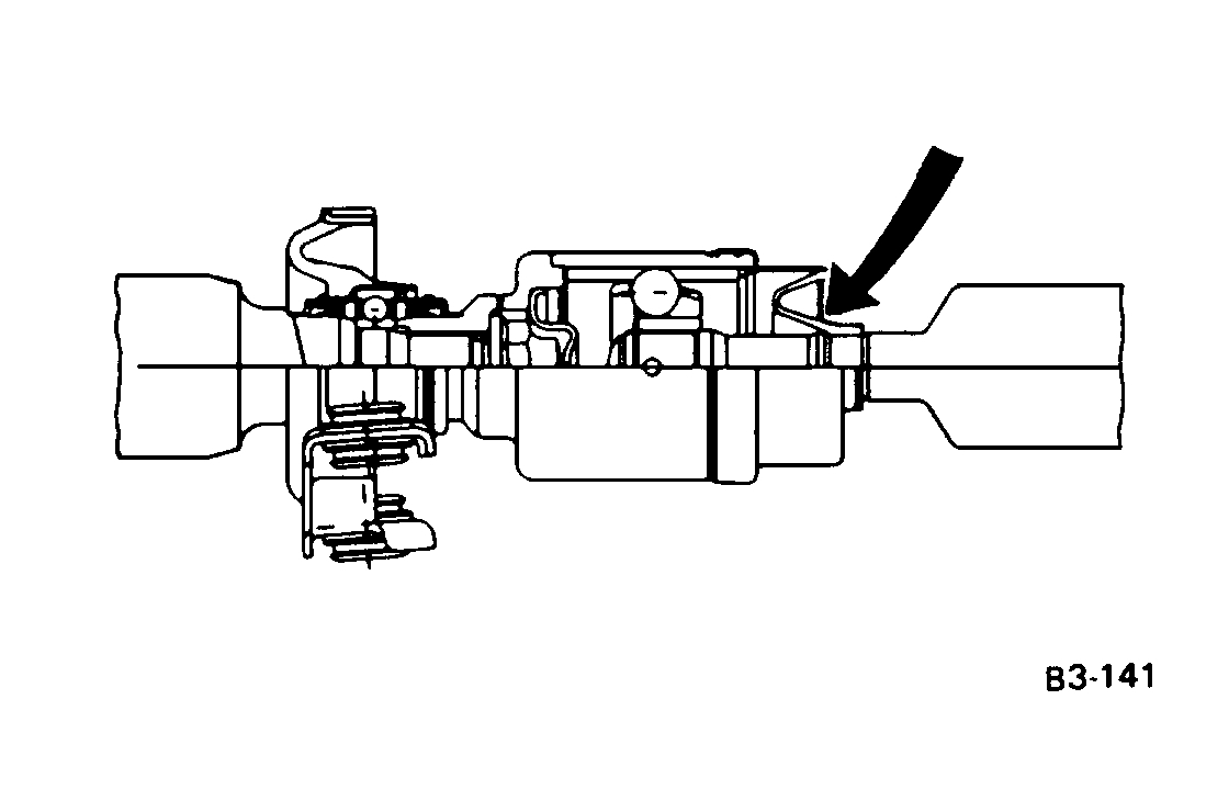

9. Remove timing hole plug and remove the four bolts which hold the torque converter to the drive plate.

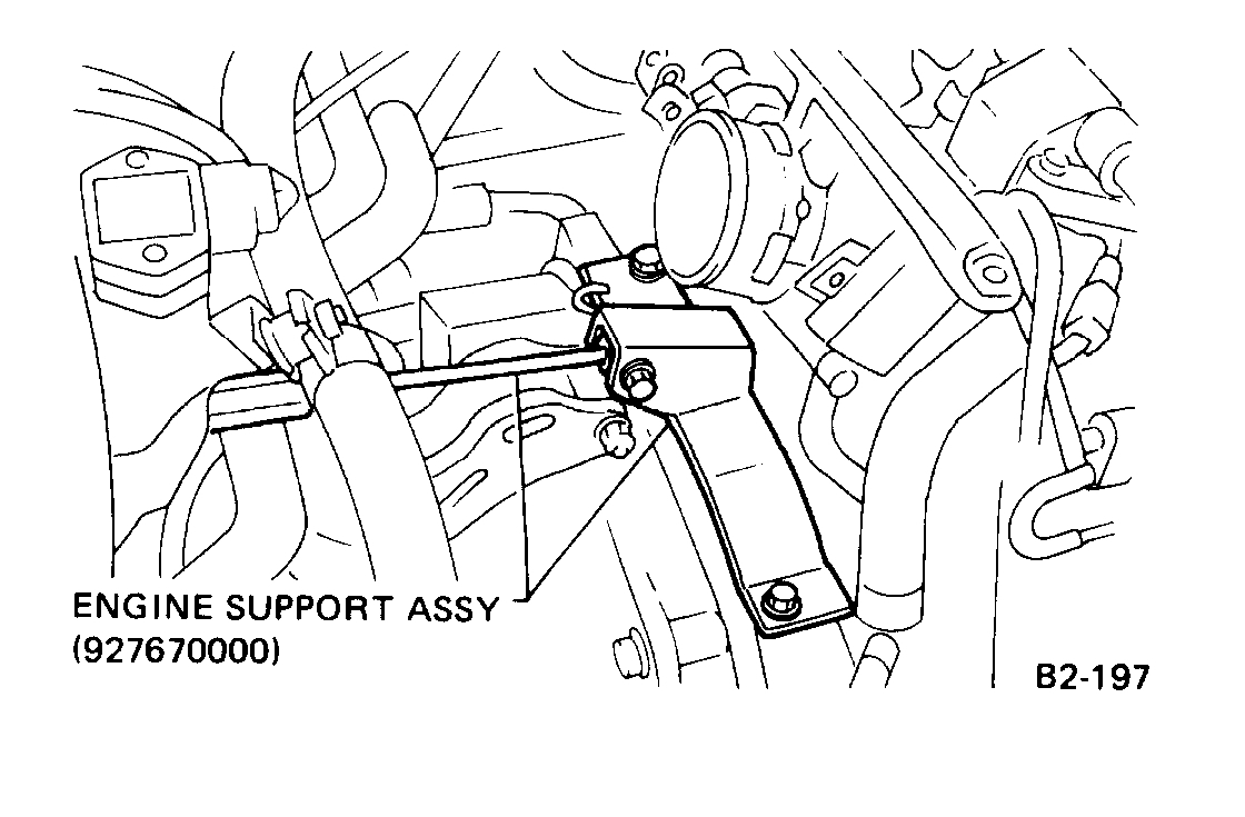

10. Set the engine support assembly (927670000).

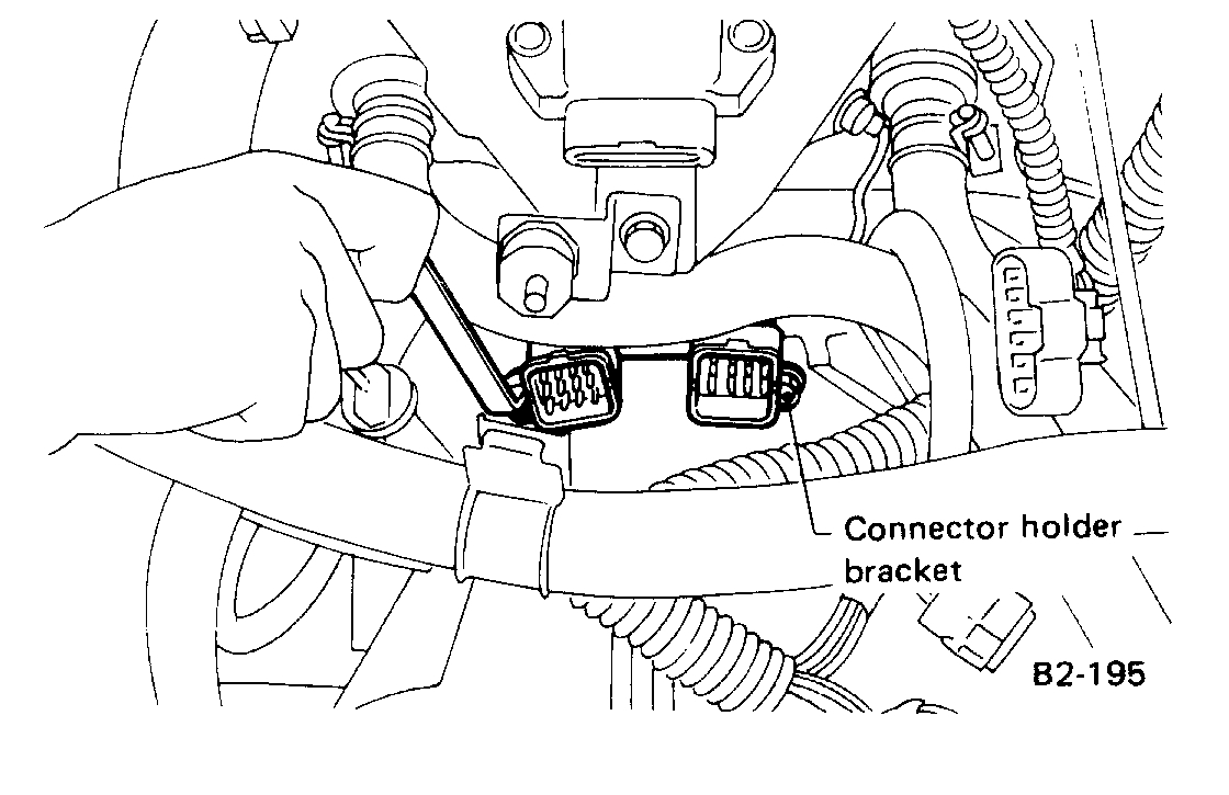

16. Disconnect the rear exhaust pipe from the muffler.
pic 6

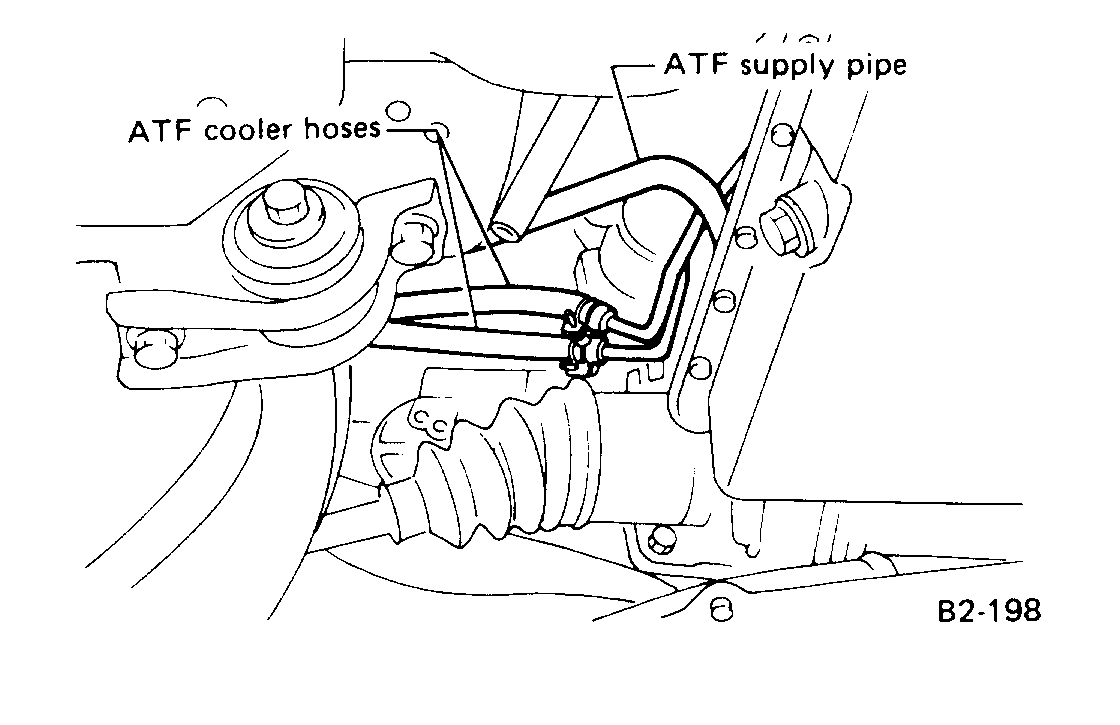

17. Disconnect ATF cooler hoses and ATF supply pipe, be careful not to damage the oil supply pipe O-ring.

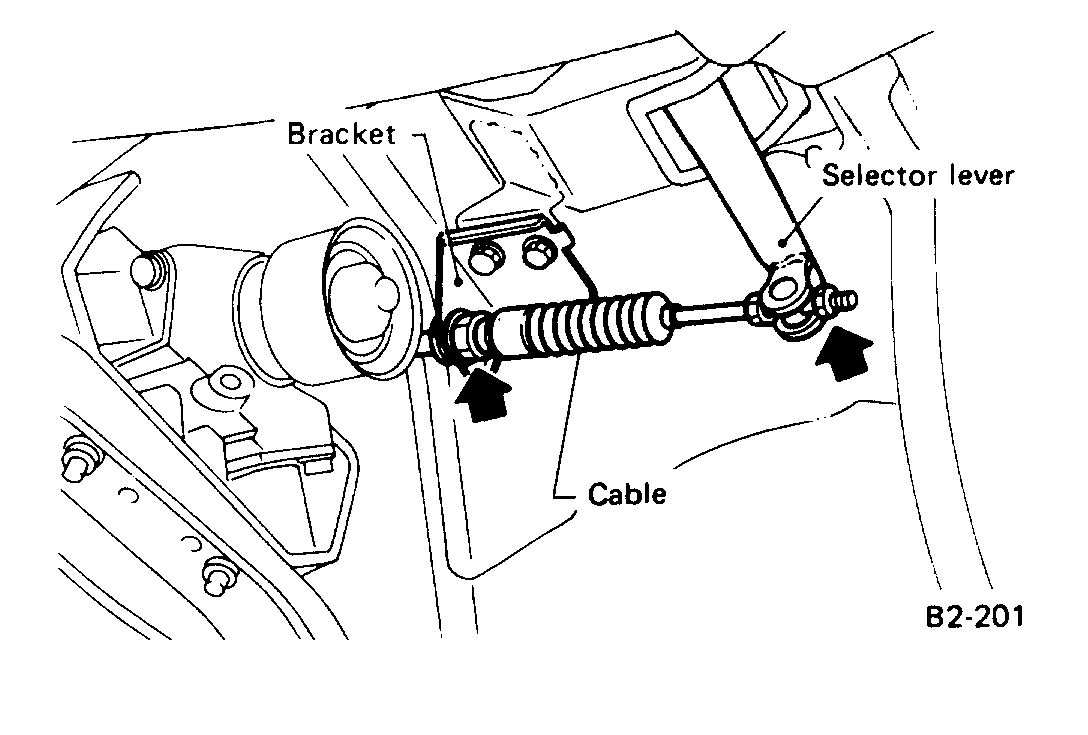

24. Disconnect cable from select lever.
25. Loosen nut which holds cable to bracket.
pic 9

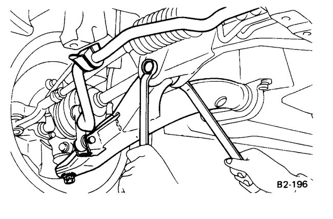

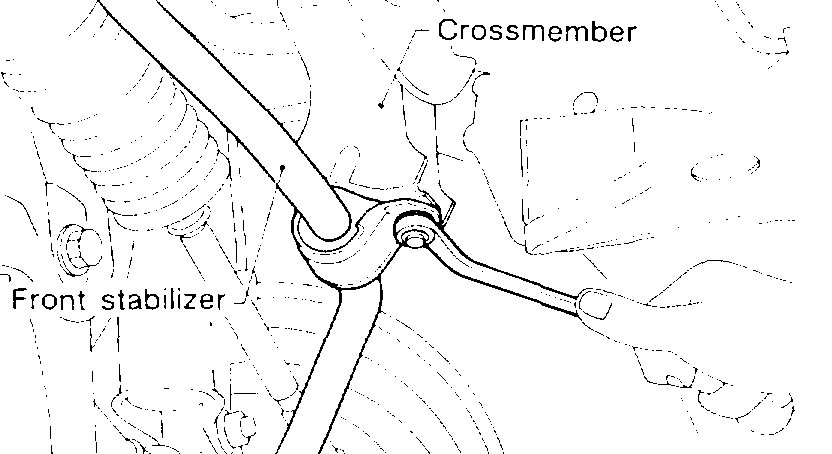

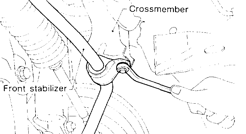

26. Remove bolts holding front stabilizer to crossmember.
pic 10

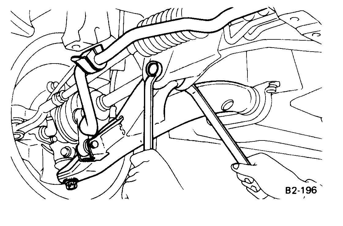

27. Remove bolt holding transverse link to crossmember on each side.
28. Lower transverse link, remove spring pin and separate axle shaft from drive shaft on each side.
Note: Be sure to remove axle shaft from drive shaft by pushing the rear of tire outward.
pic 11

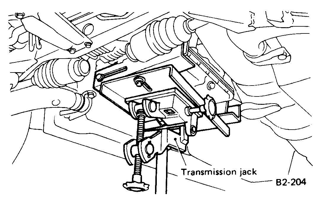

30. Place transmission jack under transmission.
Caution: Make sure you place the jack under the transmission pan, not the oil pan as the oil pan will be damaged.

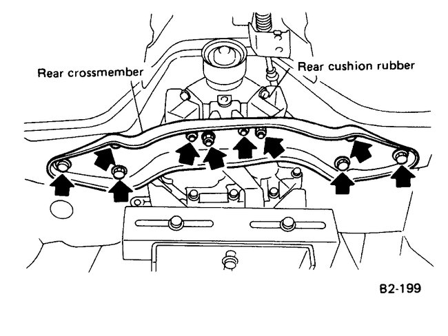

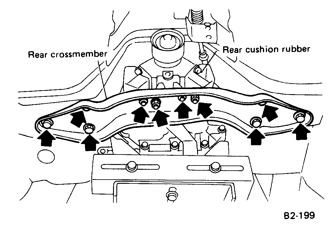

31. Remove rear cushion rubber mounting nuts and rear crossmember.
32. Move torque converter and transmission as a unit away from the engine until it clears then remove transmission.

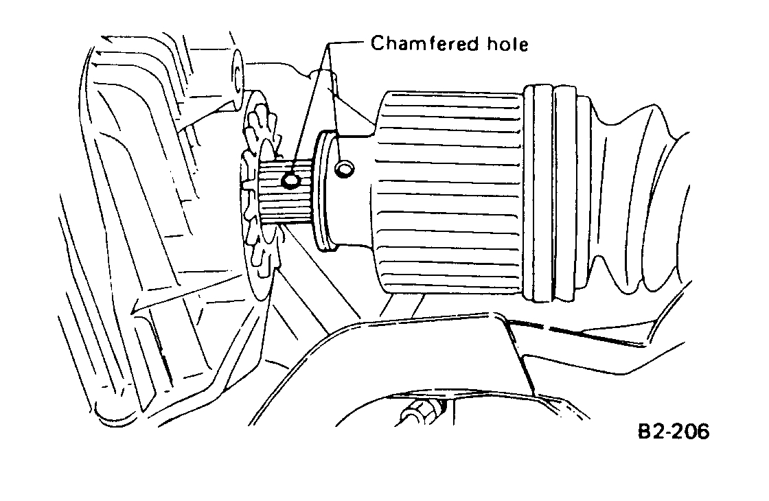

6. Install axle shaft to axle drive shaft and drive a new spring pin into place.
Caution: Be sure to align the two shafts at the chamfered holes and engage shaft splines.

9. Tighten nut which holds cable to brackets and connect cable to select lever.

22. Connect the following harness connectors:
- Transmission ground terminal
- Transmission harness connectors
