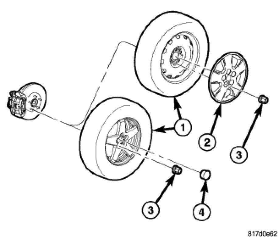

I ordered the wheel bearing for my car and they sent me wheel bearing for a 200. so I was wondering if I can still use them?

I looked up part numbers for both the front and rear and for both years. (I don't know which you are replacing) They are different numbers, so with that in mind, I would say it isn't the same.
Once you get that straightened out with the store, here are the directions. First, here is a link that shows how in general one is replaced:
https://www.2carpros.com/articles/bearing-hub-replacement
Here are the directions specific to your vehicle for both the front and rear. The attached pictures correlate with the directions.

1. Raise and support the vehicle. See: Maintenance
pic 1
2. Remove the wheel mounting nuts (3), then the tire and wheel assembly (1).

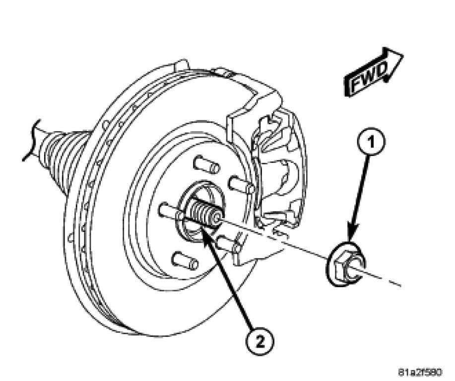

pic 2
3. While a helper applies the brakes to keep the hub from rotating, remove the hub nut (1) from the axle half shaft (2).
4. Access and remove the front brake rotor. See: Brake Rotor/Disc > Removal and Replacement > Brake Rotor - Removal

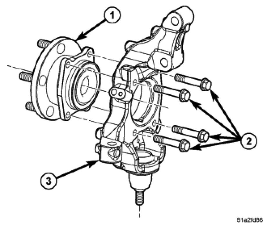

pic 3
5. Remove the four bolts (2) fastening the hub and bearing to the knuckle (3).
6. Slide the hub and bearing (1) off the half shaft and out of the knuckle.

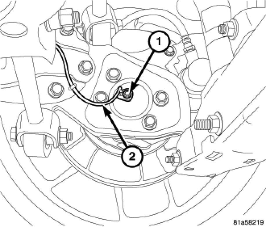

pic 8
5. Remove the screw (1) fastening the wheel speed sensor (2) head in the rear of the hub and bearing.

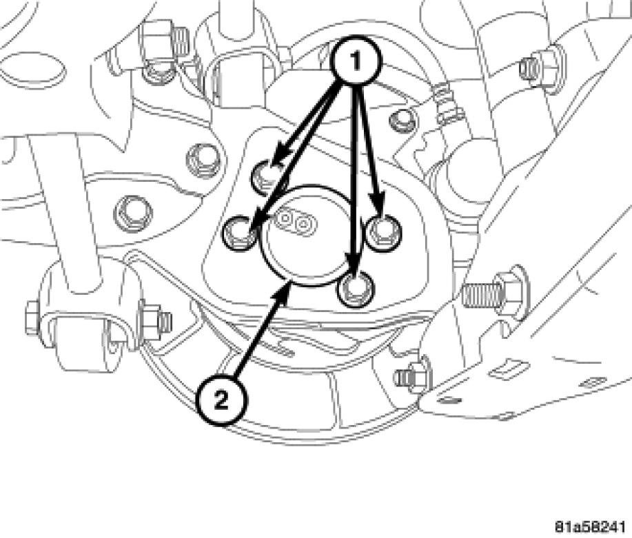

pic 9
6. Remove the four bolts (1) securing the hub and bearing (2) to the knuckle.
7. Remove the hub and bearing.
