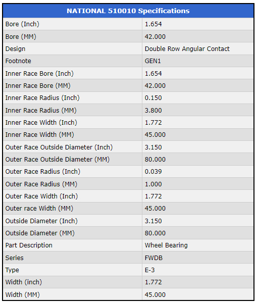

My car is in serious need of front wheel bearings, and my problem is that I cannot afford them. So, I have a friend that's got totes full of different wheel bearings that he had when he ran his mechanic shop. So, he said if I could find out the size dimensions of bearing; the inside diameter and outer diameter and width of it. And/or a list of vehicles that the bearings are interchangeable with the car listed above SE. Please help!!
Thanks in advance,
Olivia
Jul 19, 2022 at 7:23 PM
  • 110,194 POSTS

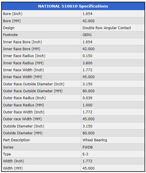

Hi Olivia, if this is front-wheel drive and not all-wheel drive, the original equipment part number is, Ford 3M8Z-1215-A.
I looked up the info and found what is listed in the pic below. That provides every dimension relevant.
You can have him look up the part number above or National bearing part number 510010.
Let me know if this helps. Also, let me know if you plan to do this yourself. You will need a bearing splitter and a press.
See pic below.
